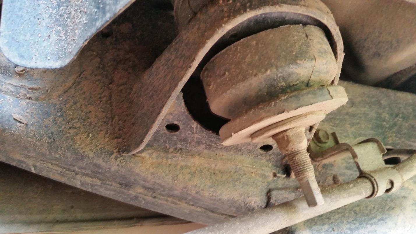

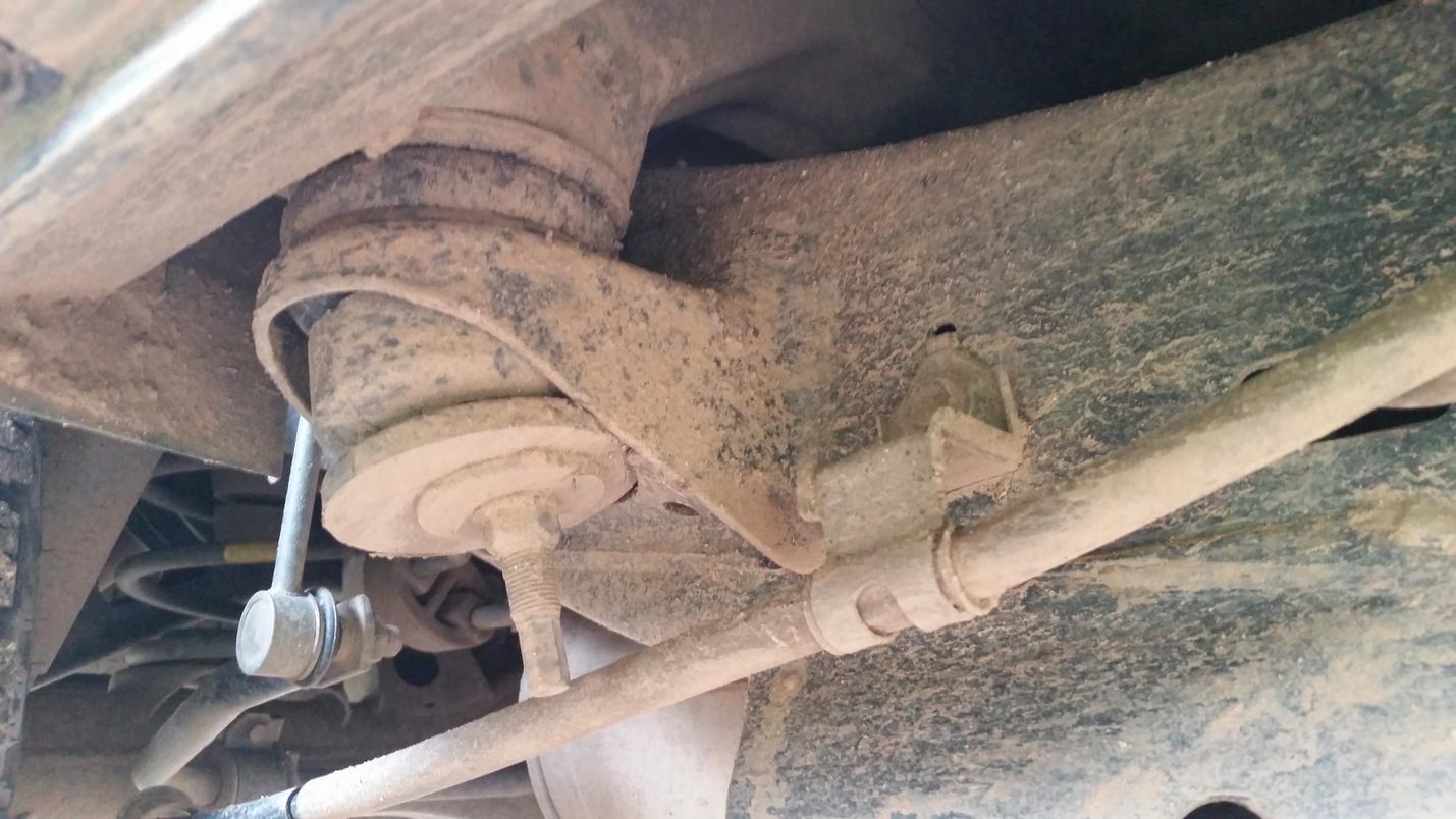

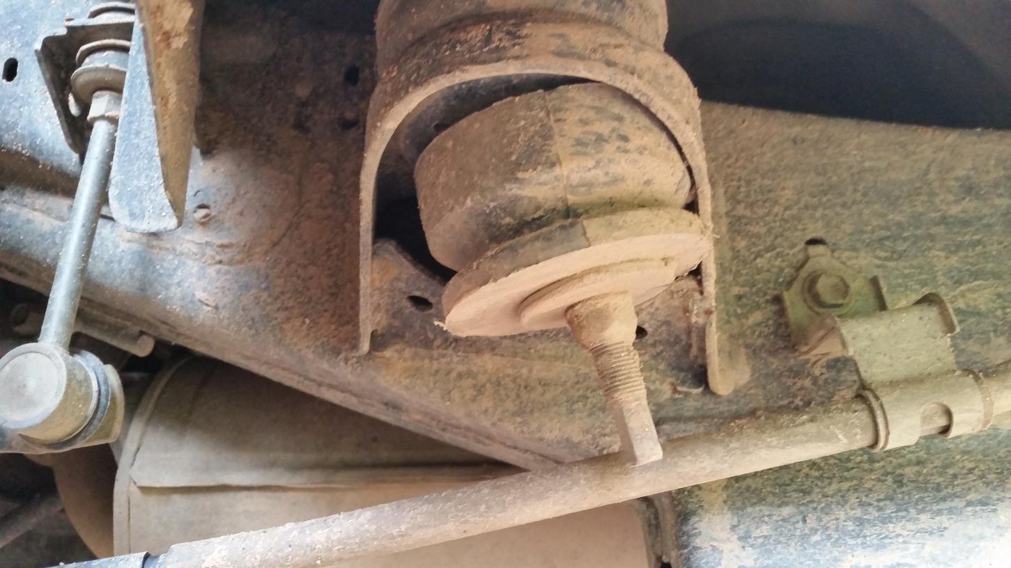

So, I have a fairly bent body mount bolt that makes noise when the side it's on is unweighted. I can share the story on how this is the only damaged mount, but I'll spare it for now until there's interest.
It is located passenger side, in front of the rear wheel well. The meat of my question is this: How easy is it to replace and how do I access the top of the bolt?
I've already done a timing belt job myself, so nothing is really out of the question on what I can do on the Runner. I'm being a little lazy and haven't looked inside the cab yet to see what I may be able to access.
2003 V8

Holy, ive never seen that before. I am definitely interested in how. :snacker:
I installed my Body lift and its super easy. Just follow the bolts up and you will find the top bolt. Some have a rubber cap over the hole that just pops out.
If I remember correctly, to access that bolt, you fold the seat forward, pull back the carpet just a bit, and you'll see the black rubber cap there. You MAY need to pop off the trim piece as well. Can't remember exactly. Nonetheless, super easy.
Thanks for the help. I figured it wouldn't be too difficult.
