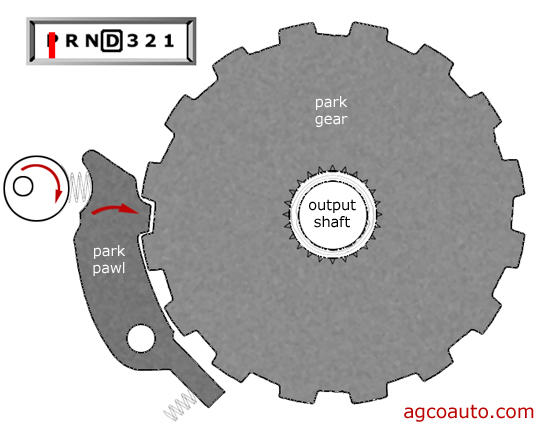

*And the big one. You would think that since the trans is locking the driveshaft from spinning you might think that the vehicle can't roll. Wrong! Because the rear diff is open, if one tire is on something slick like ice, the tire on ice will spin backward as the tire on on the dry will roll without resistance and the vehicle will roll downhill with ease. I have seen this happen a few times. Once in my driveway and into the street and another about 1/4 mile down the road and into a ditch.
USE YOUR PARKING BRAKE!
If you drive an automatic, why are you using your e-brake anyways?
The "parking pawl" in the transmission should "Never" be your sole means of making sure the vehicle is secure..
Just look at the picture, I'm sure you wouldn't like to trust "just the Pawl" in the slot of the cog to hold your vehicle. I know they do hold, but having pulled that ebrake before you put it into park is the correct thing to do. Even in the owners manual says to when parking on a hill, pull the ebrake first then put into park. So almost all the stress is on the rear brakes.
