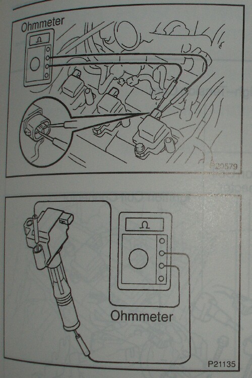

Did you test the coil that has the bad boot to see if it's within spec? The coil might be the reason the boot went bad. This happened to me last year. I can give you the test specs if you want.

Anyways, what are those specs for the coil. I guess i'll check that now just to see...
PRIMARY COIL RESISTANCE. Using an ohmmeter, measure the resistance between the postive (+) and negative (-) terminals where the connector plug into the coil pack.
Cold 0.67 - 1.05 ohms
Hot 0.85 - 1.23 ohms
SECONDARY COIL RESISTANCE. Measure the resistance between the positive (+) and high tension terminals.
Cold 9.3 - 16.0 ohms
Hot 11.7 - 18.8 ohms
If resistance is not as specified then the coil needs to be replaced.
