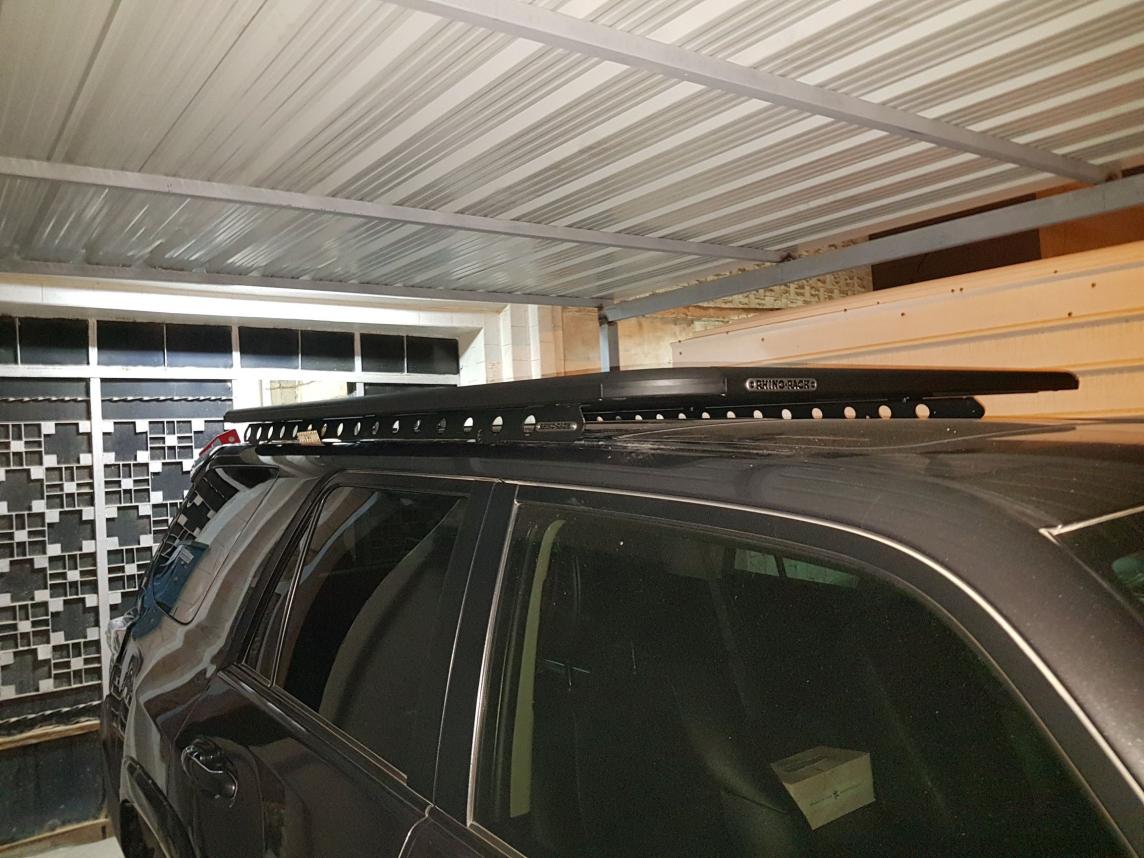

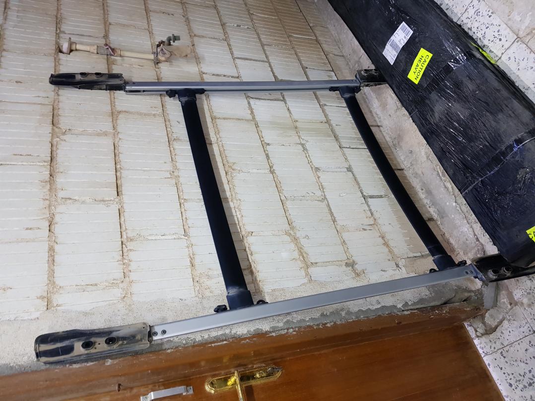

Another round of updates coming up.

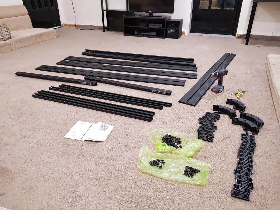

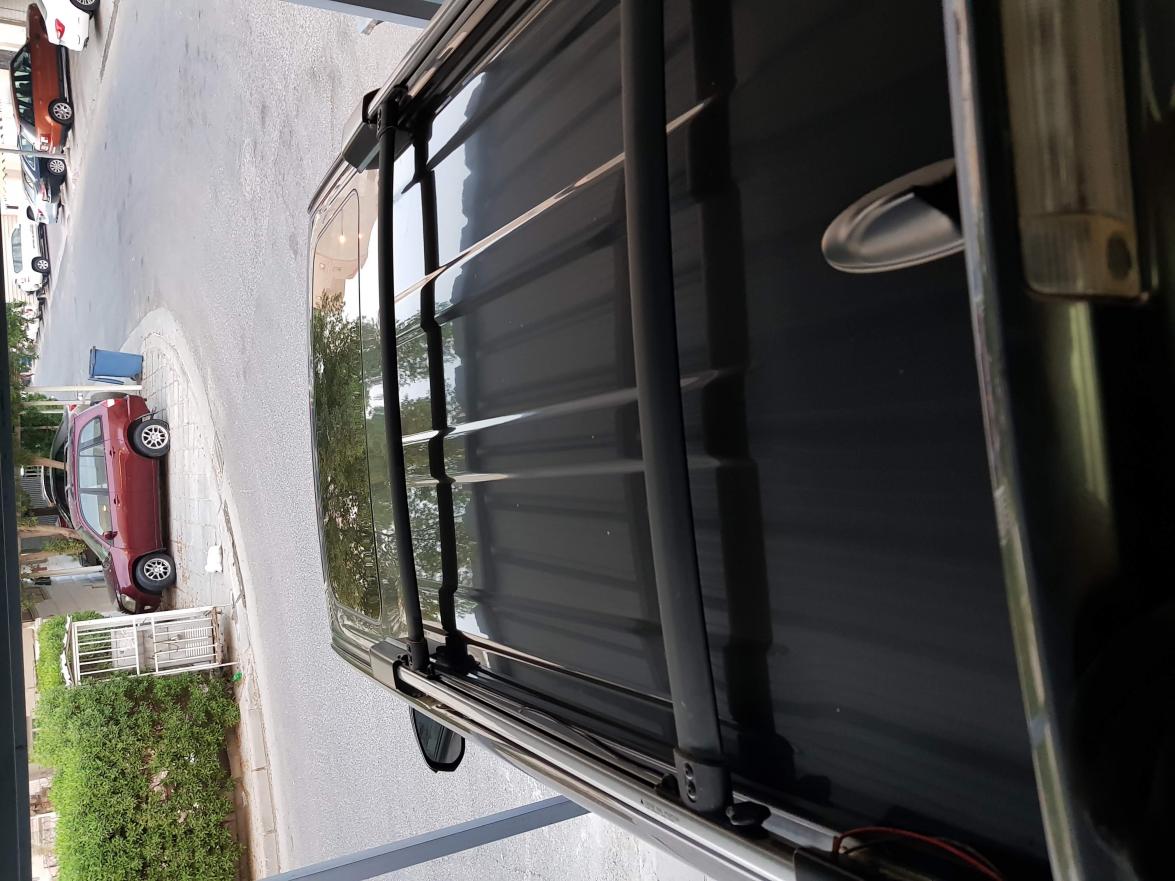

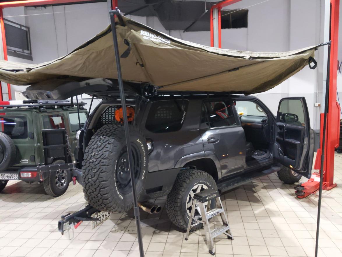

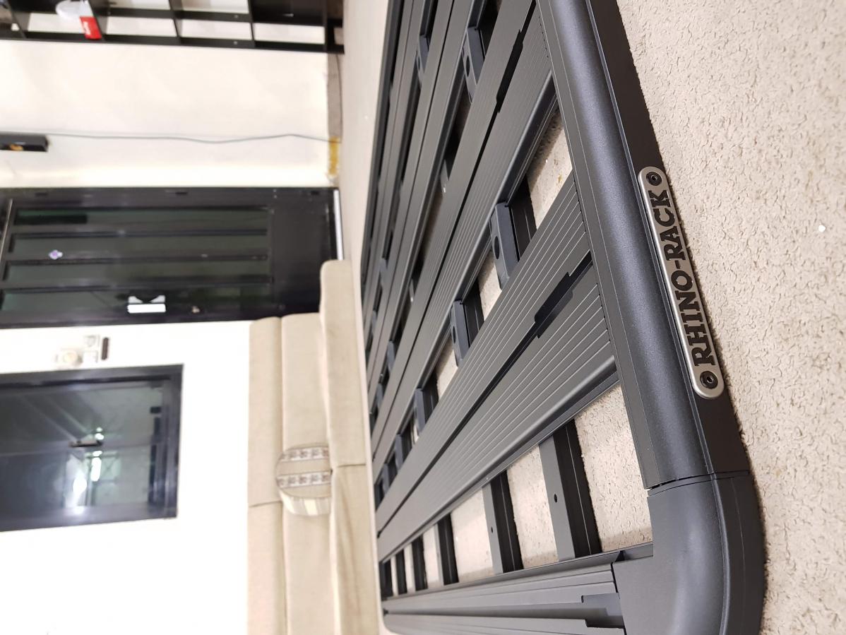

Removed the OEM roof bars, and installed the Rhino Rack backbone + tray along with the batwing. Pics below of course
Parts:
42102BF Rhino-Rack Pioneer Platform 76x49 Inches
RT4B1 Rhino-Rack Backbone Mounting System
33400 - Batwing Compact Awning - 6.5ft - Passenger Side Mount

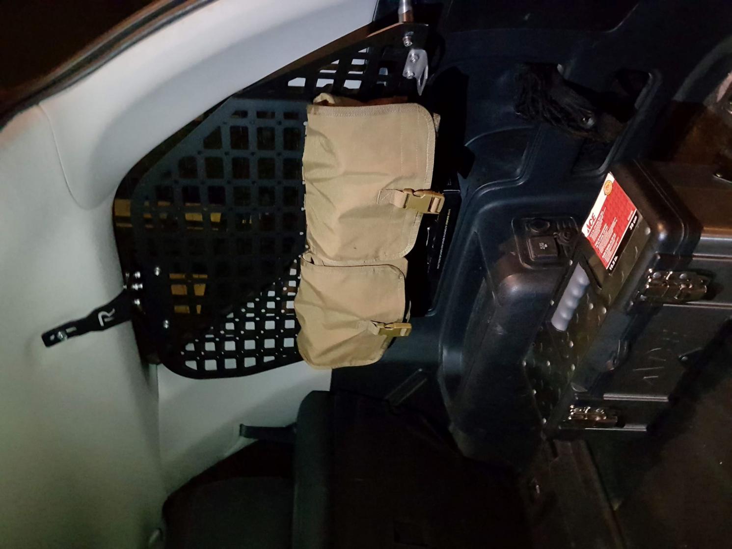

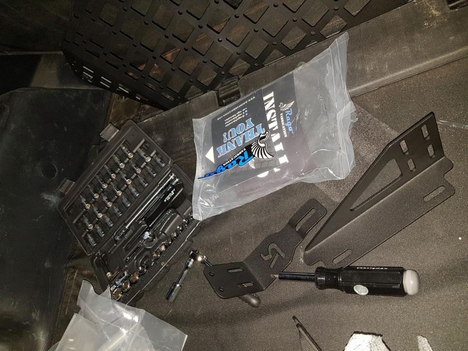

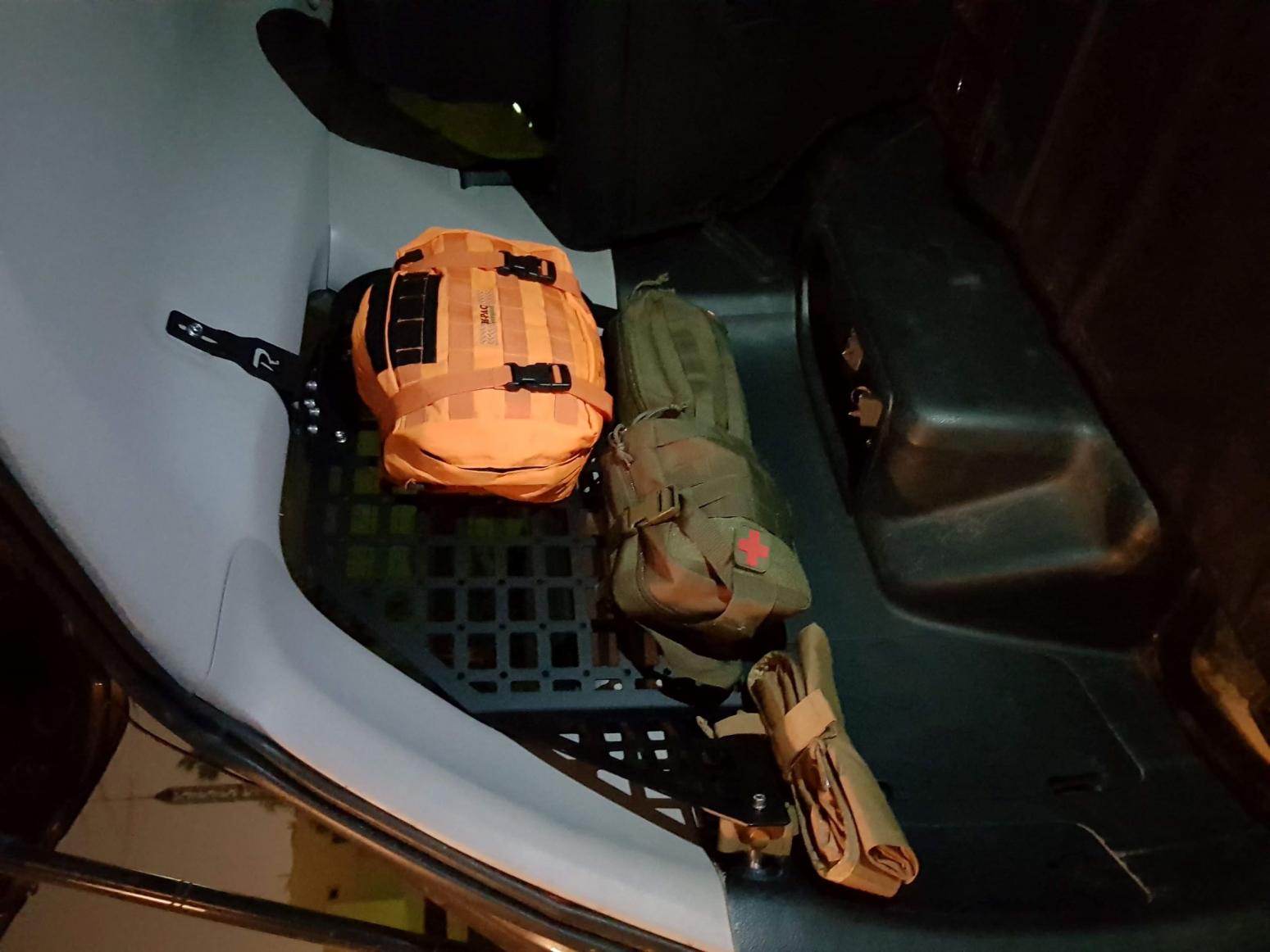

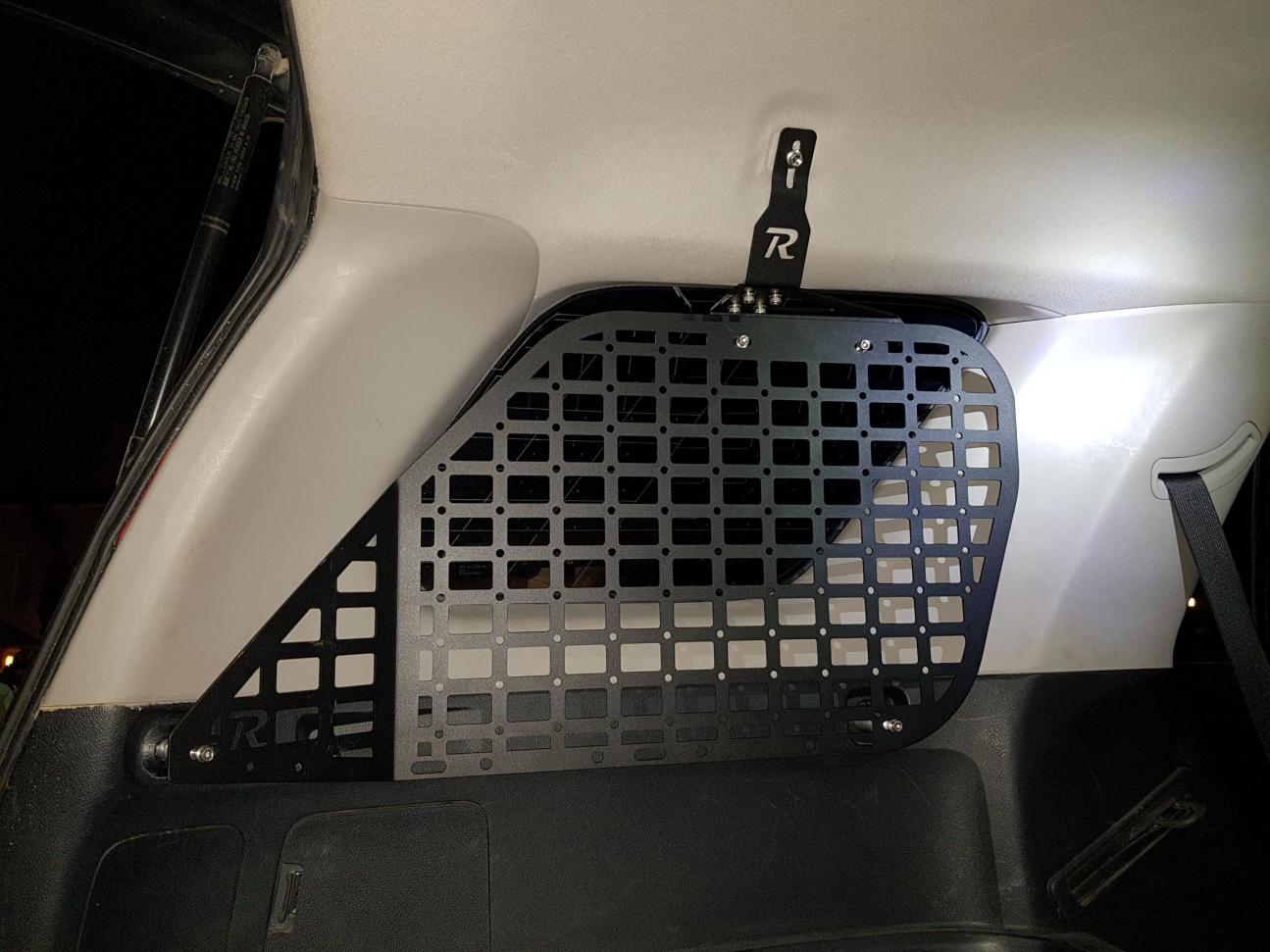

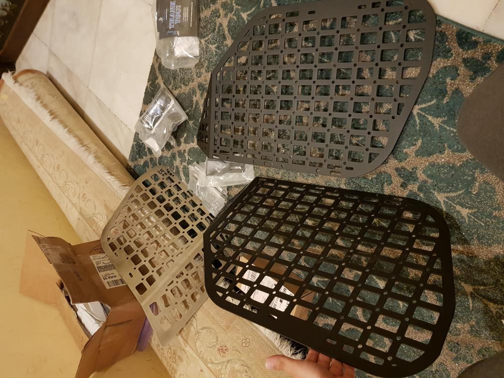

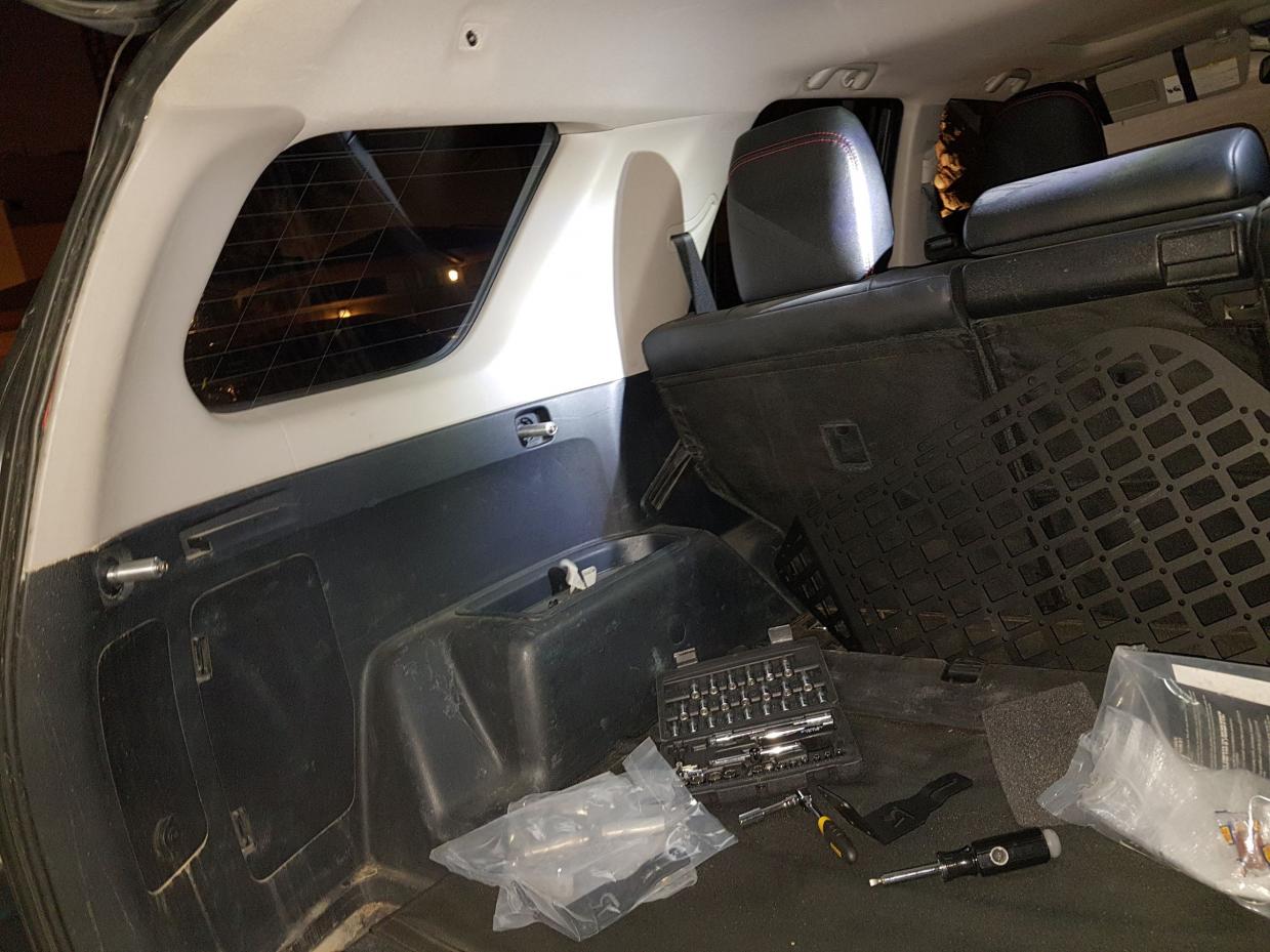

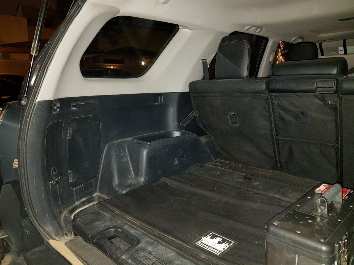

4Runner Modular Storage Panel System
Ordered a set of the 4Runner Modular Storage Panel System, powder coated, and another in plain metal for a friend's FJ
Install was pretty straight forward. Brackets and hardware were included, and everything bolts right up without issue. There's some adjustability in terms of how you want the panel aligned. The bolt on Bottle opener was a nice touch as well!
I also put in a couple of MOLLE bags which I bought from eBay. Finally organized the tools, shackles, and my ARB recovery strap and other gear that was previously just all over the place.
