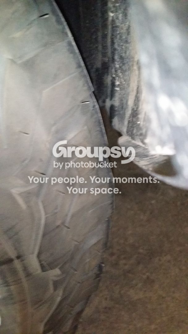

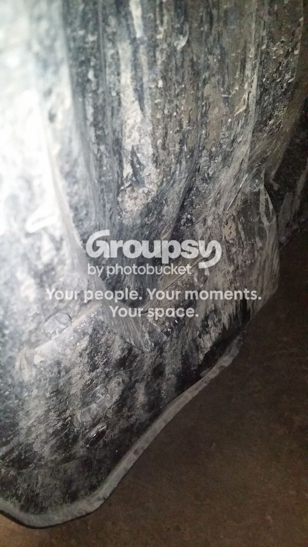

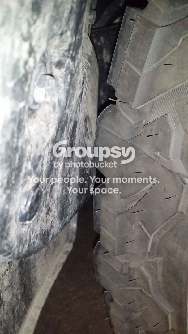

Here's some pics:
Point of rub (at ~80% wheel lock)

Tire rubber residue at lower inner raised side of mud guard
20150719_141219.jpg~original

It probably does drive "fine." But most folks here are a bit OCD about their vehicle. I'm equally concerned about full "droop" with KDSS and different coilovers, and I don't have a shop around here I really trust. So, I keep researching... It makes me just want to go Icon Stage 2 and not worry about it. Until I look at the price tag...
Was honestly concerned with this, but couldn't find any solid numbers on how much exactly does KDSS allow in extra articulation to check numbers.. Plus, the stock TOKICO's that came off the truck are the same as the ones on non-KDSS T4Rs AFAIK (except the Limited's XREAS thing), not some sort of 'extra travel' types. So if those worked fine, so should these. That and the 5160s are good for 2" lift, so at stock height it should still have some 'down travel' room. For fronts, It doesn't seem like KDSS adds any more down travel to the IFS setup, but rather only disengages a jointed sway bar via the KDSS piston to let the suspension do its thing more freely on the bumpy stuff.
Finally, plenty of others who've done higher setups than mine w/KDSS still doing well out there.
At least, that's my view on this. Could be completely wrong. Will find out for sure if something pops and spills oil all over..

---- Update ----
Took it back for the rubbing issue, turns out it does indeed rub both on front bumper and rear mudguards... actually was bad enough to drag the bumper down a bit on the inside when tires were close to full turn.
Took a little bit off the front bumper (innermost edge) and zip tied the inner plastic part of the mudguard. All clear and lovely!
In summary: 1.25" wheel spacers will cause rubbing with this setup

Rubbing was because the spacers positioned the tire out enough so that within its turn radius it would touch the bump on the mudguard and inner part of the front bumper.. took the spacer off today due to fit and safety issues (see update below).
Spacers went on with the lift originally, so nothing to compare to previously.. however, since they're off today I didn't notice any difference in driving behavior from with the spacer installed.

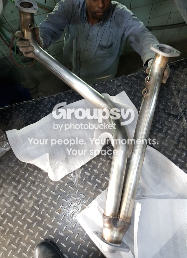

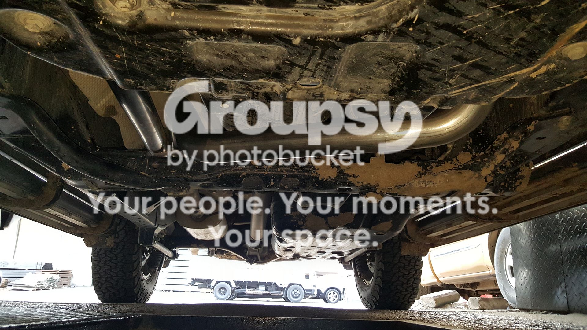

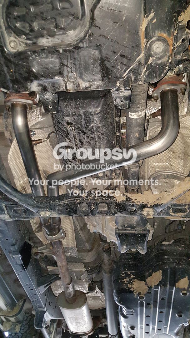

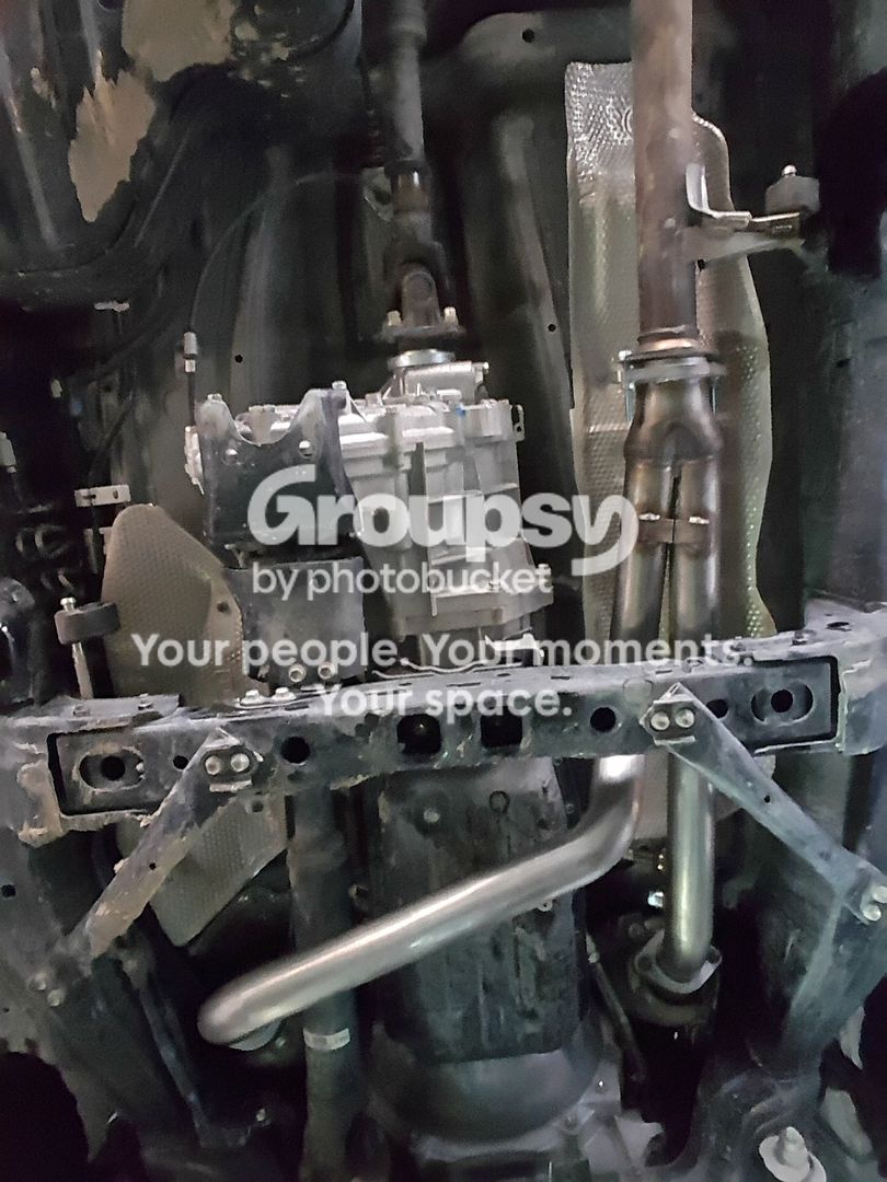

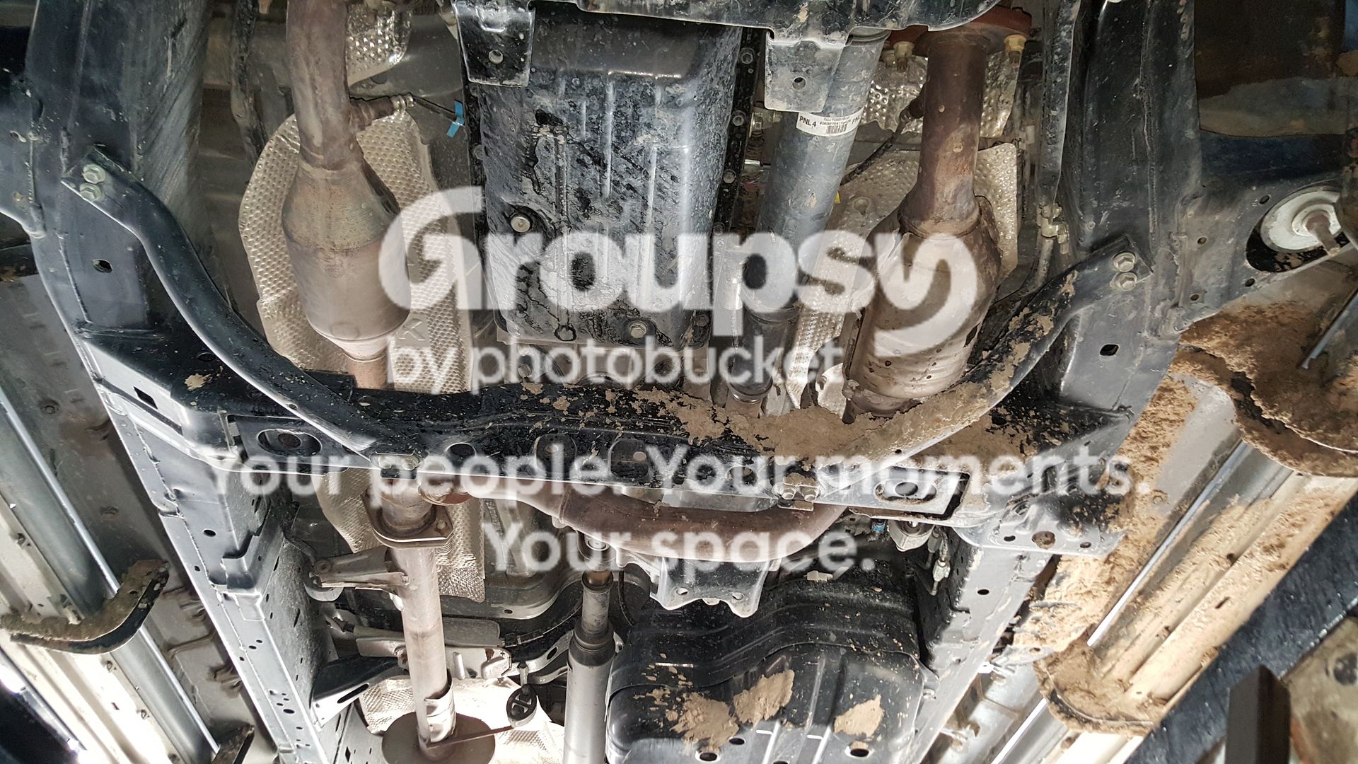

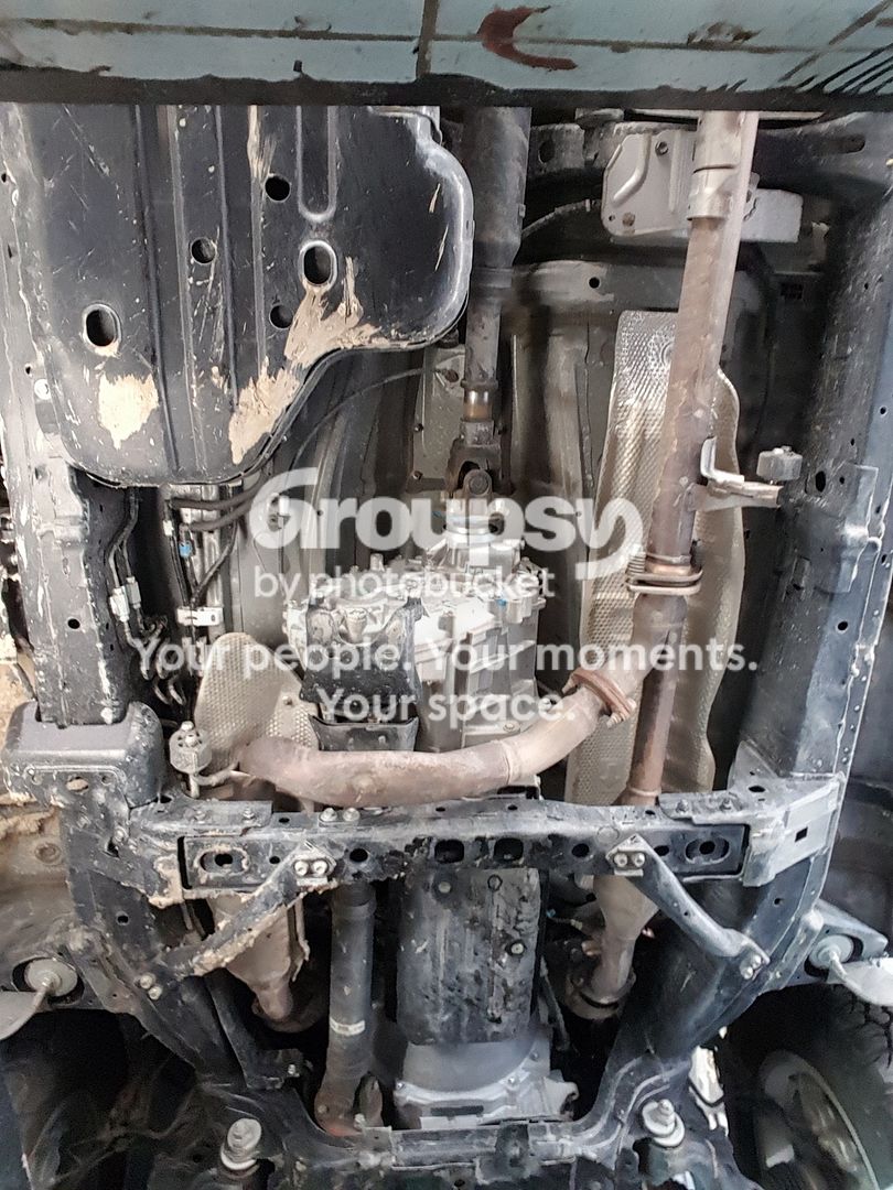

Alright its been a while since my last post so will share my latest:
Got these URD y-pipes:
URD's "Off-Road" Y Pipe for 2003+ 4Runner
Install notes:
Install took some work, as they didn't quite line up straight. Had to cut the welded bracket (3rd pic from below, that welded piece right before where the 2 pipes meet) to help 'loosen' up the pipes to fit the cats up front, and widen up the bolt holes a bit. Gaskets (+$9.99 extra) were top notch, and flanges sealed good. Overall, they were well constructed I would say.
After install notes:
These ultimately sit higher than the stock setup, and are no longer the lowest point of the vehicle.
Also, should promote better exhaust flow by getting rid of the pre-cats and less restrictive routing (i.e. larger and less bends). Was pleasantly surprised how they woke up that 18" Magnaflow!!
No CEL as of Day 1. Also feels it revs a bit more freely and runs better up top, but that could be entirely just from me gassing it all day..
Love them, but if I were to do it again I might just find a real good exhaust shop to custom make these instead of shipping them half way across the globe to try and make them fit.
