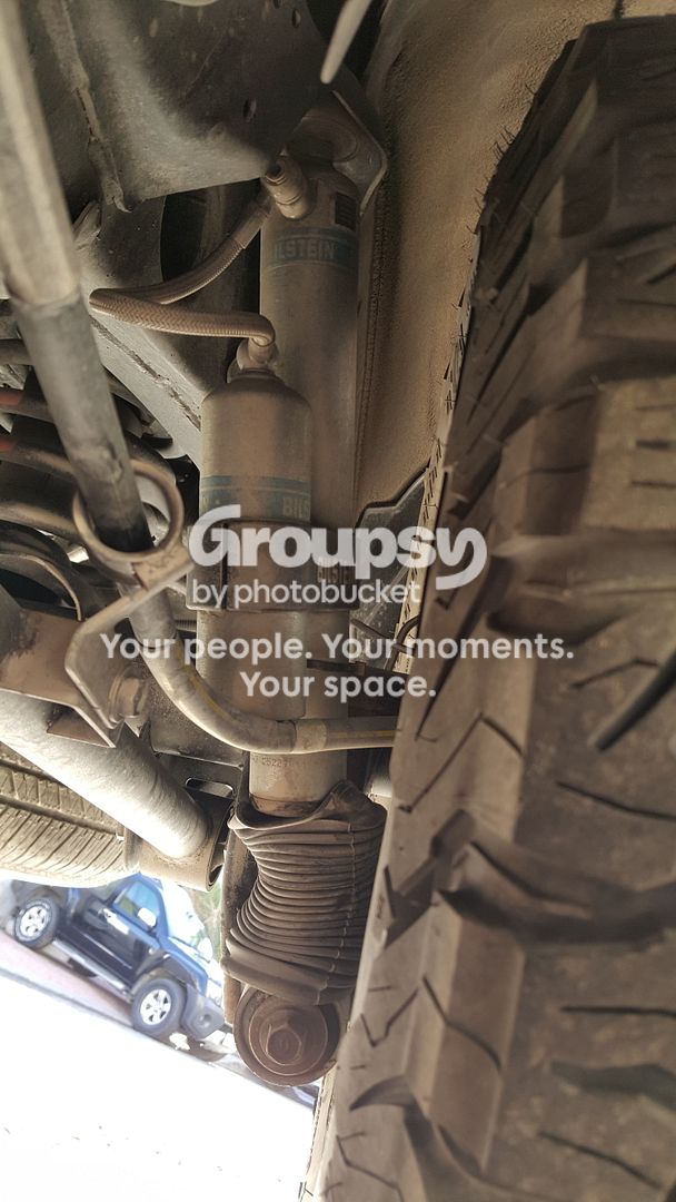

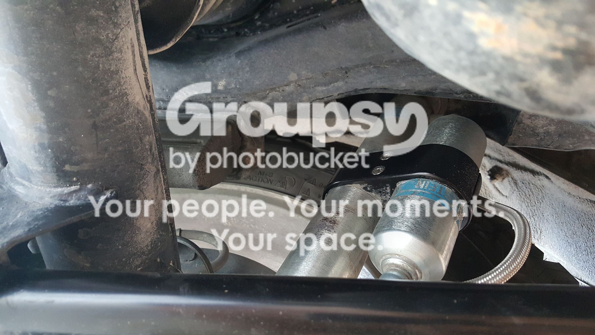

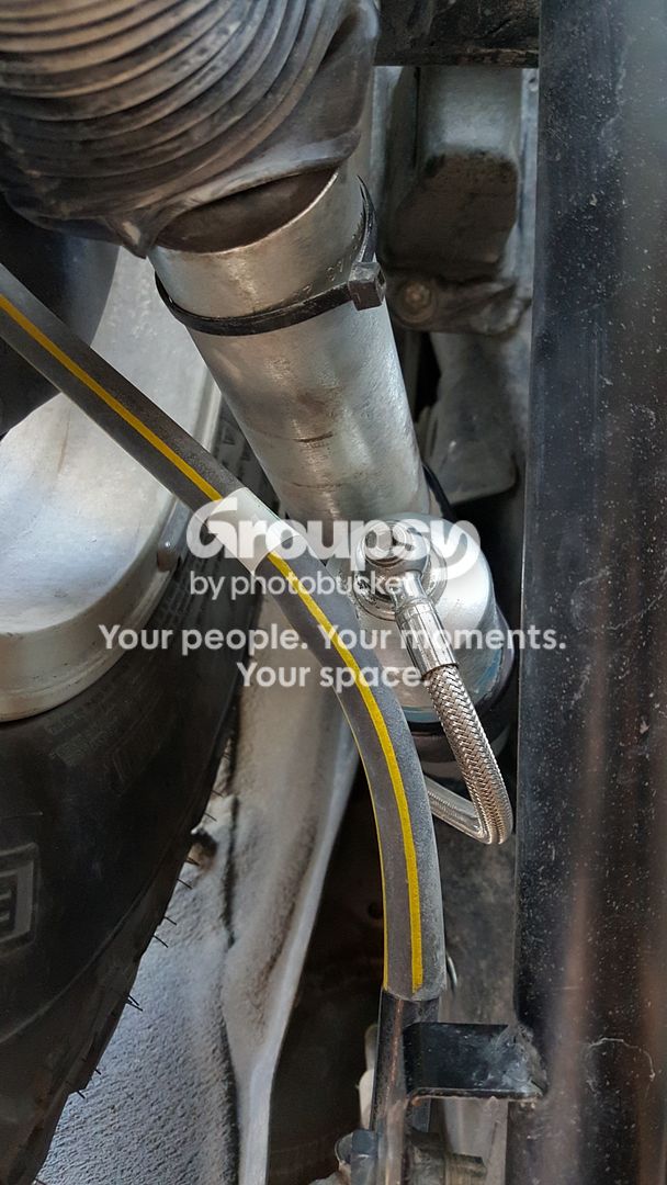

Not sure if you've taken your rig off road but I would be really careful with your reservoir placement. At full compression it looks like it could hit your emergency brake line.

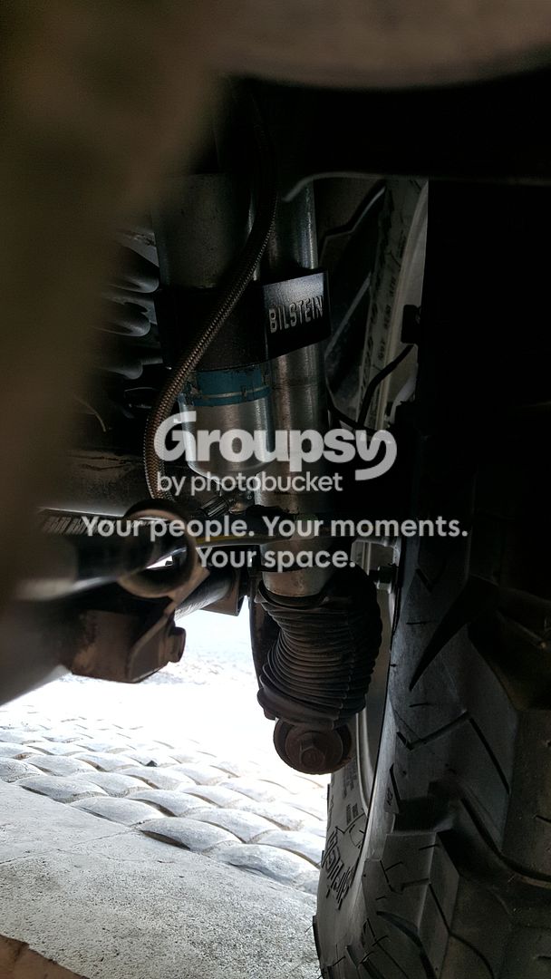

Good observation, and yes the reservoirs used to rub at full upswing.. actually dug into the rubber sheath of the brake line.. Might be a good excuse for switching to extended steel brake lines on the next job, which will include swapping the rear coils, rear SS bumper w/ tire carrier, and rear icon hydraulic bumpstops.
The easiest solution would have been to mount them somewhere high in the wheel well, but I ended up flipping them and rotating them inwards to avoid contact. So far it seems to work good.
Before pic:
Taken during uptravel, there's contact
20160131_152249.jpg~original
After pics:
On uptravel, no contact
20160131_163350.jpg~original
On uptravel still has enough room to go before contact
20160131_163308.jpg~original
P.S. For those doing this as well, when moving the reservoirs higher on the shock body, keep in mind the top of the shock rubber mount flexes a bit during shock travel and if not given enough room between the rezzy and upper frame/ body there will be contact there as well.
20160131_163317.jpg~original

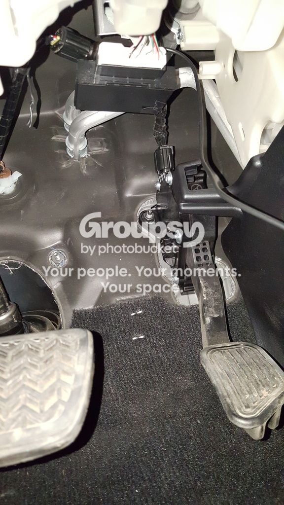

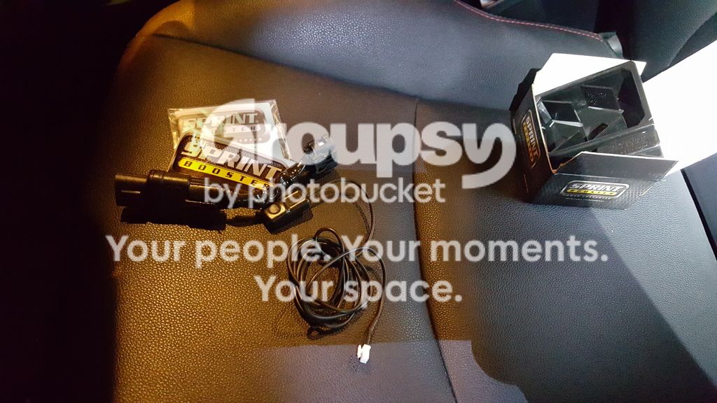

Install pics and Notes:
Box of snake oil:
20160530_234025.jpg~original
Snake oil, unboxed. Two most important bits are the short dongle with 2 connections, and the tiny remote with the long wire that connects to the dongle. 3 settings possible: Remote light off (stock response) Green Light: 1st setting up (What I'm running). Red Light: 2nd setting up (Most aggressive throttle response).
20160530_212702.jpg~original

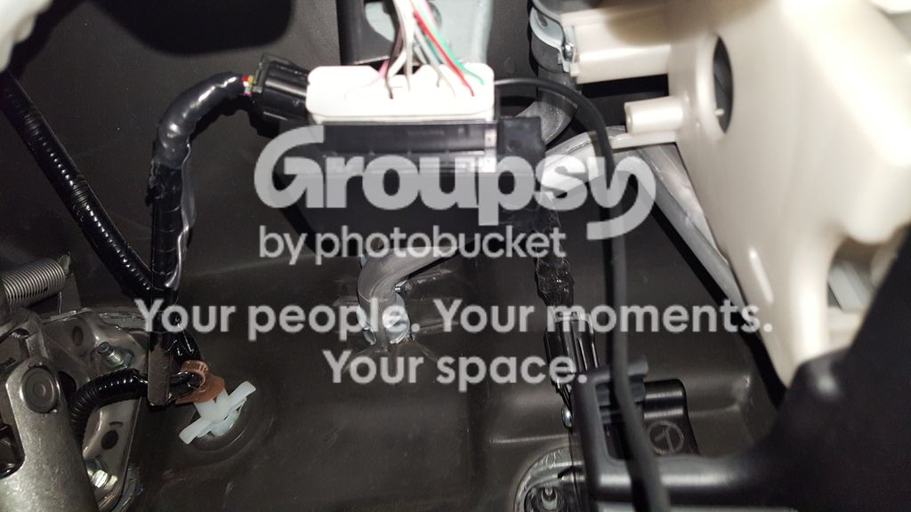

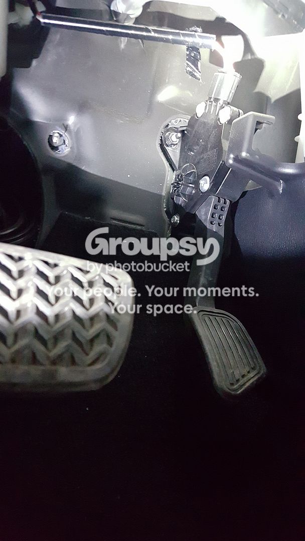

(pre-install) OEM throttle wire above the skinny pedal needs to be removed first:
20160530_212732.jpg~original
After install, routed the short Sprint Booster wiring and original throttle wire above the OBDII port connector. Note that the metal piping above does get hot and could burn exposed wires if it touches. Taped up the OEM wire for a bit more heat shielding before taping everything down to the OBDII port and away from the metal piping up top.
20160530_215534.jpg~original
How it looks after assembly. Will come back in with a zip tie just in case the heat loosens up the tape. Tends to happen around here quite a bit.
20160530_215545.jpg~original

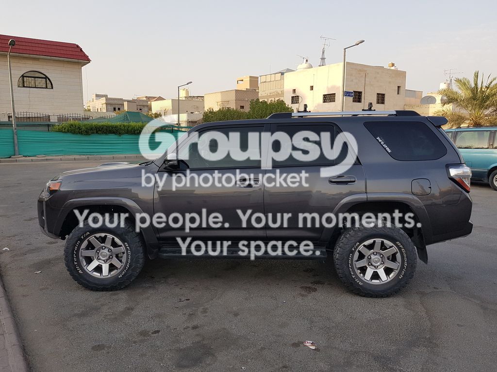

Rubbing was because the spacers positioned the tire out enough so that within its turn radius it would touch the bump on the mudguard and inner part of the front bumper.. took the spacer off today due to fit and safety issues (see update below).
Spacers went on with the lift originally, so nothing to compare to previously.. however, since they're off today I didn't notice any difference in driving behavior from with the spacer installed.

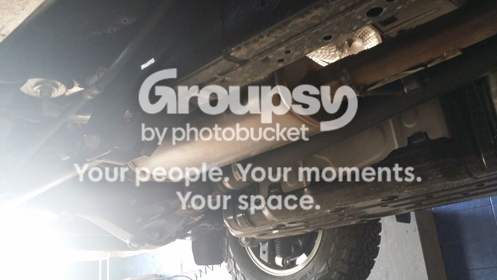

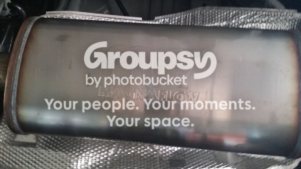

Installed the Magnaflow 18" (#12255) and man it sounds sweet! Nothing noticeable at ide, deep nice rumble at 1.5k RPM to 2.5k RPM and keeps sounding sweet WOT to redline without any raspiness!
You could go louder with a 14", might be a bit more raspy I would guess.. But I'm no muffler expert. IMO the 18" is the perfect balance of daily comfort (no droning) and smile-to-gas-pedal entertainment.
20150729_093506.jpg~original
20150729_093520.jpg~original
20150729_093548.jpg~original

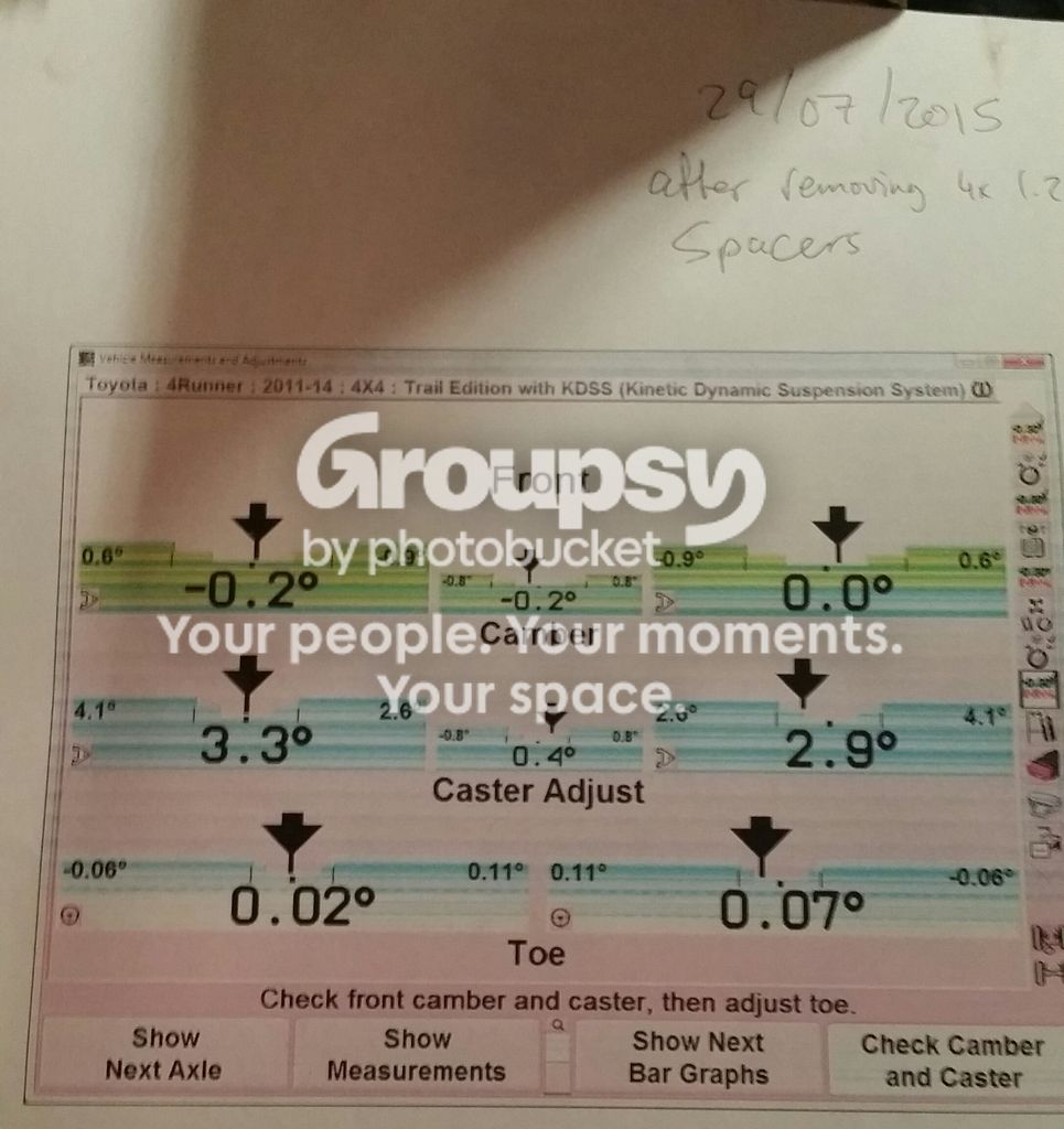

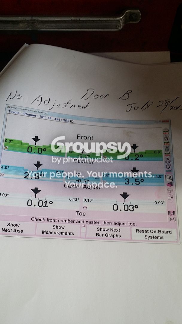

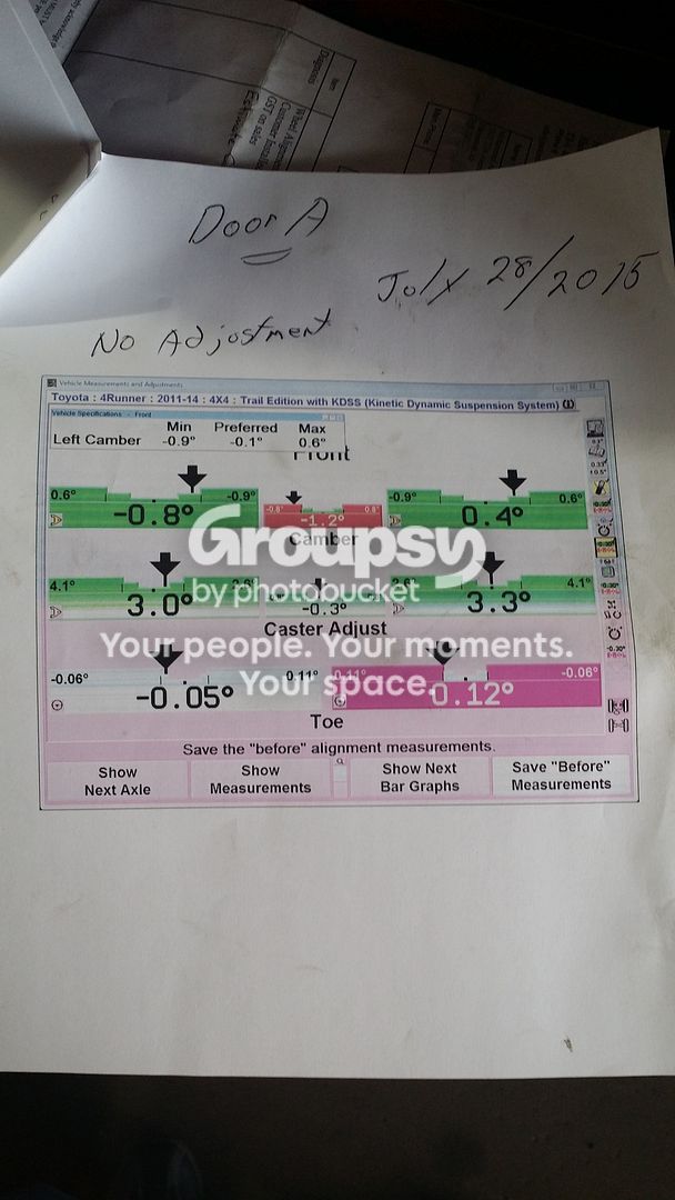

Also got an alignment done.. turned out it really needed one. So you guys were right. [MENTION=125788]msp[/MENTION] [MENTION=103267]Saker[/MENTION] [MENTION=81322]barryhiram[/MENTION]
Numbers before alignment (or could have been after 1st round, guy was bad with paperwork):
20150729_100458.jpg~original
Numbers after 1st alignment:
20150729_100711.jpg~original

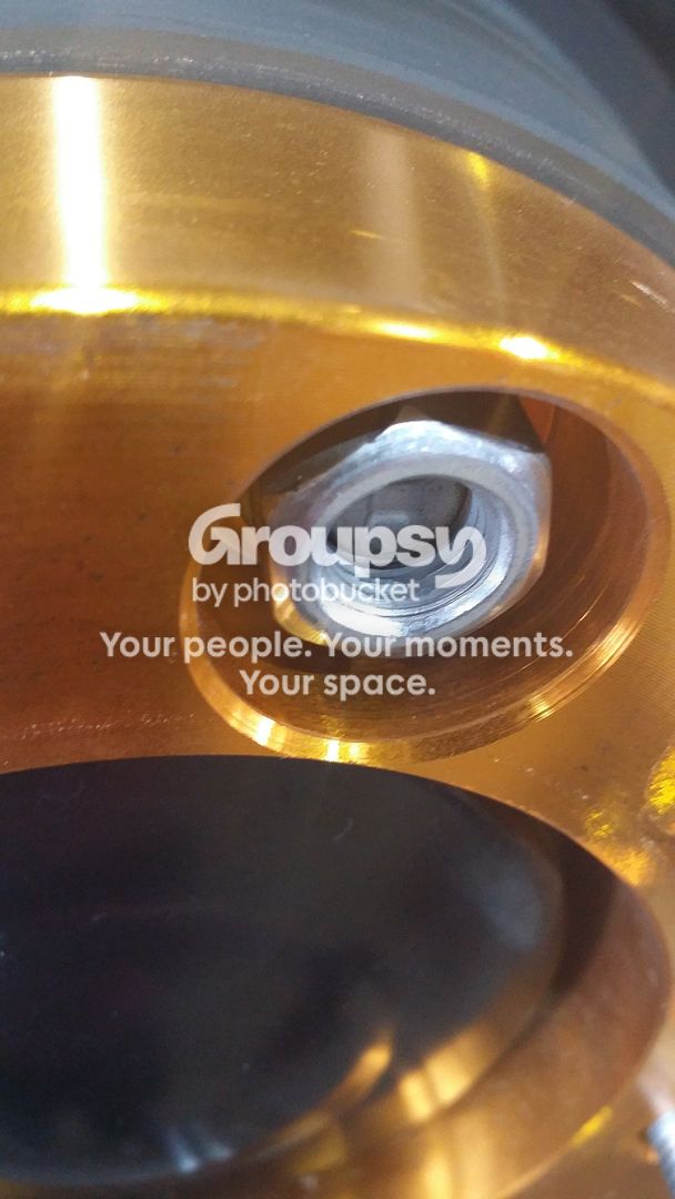

Also did a tire balance while I was there and saw this with the front spacers!
20150729_104419.jpg~original
20150729_104425.jpg~original
Yep got lucky nothing came off... Those nuts were literally holding on to just a few threads of the OEM studs!! A reminder on why its good to keep an eye on the install work rather than dropping off your car at a (supposedly reputable) garage and having faith that someone else will do a good job for you.. And the value of a truly honest shop. Irony is I even took it back for re-torqueing but was busy chatting with the shop owner on LED's and didn't actually see them working on the spacers. However, rears were on fine as the OEM studs in the back were a bit longer than the front.
My mistake, fooled twice, lesson learned.

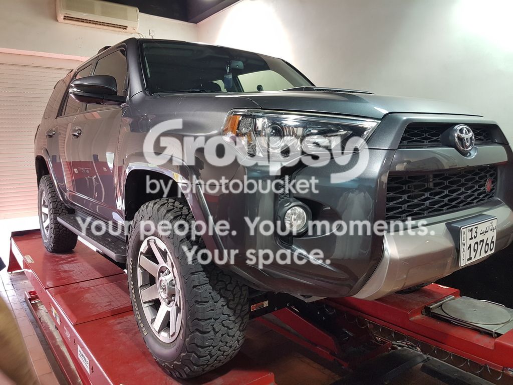

I've taken the spacers off and returned to the original garage that sold/ installed it for me for a full refund. Don't think they'll be seeing me around anytime soon.
After the original alignment (with spacers) everything was in spec but not perfect.. maxed out on the passenger tire camber adjustment bolt. Took it for the ride home and realized it tends to steer left on the road
After removing spacers, a complete re-alignment was done and I've asked him set it to go a bit more towards the right to compensate the left turn tendency. This is the best they could do with stock UCA's:
20150729_184653-1.jpg~original
Also drives much better on the highway now, and I blamed the poor KO2s thinking it was their fault for the shaky ride! You would think the dealership would balance the tires they installed upon delivery of a brand new 4Runner.. Ahh well, end of the day it's my fault for assuming too much I guess.
Anyways, it drives super nice now. Still has a verrrryyy slight pull to left when steering wheel is centered. Alignment guy says that's the best he can do and this time I was there all 6 hours watching him try. Also no signs of tire rub obviously as I'm back to stock hubs with the spacers gone.
I'm happy with the setup and drive now, but definitely learned 3 things:
1- 6112/5160 on 2nd notch is at the limit of what stock UCA's can handle for alignments sake.
2- Aftermarket UCA's the way to go for easier adjustment, and definitely a must for higher lift setups
3- Finding a quality shop is more important than finding quality parts! (unless your good enough to do a fine job yourself)

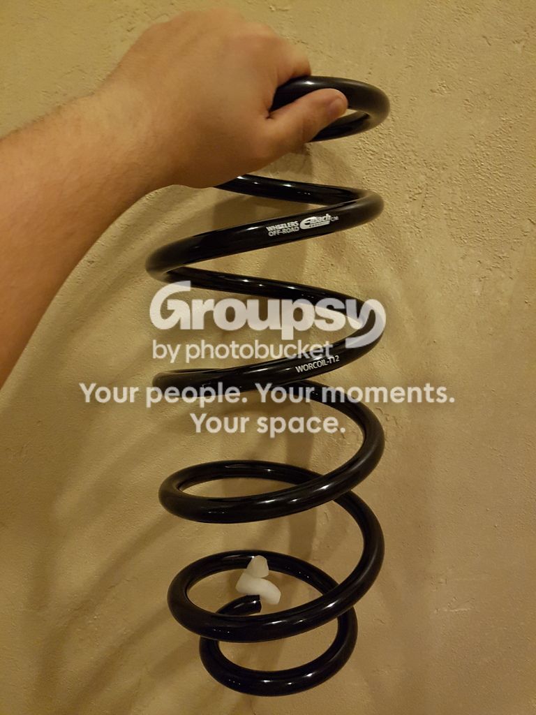

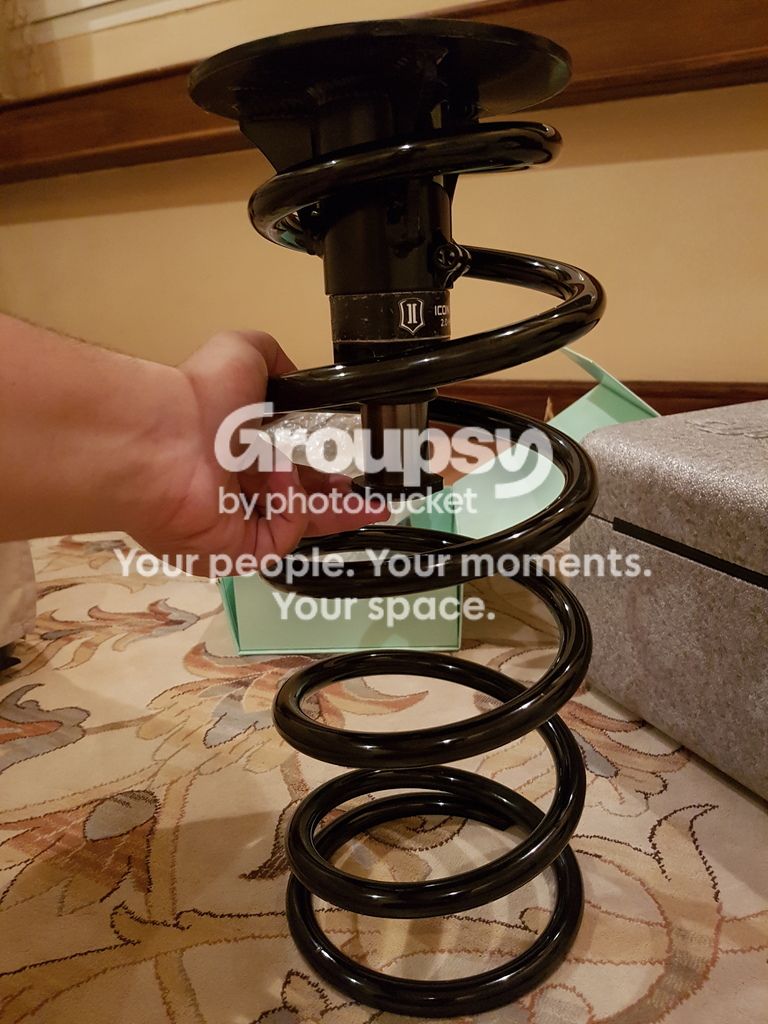

Wheeler's T12 rear coils (i.e. Wheeler's version of the Sway-a-way 1.5" rear coils... both made by eibach)
20160816_200307.jpg~original

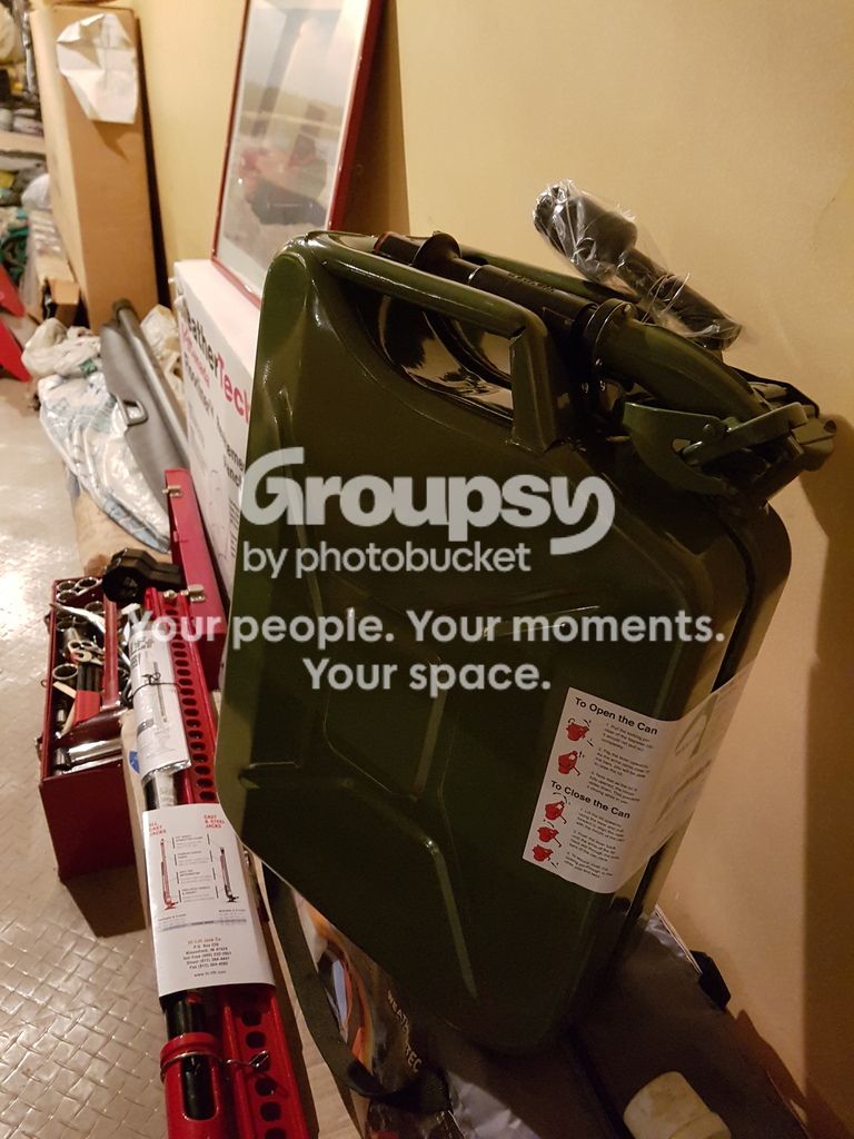

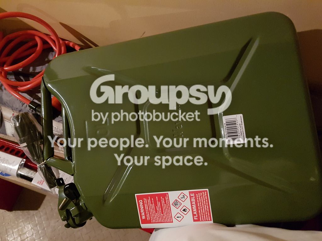

WAVIAN 20L cans.. seem sturdy. Hope they hold up in the sun
20160816_195728.jpg~original

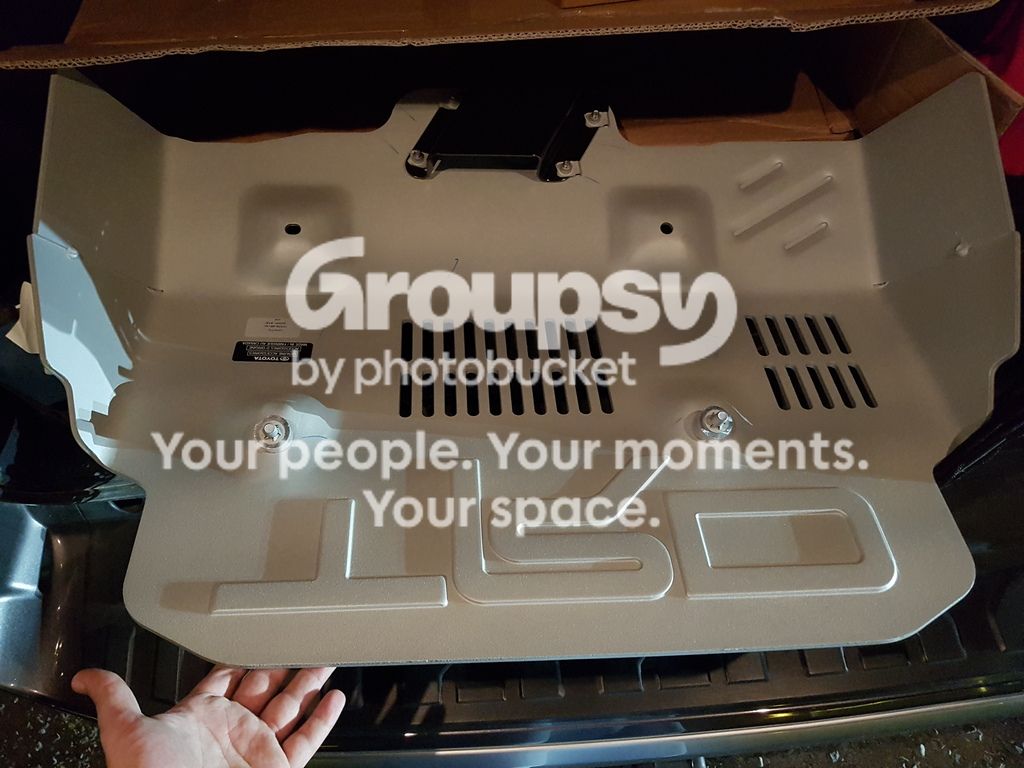

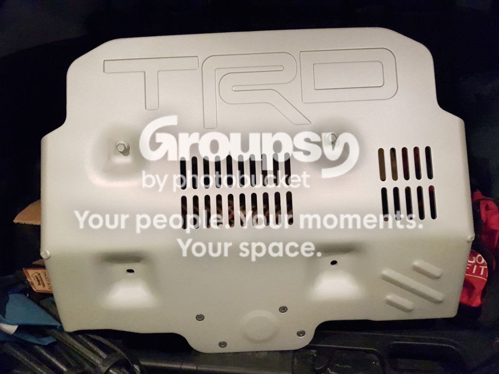

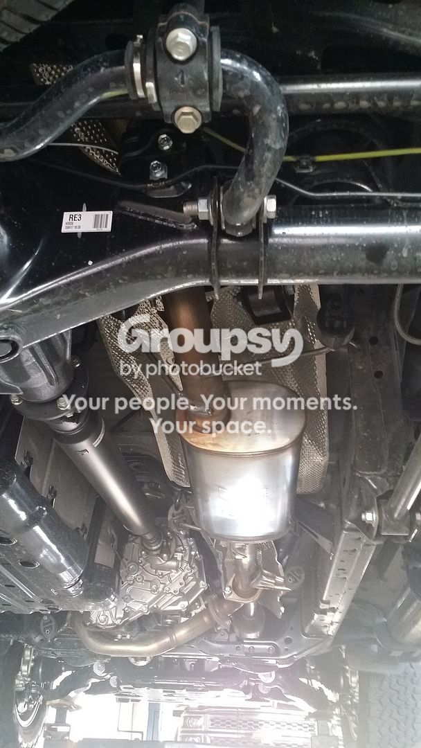

TRD skid plates.. still need to be cut to make way for KDSS sway bar
20160816_203634.jpg~original
As clean as they'll ever be
20160816_203659.jpg~original
Side shot
20160816_203725.jpg~original

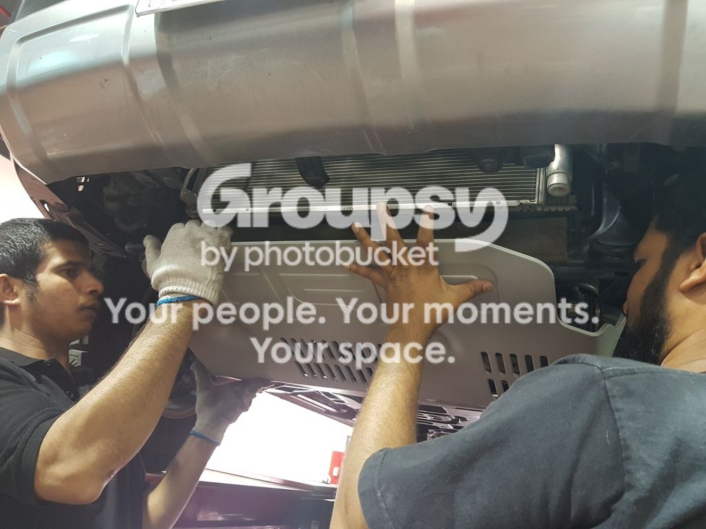

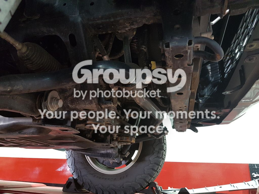

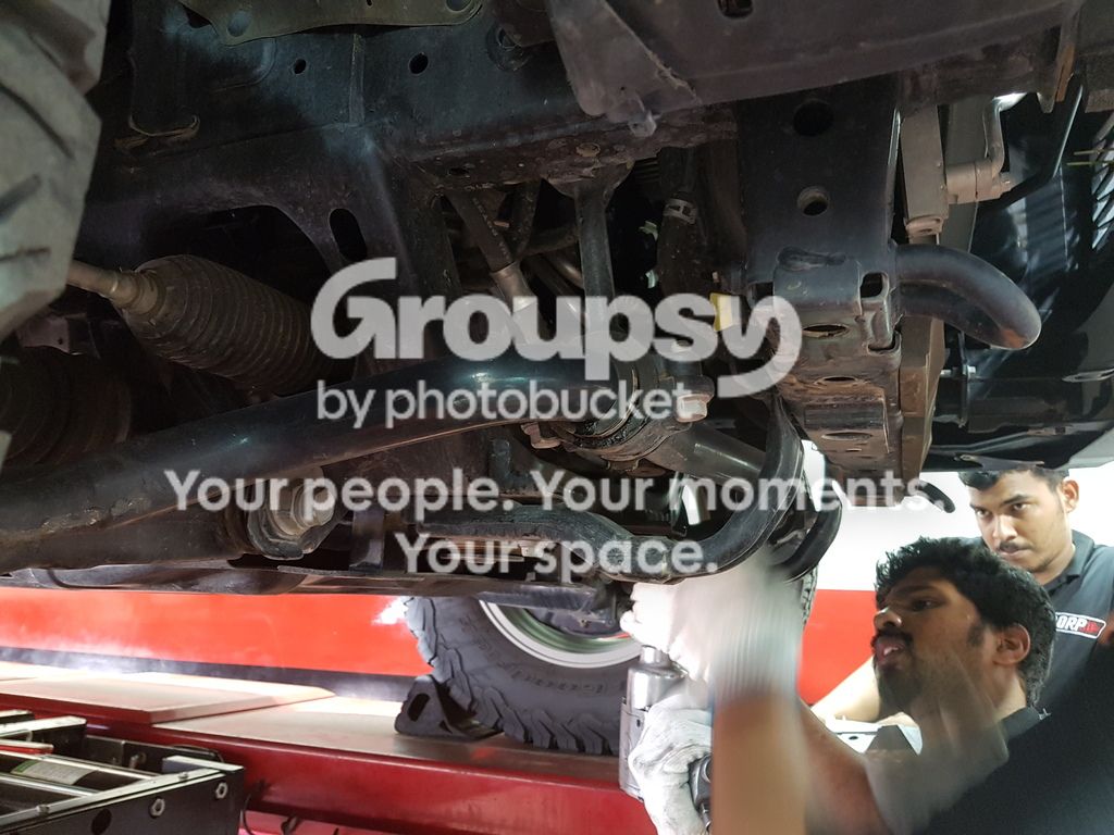

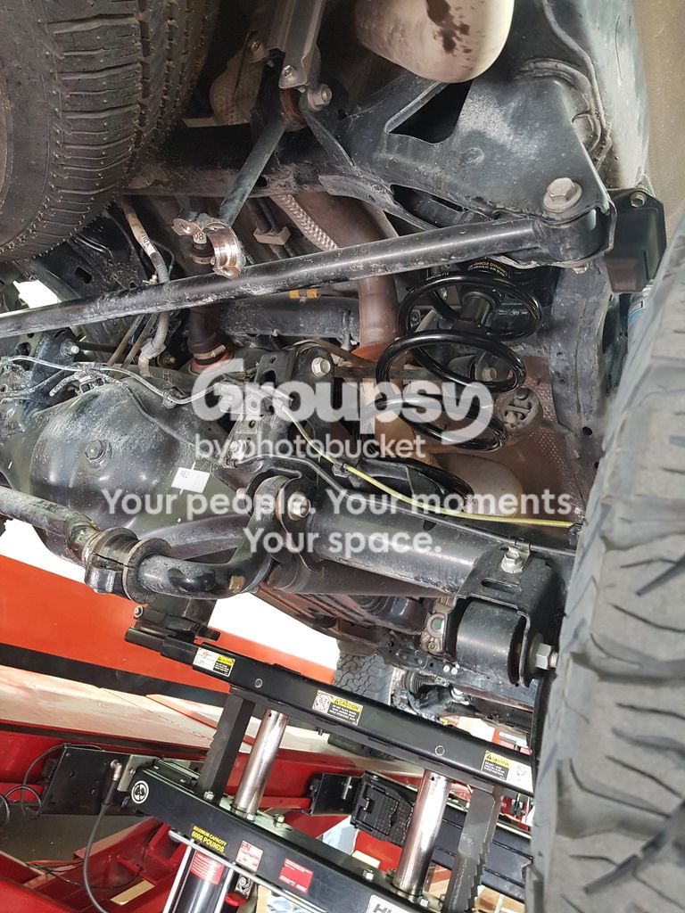

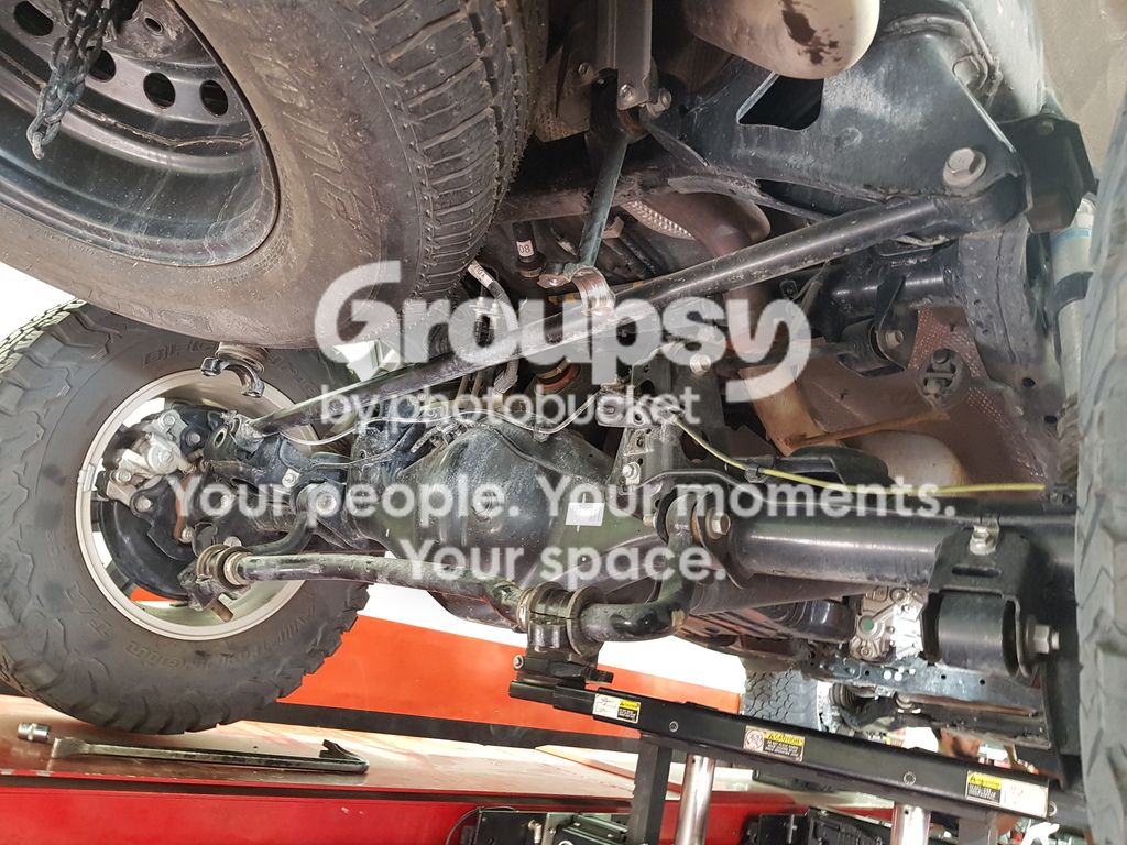

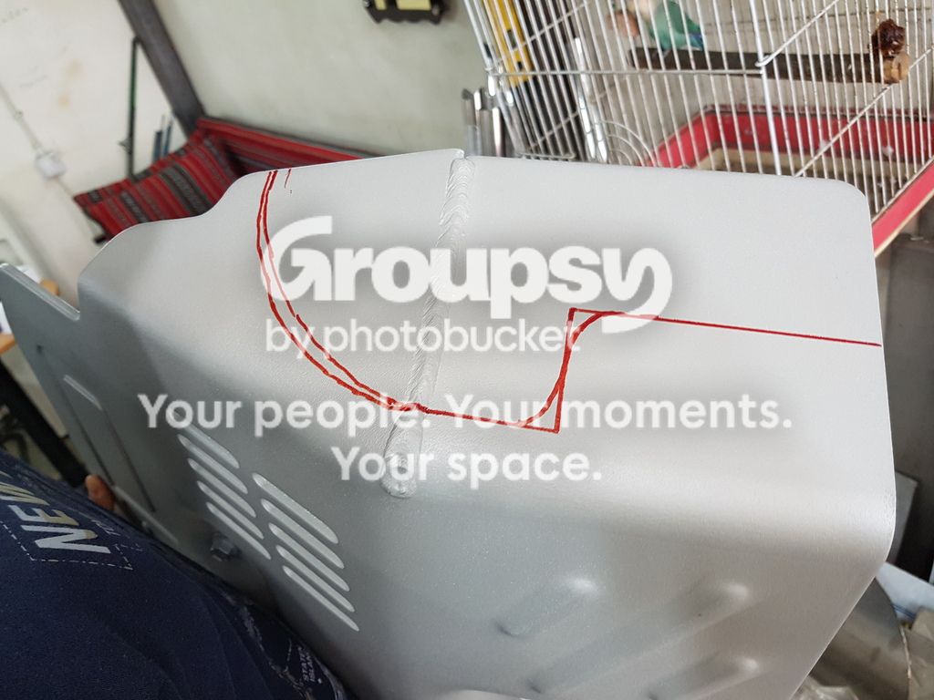

Alright so got the following done today:
Wheelers 1.5" T12 rear coils
ICON rear hydraulic bump stops

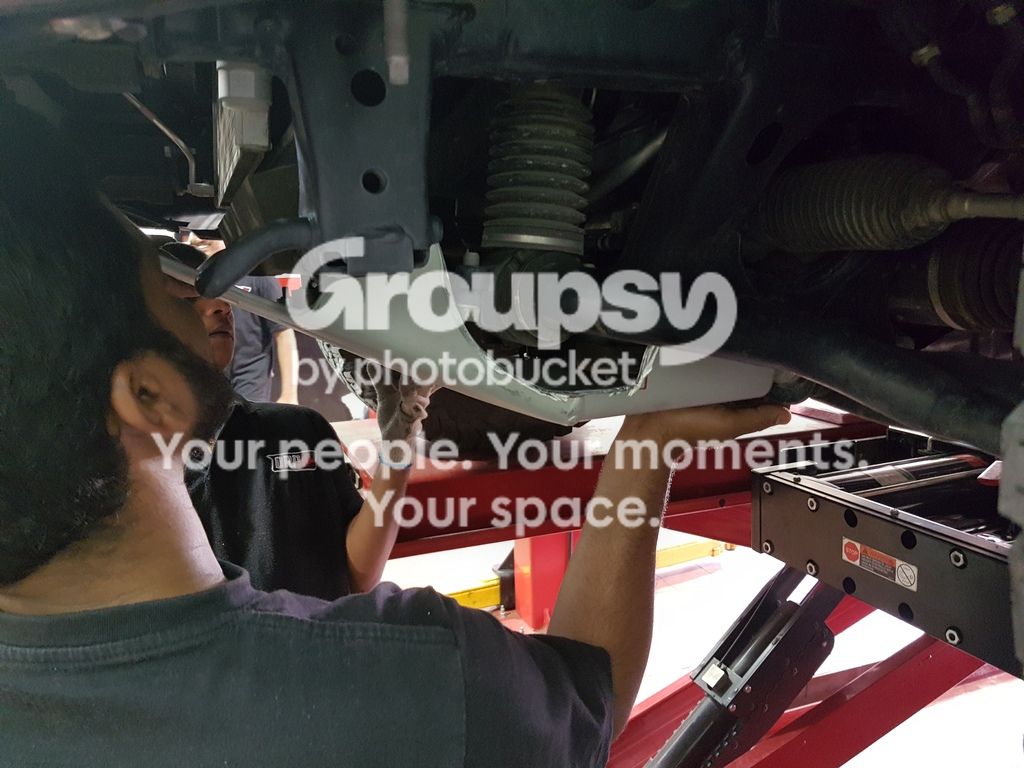

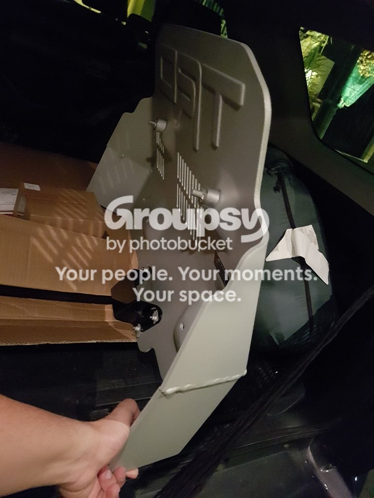

TRD front skid plate (modified for KDSS sway bar clearance)
4x Spidertrax 1.25" wheel spacers
Front bumper liner mod and minor trim to eliminate rubbing
Notes:
Skid plate went on without major hassles once they were trimmed. Kudos to [MENTION=139345]MtlTRDPro[/MENTION] for posting the cut dimensions and all others who posted their setups at TRD Pro Skid on '15 4Runner TE w/ KDSS
Pics as follows:
The idea
20160820_103148.jpg~original
The execution
20160820_111848.jpg~original

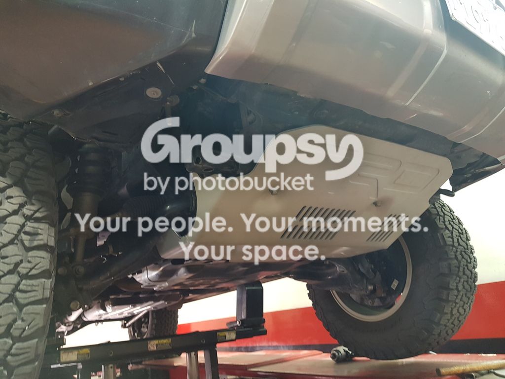

Stock skid off.. brackets exposed
20160820_152915.jpg~original
Brackets removed as well
20160820_152948.jpg~original
Cleared
20160820_153025.jpg~original
Making sure it all fits first
20160820_153030.jpg~original

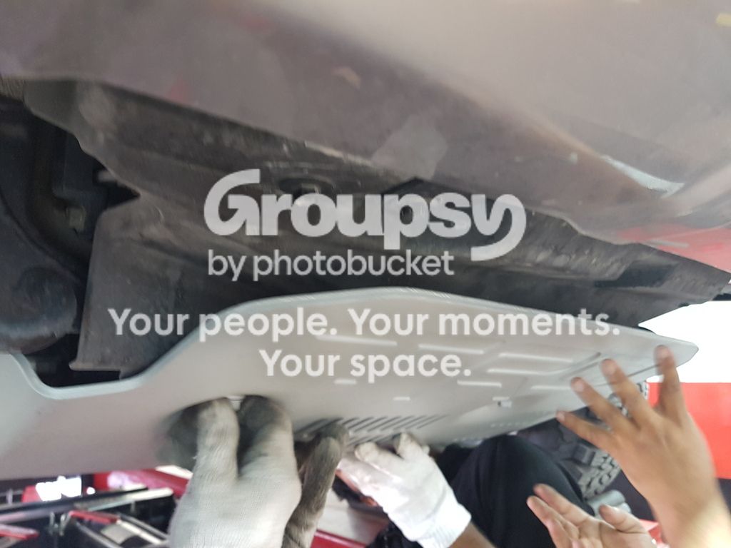

Figured to put the plastic trim back on and sandwich it between the skid and frame to minimize dust intrusion (vs leaving it off as some have done here)
20160820_153252.jpg~original
All put together and tightened up
20160820_161513.jpg~original

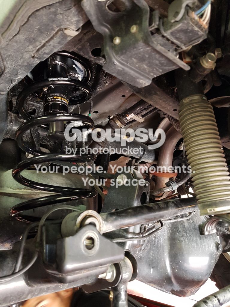

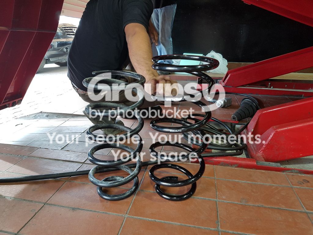

Rear end loosened up.. stock springs and bump stops off
20160820_153539.jpg~original
Stock coil vs Wheelers T12
20160820_153813.jpg~original

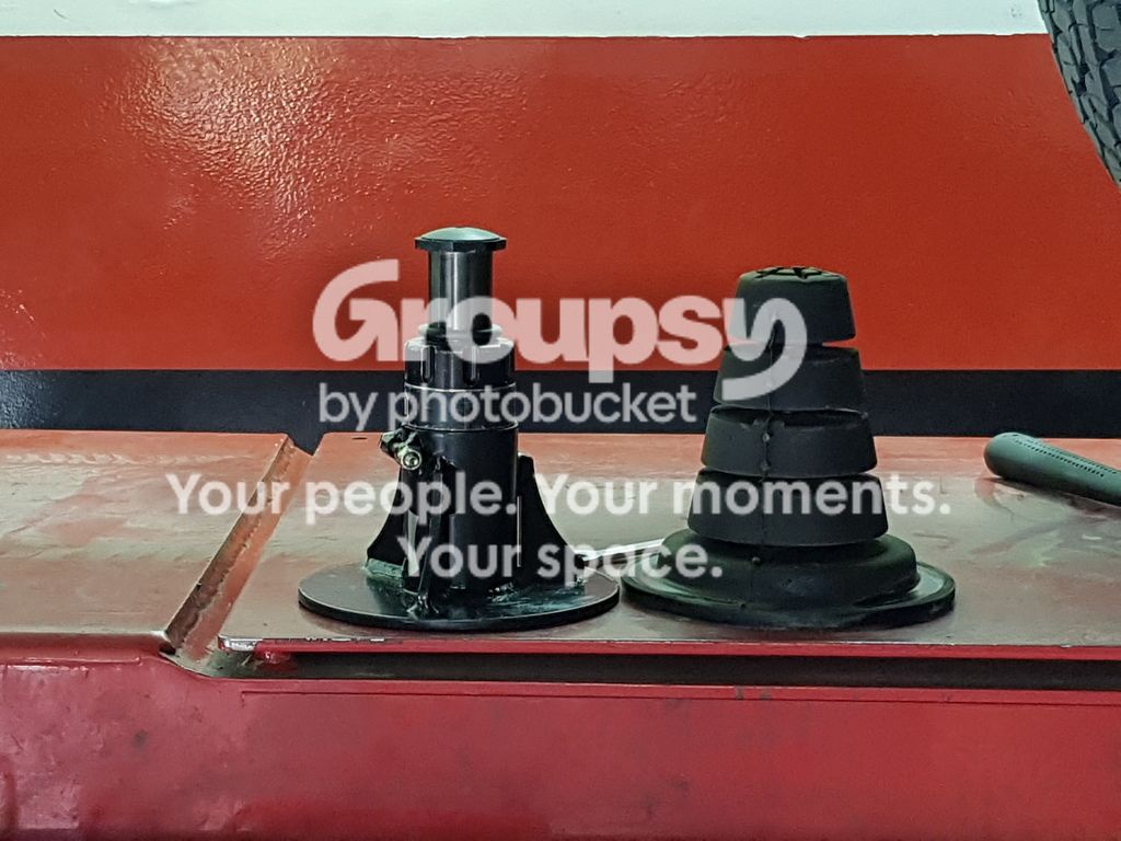

Stock bumpstops vs ICON hydraulic bump stops
20160820_153834.jpg~original
All going in, just needed someone to tug the tire side down a bit to slide it through
20160820_154048.jpg~original
Second side with new rear coil and bump stops
20160820_154606.jpg~original

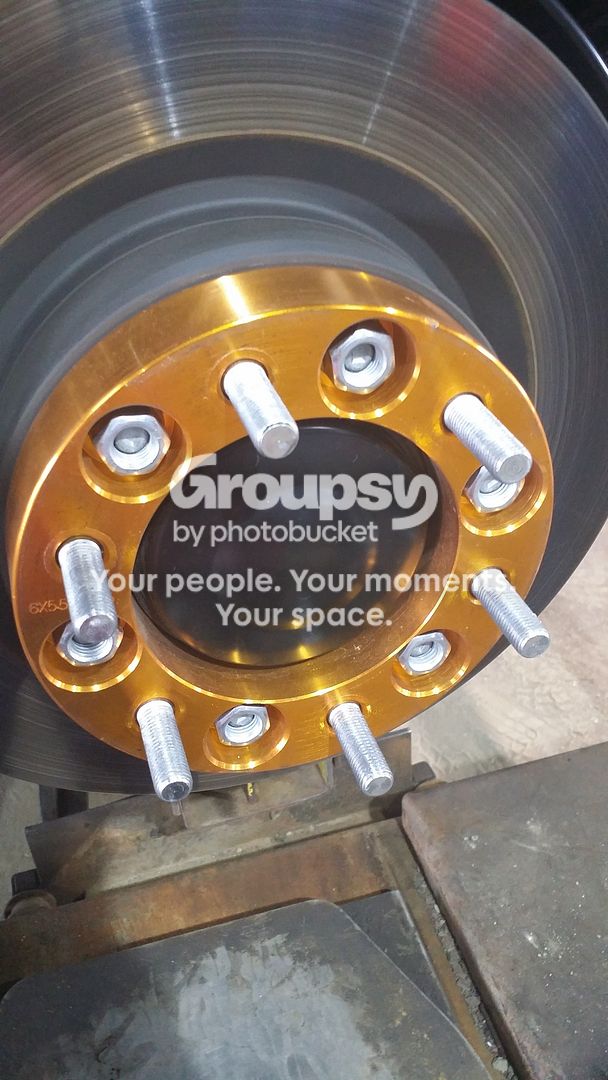

Spidertrax on all 4 sides
20160820_163759.jpg~original
Rear end up at +2" lift over stock.. higher than I wanted, but should come down once the SSO rear bumper comes in
20160820_173314.jpg~original
Second angle
20160820_173335.jpg~original

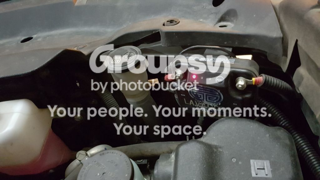

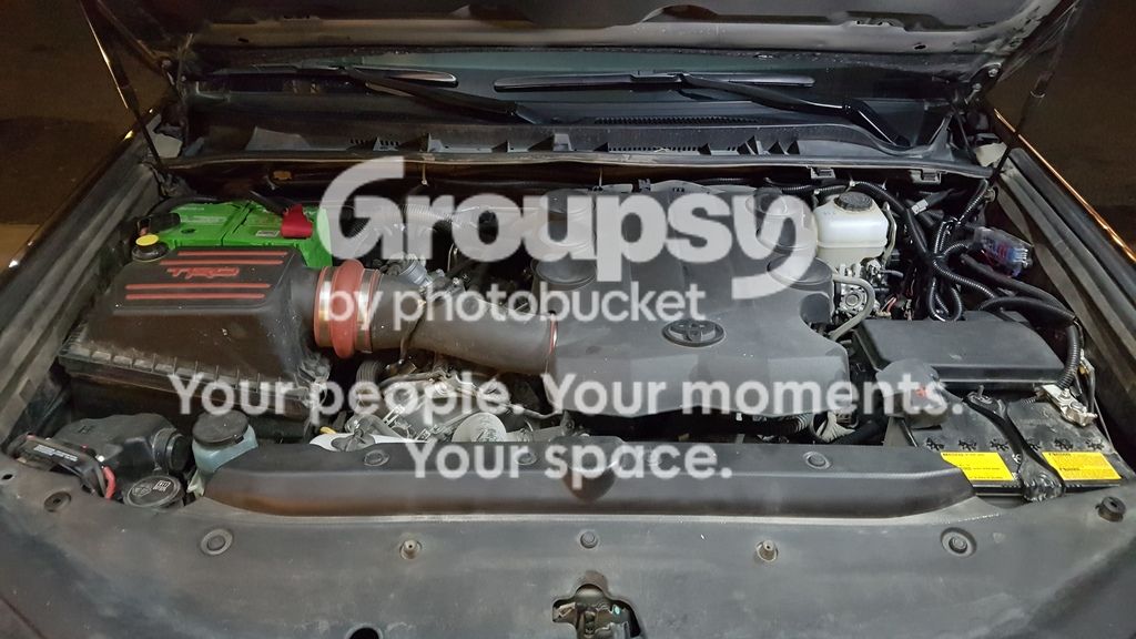

Dual Battery Setup

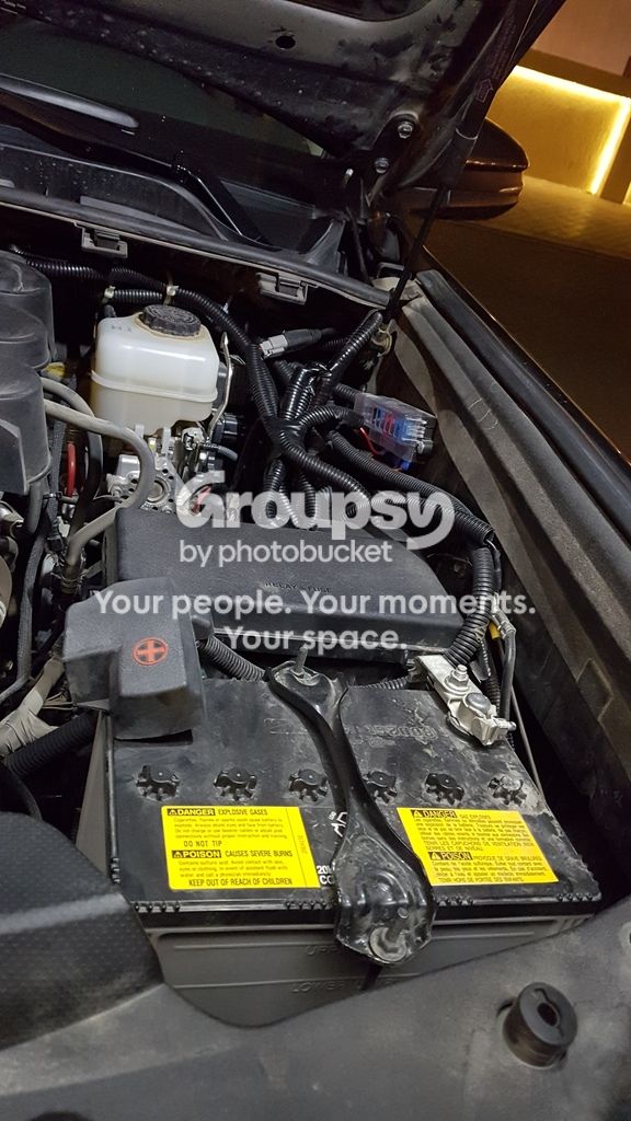

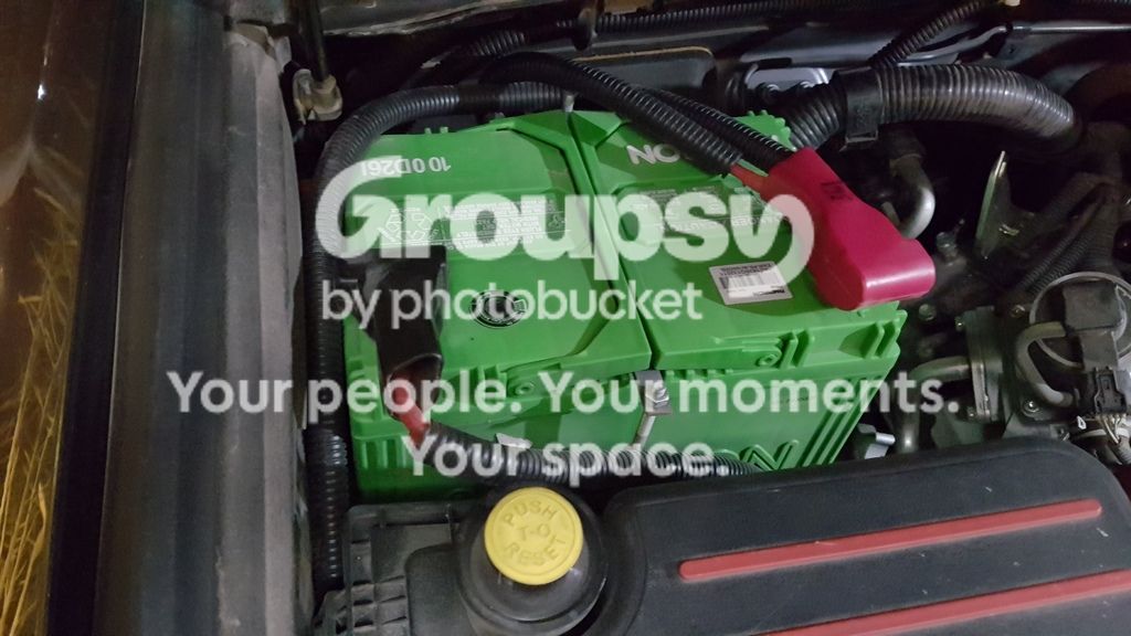

2 months and 6000 miles of desert off-roading /camping, its time for a post on my dual battery setup.
I'm no expert when it comes to electrics, so had a buddy help out on much of the wiring. Would advise the same to all fellow members unless you know what you're doing..
Basic components used are as follows:
1- Fabricated battery tray
2- A 12v battery (in my case,
3- Some sort of battery controller/ isolater. Mine was the 150amp WirthCo 20092 Battery Doctor Isolator
4- (optional) A fuse box to facilitate connecting everything together to the 2nd battery. Alternatively, you can wire straight to the battery.
From how I understood it, this is how it basically works:
Charge loop:
Car alternator (with engine running) charges main battery -> when main battery is full, isolator switch opens and starts charging 2nd battery.. otherwise, the two batteries are isolated -> Pushing the override PUSH button on isolator would manually 'open' the switch and both batteries are connected in parallel (i.e. allows you to start the engine when main battery is dead). Once the engine runs, the switch is closed and repeats this loop (i.e. lets primary battery charge first)
Discharge loop:
When engine is off (i.e. camping) you can power what you need from the 2nd battery and drain it. This will not affect the primary battery in any way, as they are isolated. If you need to recharge the 2nd battery, you can just turn the engine on and the 'Charge loop' above happens.
There are fancier/ more complicated setups out there, but I chose this one as it all happens automatically without driver intervention. Only issue I had so far was the ground wire screw coming loose once after some hard dune bashing (discovered by the isolator red power light being off) and just needed to be tightened.
Pics of my setup:

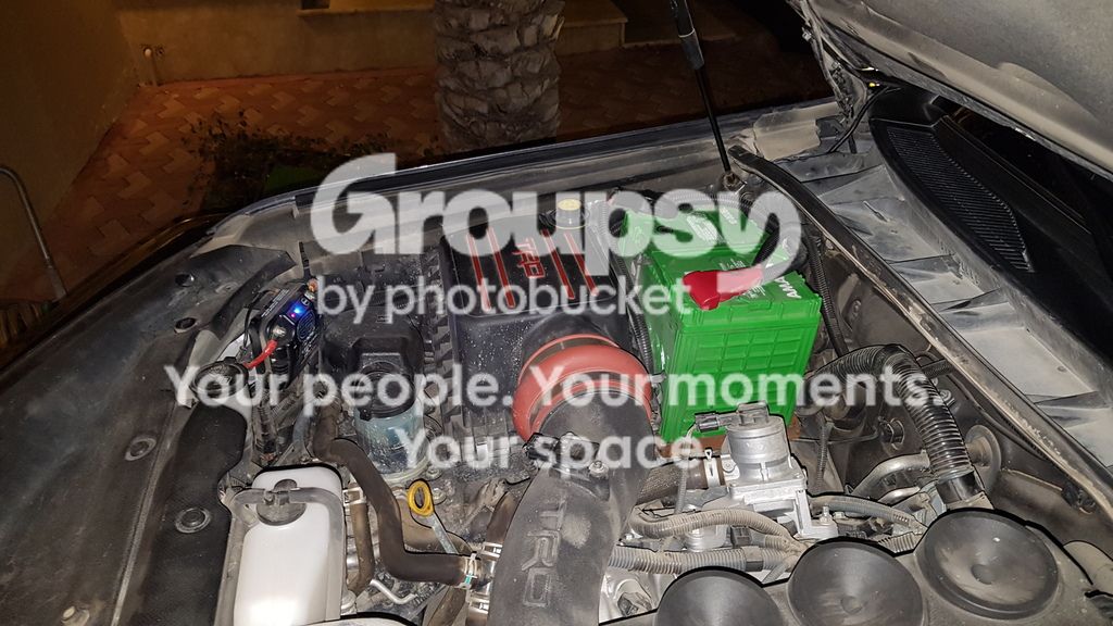

Overview, all wiring is covered and runs paraller to the firewall at the back
20161223_200245.jpg~original
Space is tight behind the intake box, but fits
20161223_200331.jpg~original

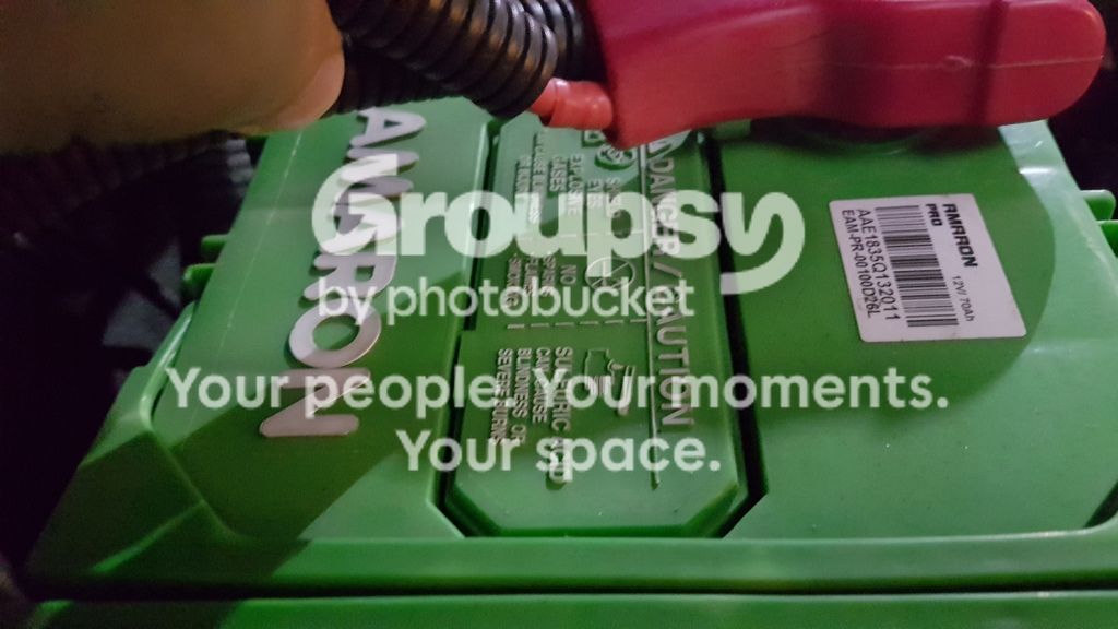

Battery closeup
20161223_200353.jpg~original
Side shot
20161223_201309.jpg~original

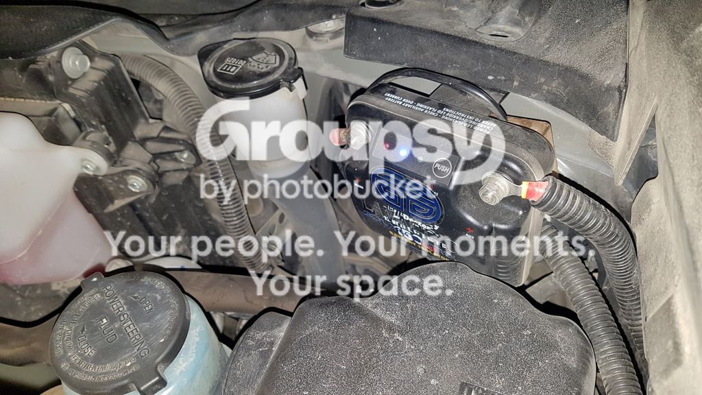

Battery Isolator (don't mind the sticker on it) mounted on the frame next to the washer fluid filler
20161223_200444.jpg~original
When the engine is running, blue light indicates it is charging the 2nd battery, PUSH button is the manual override mode
20161223_201103.jpg~original

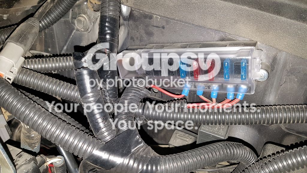

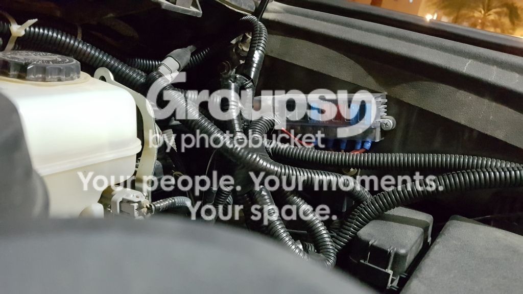

8-peice Fuse box mounted on driver side, behind the existing OEM fuse box. This is wired directly to the 2nd battery. Currently powers all additional lights and 2 extra (constant on) power outlets.
20161223_200503.jpg~original
Closeup
20161223_200456.jpg~original
2x red fuses are 10-amp (for the roof mounted HighPower LEDs, pair on each side) and 3x blue fuses are 15 amp (1x fridge, 1x extra power socket, 1x Rigid D2 lights). Still got room for 3 more fuses
20161223_201444.jpg~original

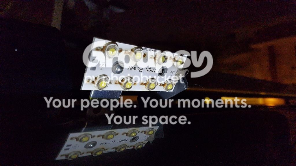

HighPower side LEDs are chinese cheapos commonly used here. Held up good so far in sand and rain despite their look. Has super thin profile that near invisible, and cheap to buy. These are silicone mounted to the roof using some bent brackets, and wiring done through the roof rubber rails. You can get these bigger (longer with double the no. of LEDs) or shorter (half the no. of LEDs)

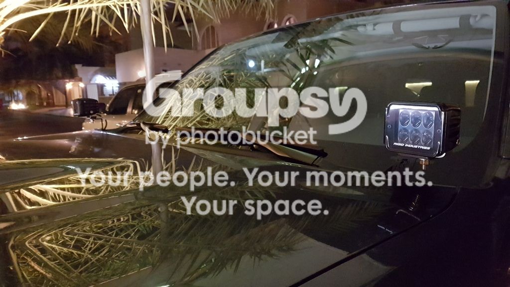

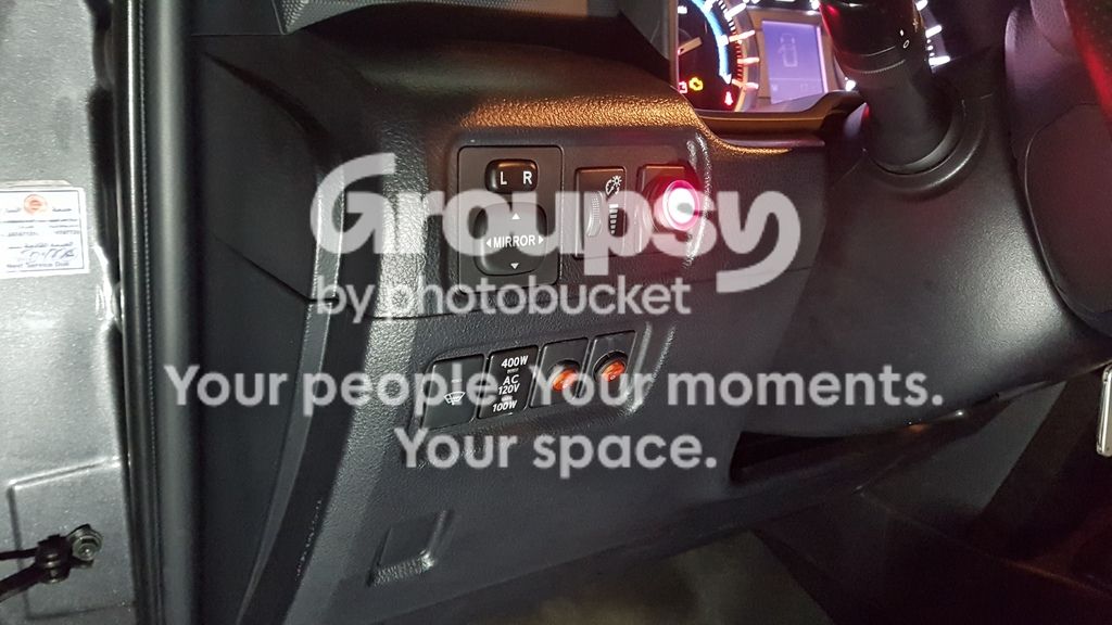

Switches mounted on the existing blank dash switches. Large on on top is for Rigid D2 ditch lights (comes with them). Two red ones below for the side roof lights
20161223_200208.jpg~original
Rigid D2s mounted, note pic is with the optional Rigid Industries 20198 Smoked Protective Polycarbonate Light Cover
20161218_192256.jpg~original

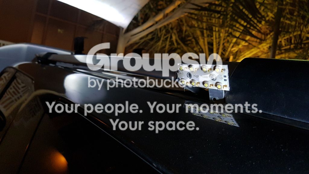

Mr. 'High Power' LEDs in silicone glory (driver - front side)
20161223_201003.jpg~original
Mr. 'High Power' LEDs in silicone glory (driver - rear side)
