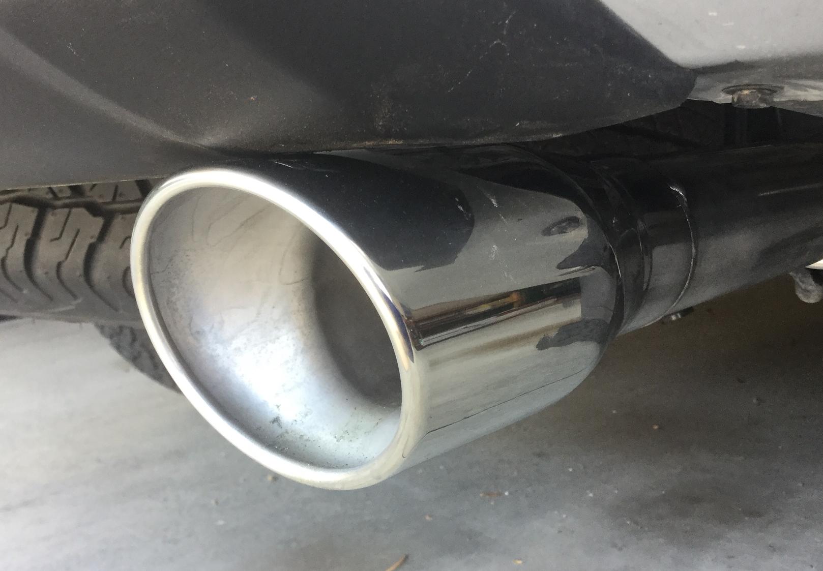

Instead of spending $500 on the Borla system I got the same size Borla muffler and a tip. I took it to a shop and had them install the muffler and put a bend at the end so the tip comes out the side.
Muffler $100
Tip $55
Shop install $100
Half the price of the complete system. The side exit is important to me, I ride with the back window down a lot and it has done away with the exhaust smell in the cabin. The sound is nice and goes well with the TRD intake.

I had to modify the hanger just a tad for it to clear my bumper.
I've got bumper contact as well. How did you modify the hanger?

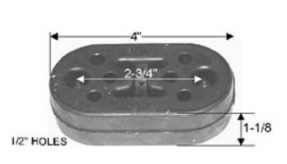

+1 on that bumper contact. Mine was literally just resting on the bumper. Just went to a local auto parts store, bought a universal hanger, and problem solved.
Is this the one you got? Looks like the stock hanger (isolator) has a 1.75" hole-to-hole distance. So this one should add ½" clearance.
