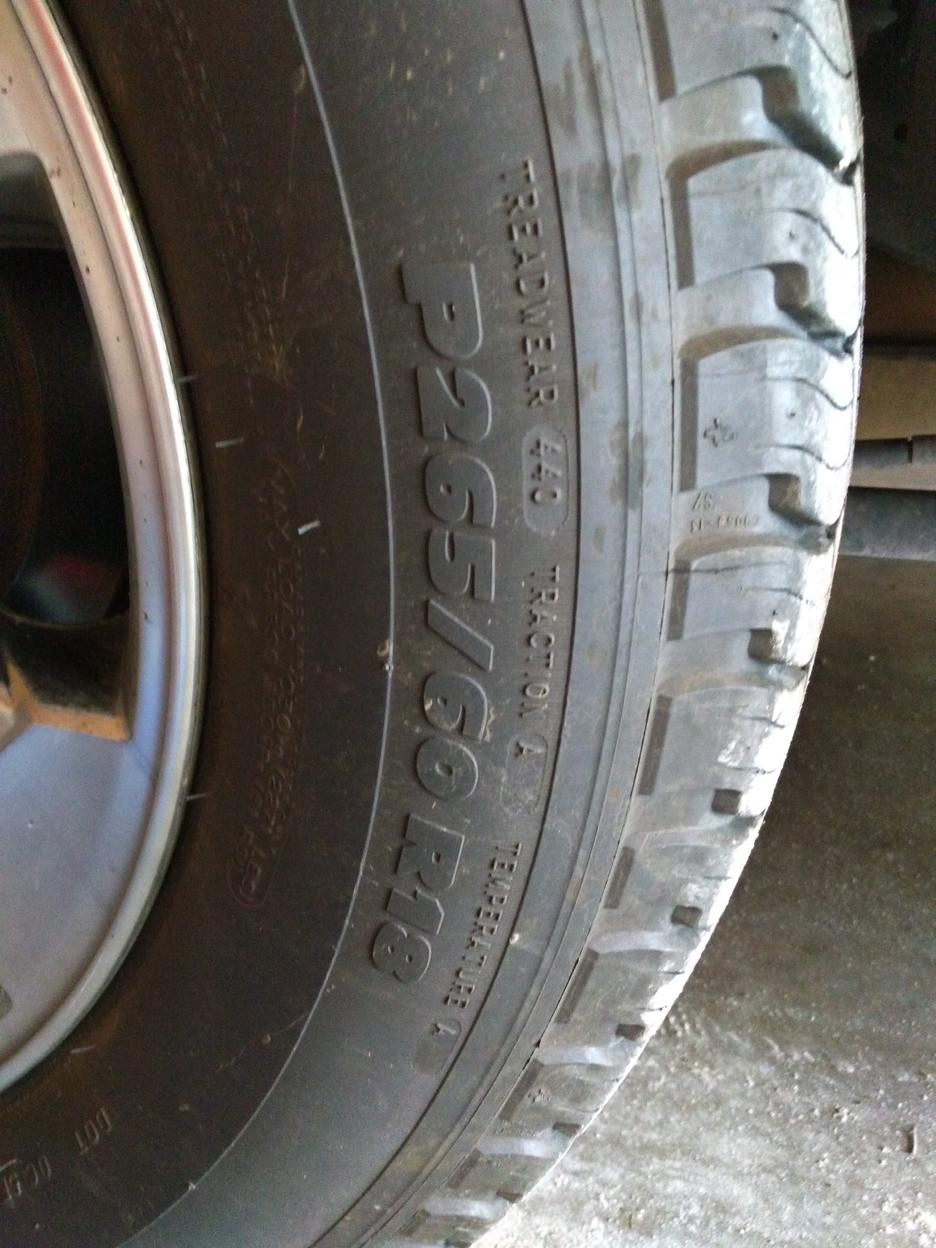

06 Limited with the 18" tires
Hey Guys,
Jumping in. I have a 06 Limited with the 18" tires. Does that mean it's 17" rims? or 18"?

Hey Guys,
Advice appreciated.. Thanks.
265 / 60 / 18 = Width of tire tread (in mm) / % of tire thread for side wall / rim size
You have 18" rims.
