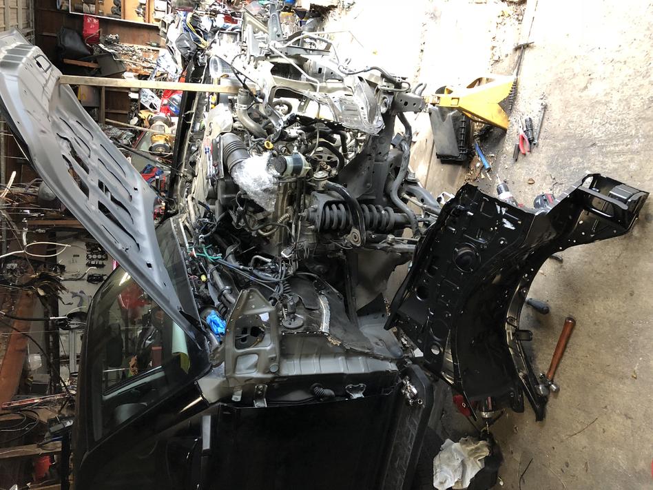

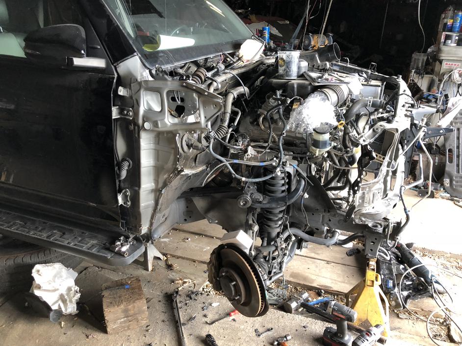

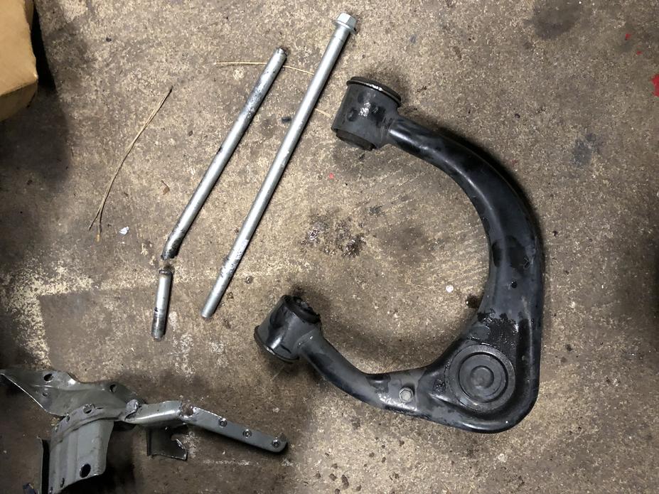

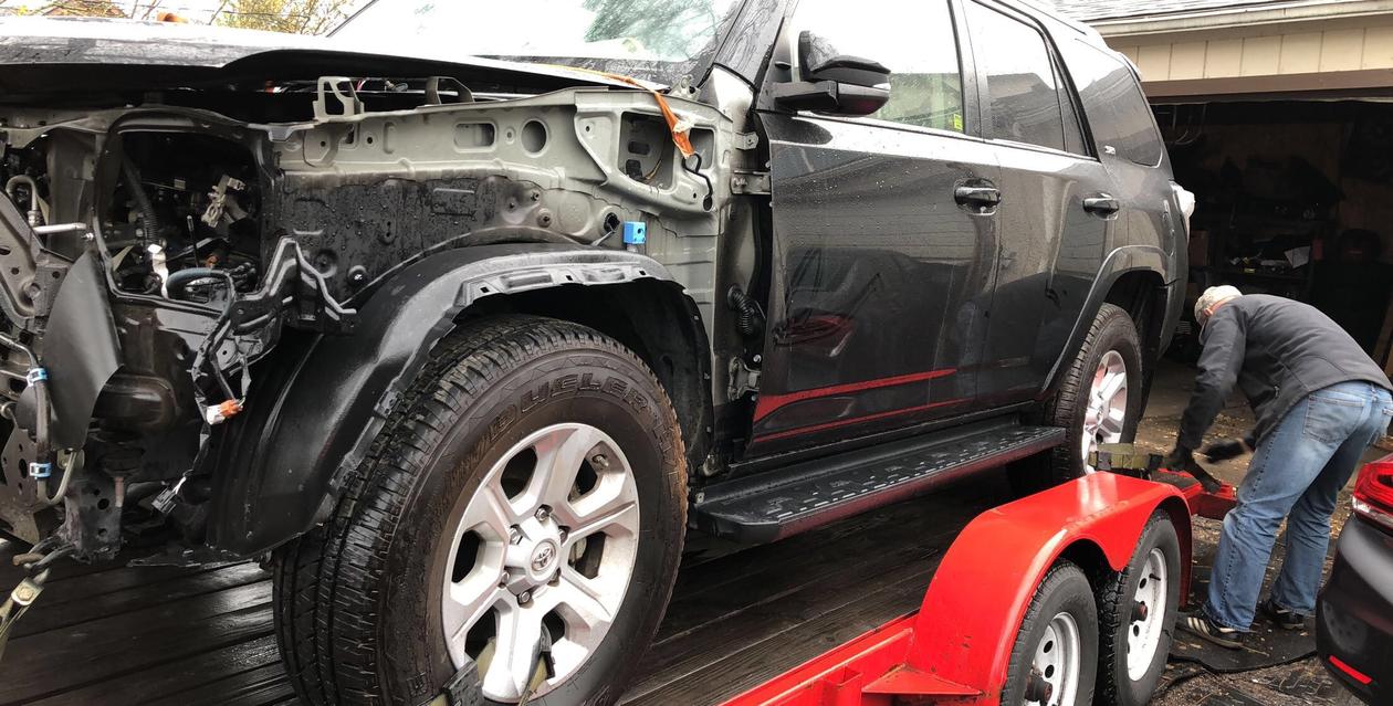

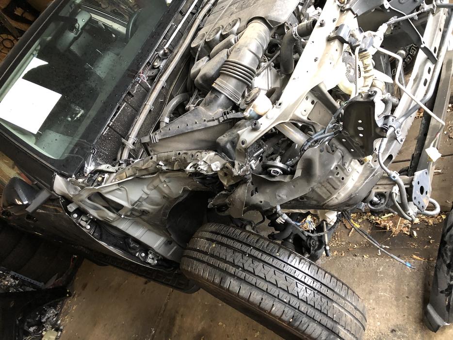

Got a front end damaged 4Runner posting photos as I go

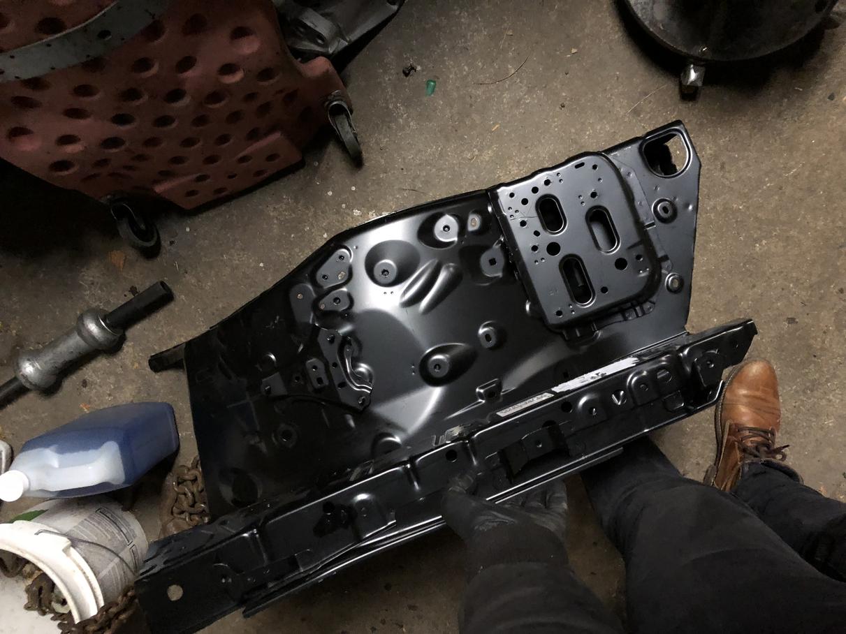

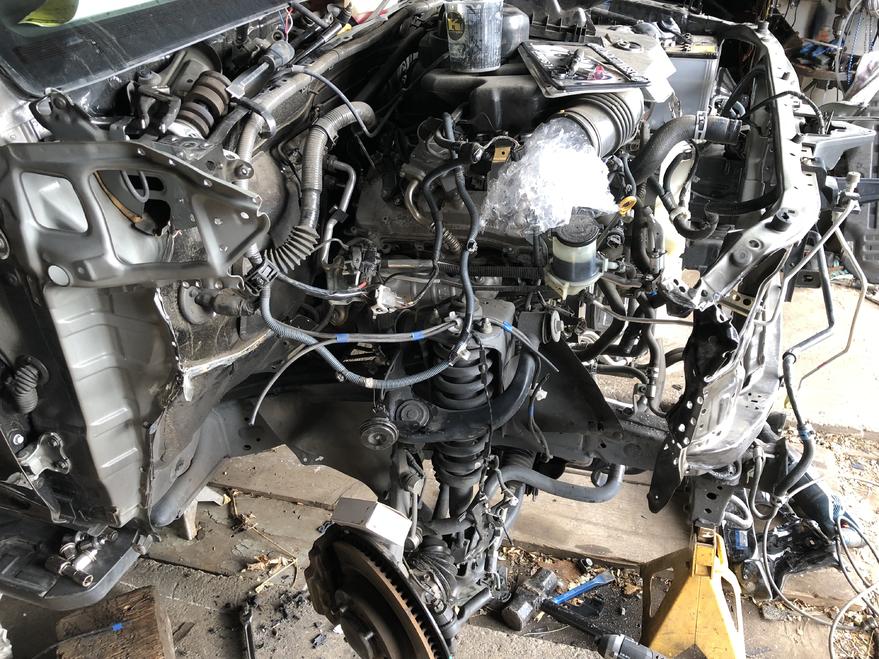

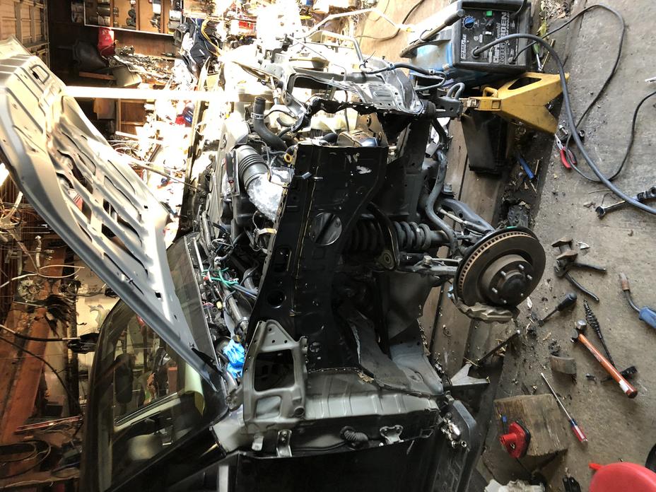

Pulling and cutting
Drilled out the bent up apron on the passenger side and installed a new one

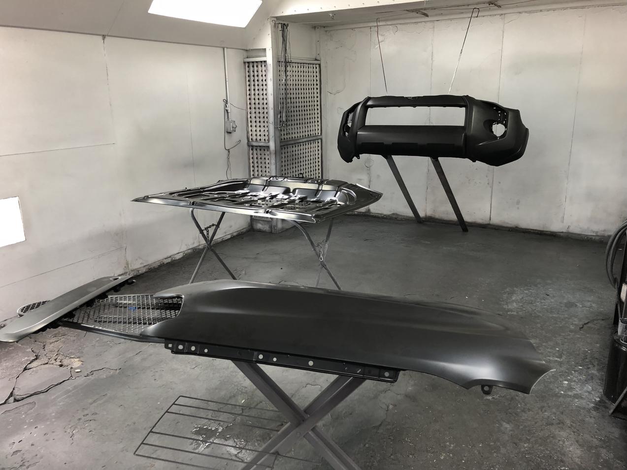

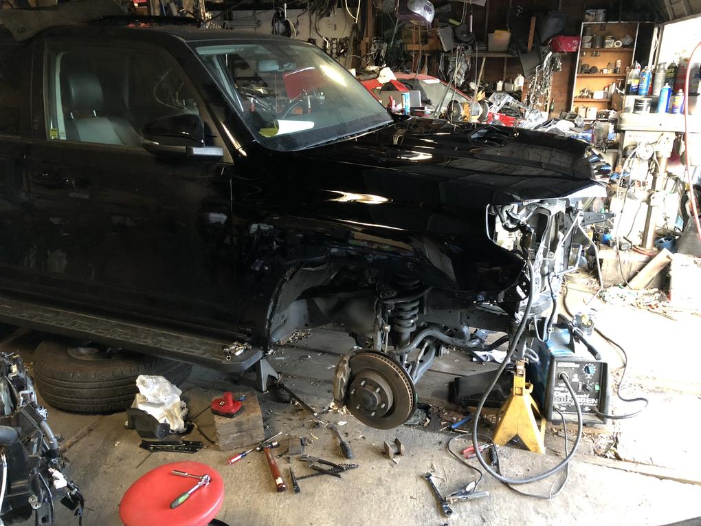

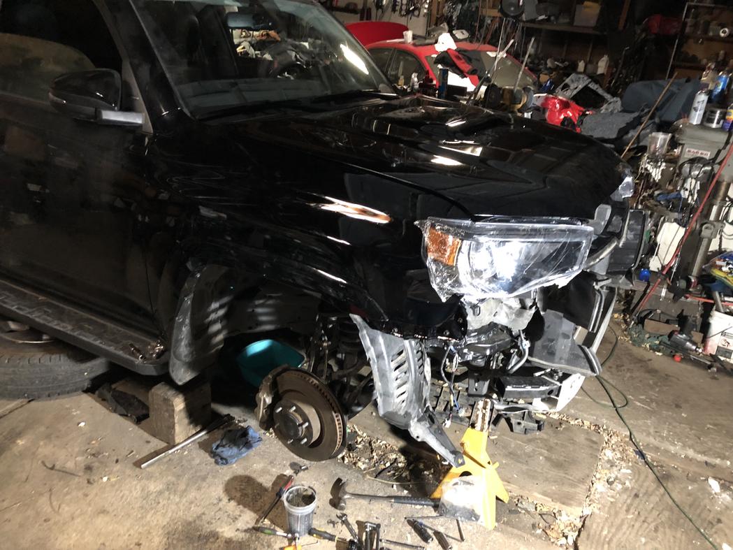

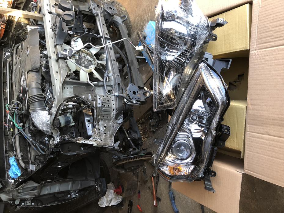

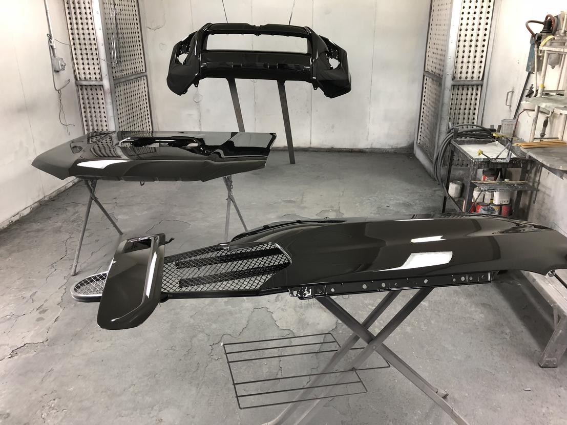

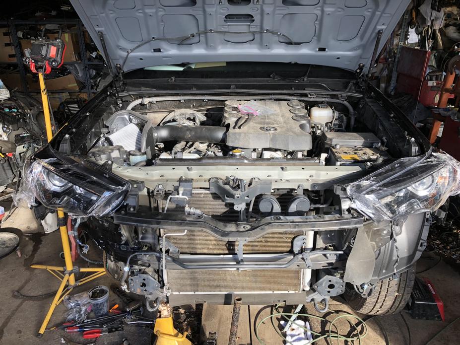

Putting it back togetwr
Got a new hood, bumper cover, passenger fender, headlights, rented a paint booth and painted all the parts

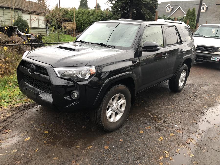

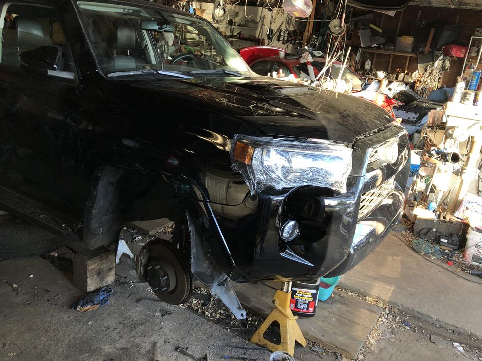

Finishing up the build... for now
Installed the bumper had few other things I needed to fix like tie rod, axle boot was ripped, ABS sensor wiring was damaged, fixed it over 3-4 weeks was a light project

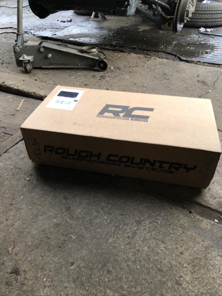

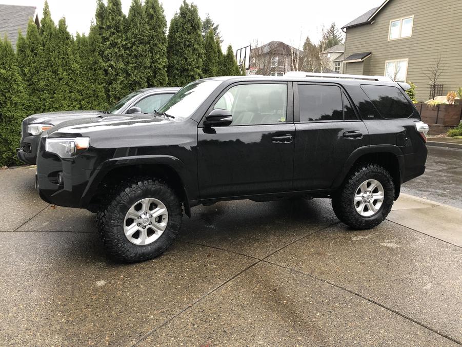

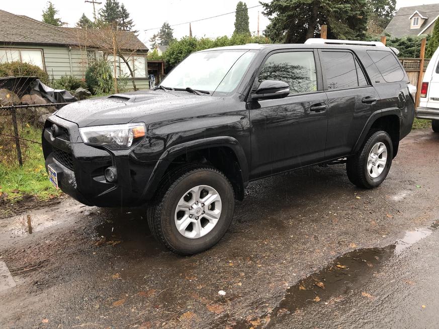

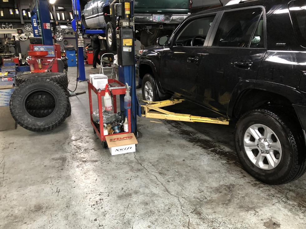

Installed a 3” rough country lift
Got my lift kit in yesterday went with a 3” rough country lift, and got 295/70r17 tires getting them installed later today, last two photos are before/after installing the lift

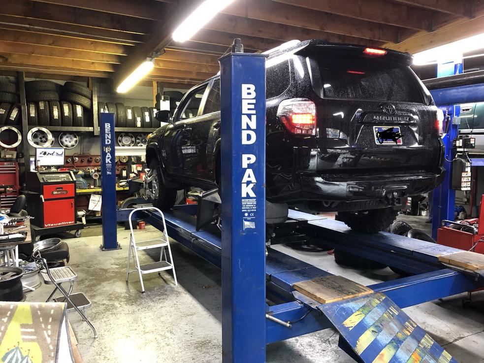

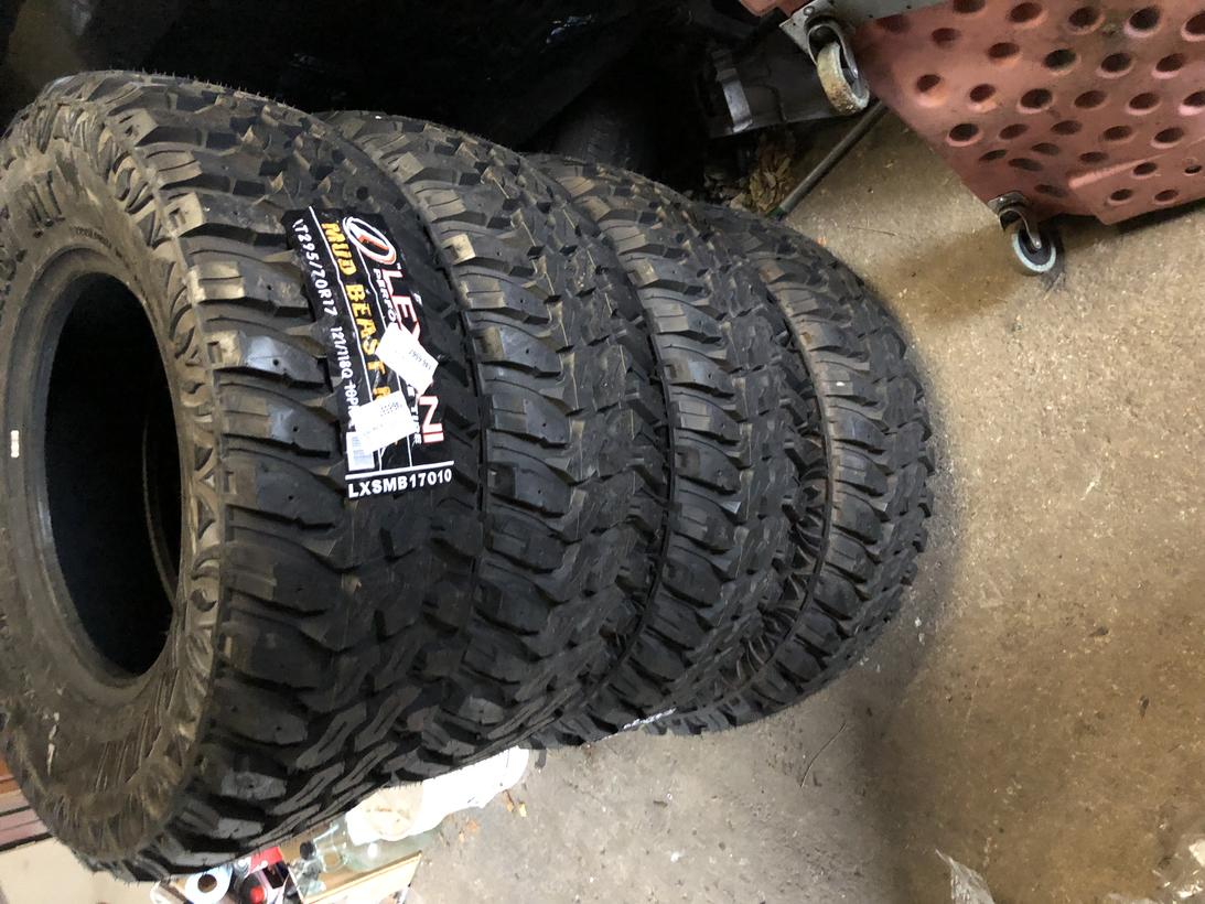

Tires/alignment
New tires and alignment after the lift, next is spacers and painting the rims black

Nice work OP. What doe you do about the stock air box? Looked pretty mangled in you first pics. Did you replace it or go with a CAI?
Also, did you do a BMC for the 295's? rubbing?
air box was mostly fine just the lower part of it was cracked/missing, Went cold air intake bought it online kinda crappy tho might do something else later on, only pic I have of it right now
ya i went 295 and a little rubbing so i need to trim some the fender liner/mud flap
