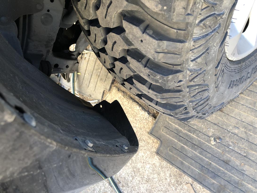

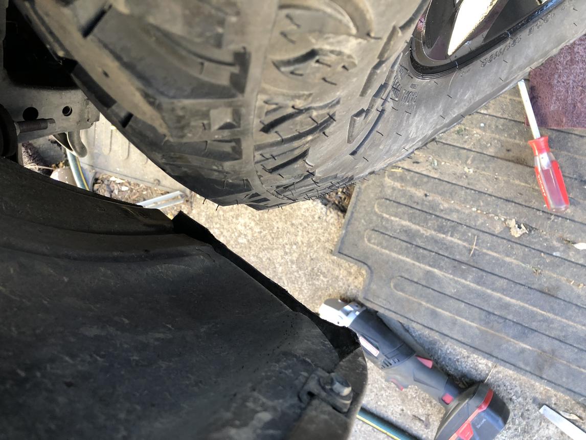

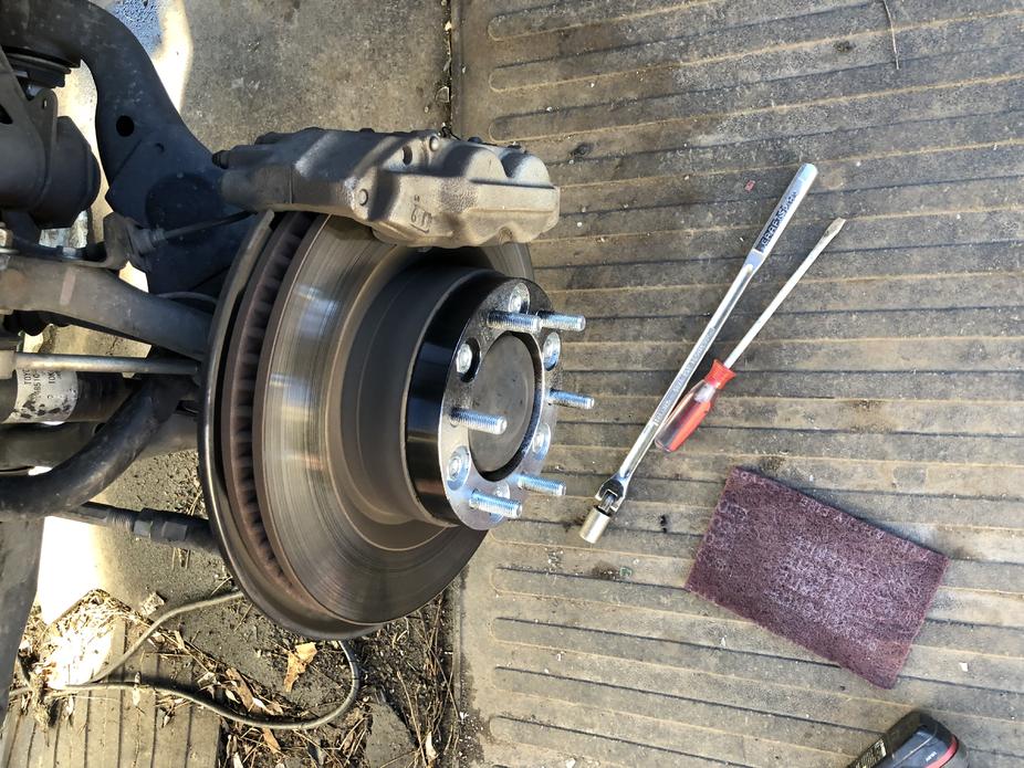

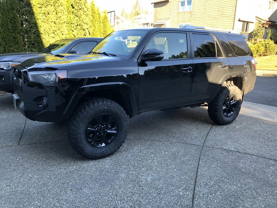

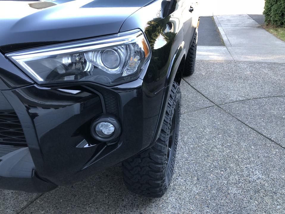

Removed the front mid flaps and trimmed the front bumper, also installed 1” spacers and painted the rims black
