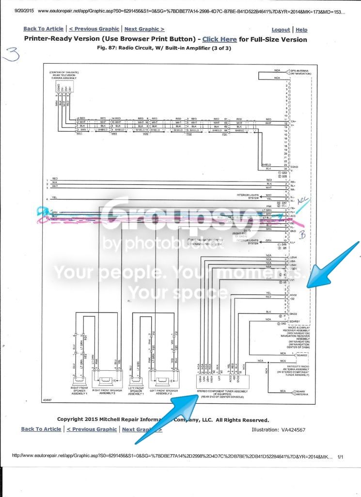

Hi 4runick,
I know you said that the issue is a vin that needs to be changed to one associated with a system that has the 'ENTUNE APPS'... Just wondering if your new Premium HU came with the modular processor (Hard-drive) that runs/stores the apps ("see BLUE ARROWS"); without this part the apps, USB, and AUX inputs... will be Grayed-out along with a msg telling you that the APPs are NOT installed! Look at the diagram below and be sure that this processor is included, attached, and connected via a short (horse-shoe) harness to the new HU!

Oh I can open the apps they load then I get a pop up that says I need to get the app. I get Bluetooth, aux, and the apps aren't greyed out.
