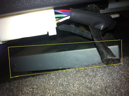

Anyone know what this box is for under the passenger side seat. It's obviously something electrical. I guess I am more surprised it is secured to the floor?

Thanks guys I was thinking it was likely an amp. I do have the jbl system.
When the dealer washed it they left the passenger window open and soaked the entire passenger seat and floor mat before realizing it was open. I dont think it did any damage to this amp/xm box, but I don't know how to be sure. Radio plays well no issues... As of yet....

So then maybe the xm transmitter? I'm thinking I should pull the seat to insure no damage was done...

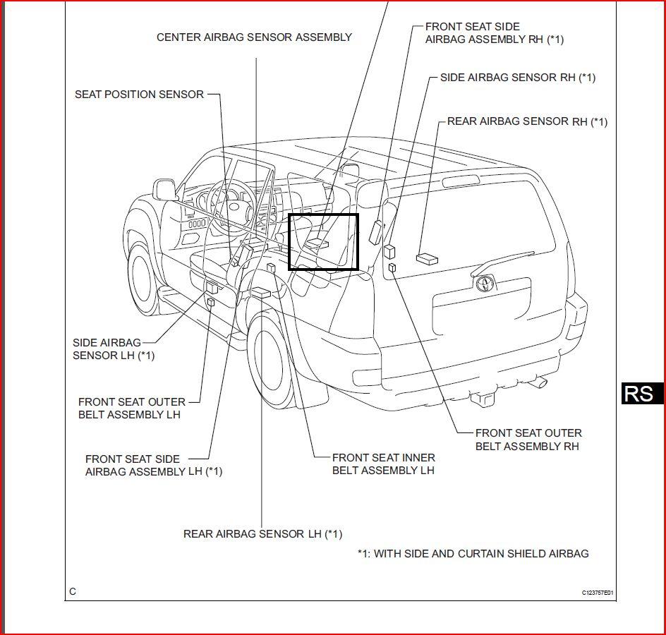

It is probably some sensor nexus for Airbags or something. It is a small box under the passenger seat. Seat sensor for airbags...

It is a 2007 SE with Jbl sound system. The passenger window was left open when prepping it for my purchase this past weekend and soaked the seat and floor.
I am concerned about damage to whatever this electrical box is? And I was hoping someone here might be able to clarify what it is before I go spout off at the dealership.
No. My read from the service manual is the sensors are in the seat, the Occupant Classification ECU is shown as being horizontal on the floor.
I have attached a image of it. It appears in the same general location in several pages of the service manual. Always just a bit off; obviously the manual isn't to scale and it represents the only "box" in that area.
