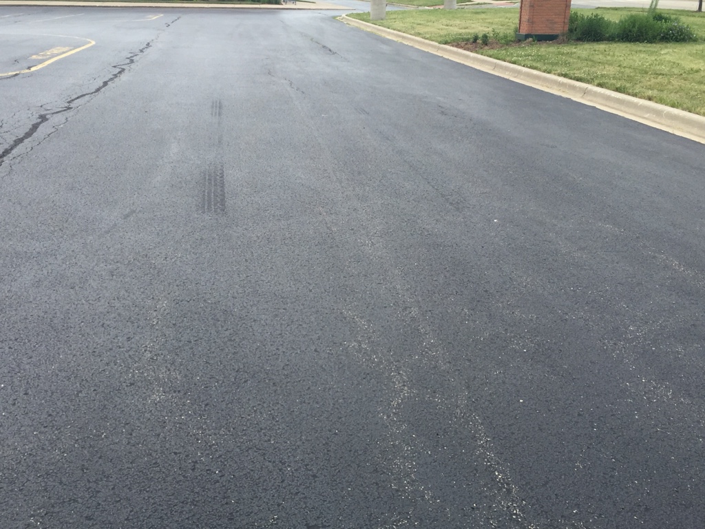

OK so I just went to a nice country Road 40 miles an hour stab the brakes and I was able to get the rear tires to lock up and slide the truck to the left.
I never took my foot off the break just like a panic stop and there were black marks on the road from where I just did my stop test.
So the rear wheels are actually locking up
Marty-MJ
This is a 20mph parking lot test I just did.
Marty-MJ
Marty-MJ

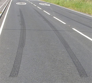

Those are ABS marks. Sure, they left some rubber but see the intermittent marks in your pic? Not locked up. Here are locked up skid marks:
You will get those marks under the right conditions. The main advantage to ABS is you can still steer during heavy braking as your brakes pulse. When fully locked up (non ABS) you are just along for the ride and cannot steer.
It's normal.
