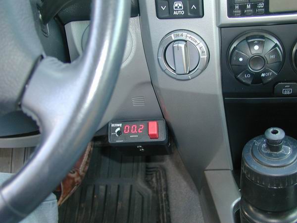

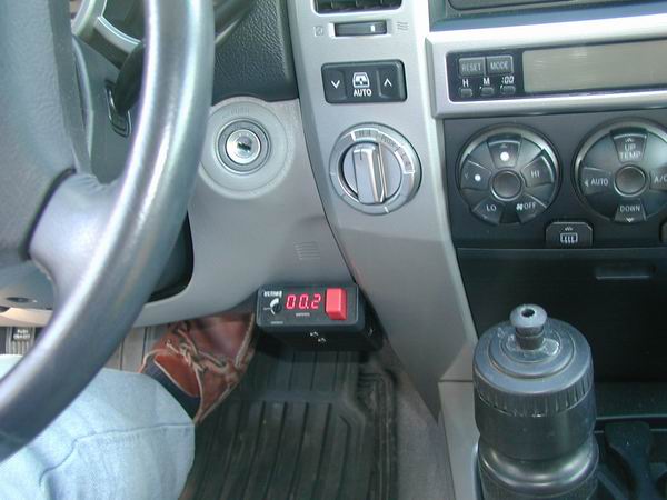

I installed a Jordan Ultima in my 4Runner, it is compact in size, can be removed easily and is a proportional braking device, works also in reverse. I installed it on the right side of the lower dash. I will try to take a photo tomorrow.
I recommend the Jordan, very simple to install.

I have posted two shots of the Jordan controller installed on my 04 unit. I have placed my foot on the brake pedal to indicate the LED display.
