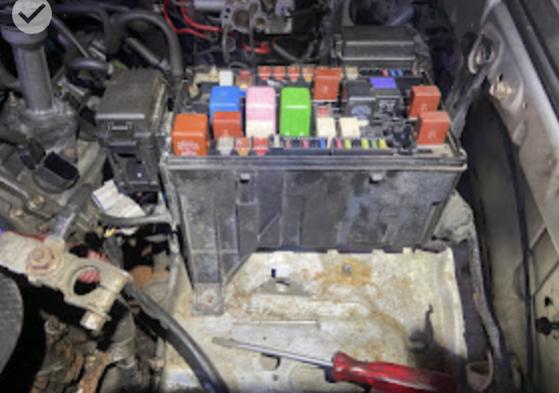

Green Crusties:
Is this the copper carbonate hydroxide... copper corrosion... meaning green patina on copper connections?
I have not seen the green copper patina anywhere as of now. The relays are clean, they look new to me.
I haven't looked at the sockets in the fuse box with the microscope but to the naked eye the sockets look good. By removing/wiggling the relays pins rub hard on the socket leads. I removed these relays now various times... so they should be clean.
I could use vinegar/salt solution (or Brasso) and clean the sockets out....
Should I remove the fuse box , look more closely and clean the sockets if any doubt?

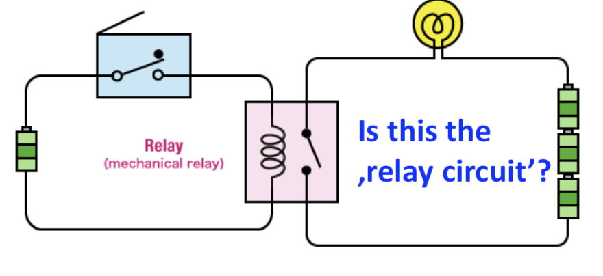

What for example would be a short in a Relay circuit.
What is called a "relay circuit" I am assuming if the relay circuit is the circuit that is staring the motor or the solenoids.
The result of the short would be a closed contact of the ABS Sol relay.
But this does not happen during this alarm at all.
As I explained: With the green relay removed I mimicked a short by directly connecting
[1 and 2- work circuit] with a wire (creating an artificial short in the relay circuit).
But nothing happened.... well I did not leave it in place for very long...
Maybe I should try leaving the short in place for some time?
I am assuming the second code: Battery short in ABS Sol Relay is the same thing, Is it the same code or what is different between the two?

Green Crusties:
Martin
Yes, it seems to happen under fuse boxes where the wire is crimped onto the female connector. You can't see it from above.

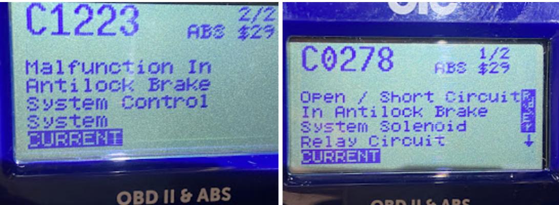

I was reading the codes again today:
1) C0287 open/short circuit in ABS Solenoid Relay Circuit
2) C1223 malfunction in ABS Control System
These seem to be codes from EVENT2 (the code that cannot be canceled unless I pull the relay/
You guys were sometimes talking about the route cause for the codes, meaning there is the main problem and then the electronics follow up and there are more codes.
If I see these two codes... then the root cause might be the following:
There is a problem in the ABS Control System (malfunction in the skid control ECU causing Code C1223??) That is triggering the alarm.... and then I pull the ABS Solenoid Ralay and get rid of the alarm but I am triggering the second code C0287....
Can it be that simply pulling the ABS sol relay will trigger C0287?
Could anyone of you guys check this?
What happens when you simply pull the green relay....any ABS code showing?
I ordered another used Skid control ECU when is a good time to install this one?
Should I install this ECU first before the hydro booster swap in order to see if this will solve the ABS codes?

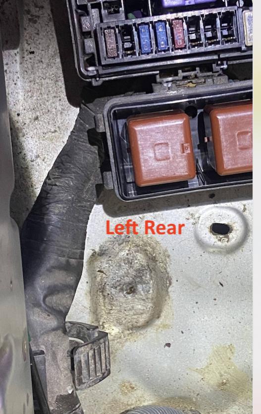

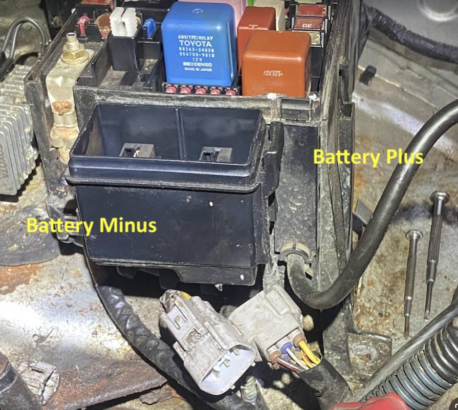

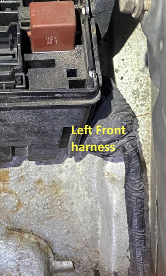

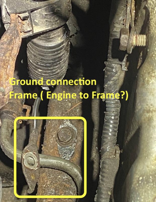

B) Then I started digging up the fuse box in order to search for crusties (see pictures) . The fuse box seems to have a closed bottom, other than the US cars.
There are 4 access points to the box.
1) front right: battery plus
2) rear right : ground (?)
3) rear left : biggest harness coming from fire wall
4) front left : harness to the front
The 2 harnesses don't seem to be connected to the box with plugs... but the harnesses go straight in.. making it difficult to remove. I think I leave the crusties there.
I will clean up the ground connections as much as I can and assemble everything back.
