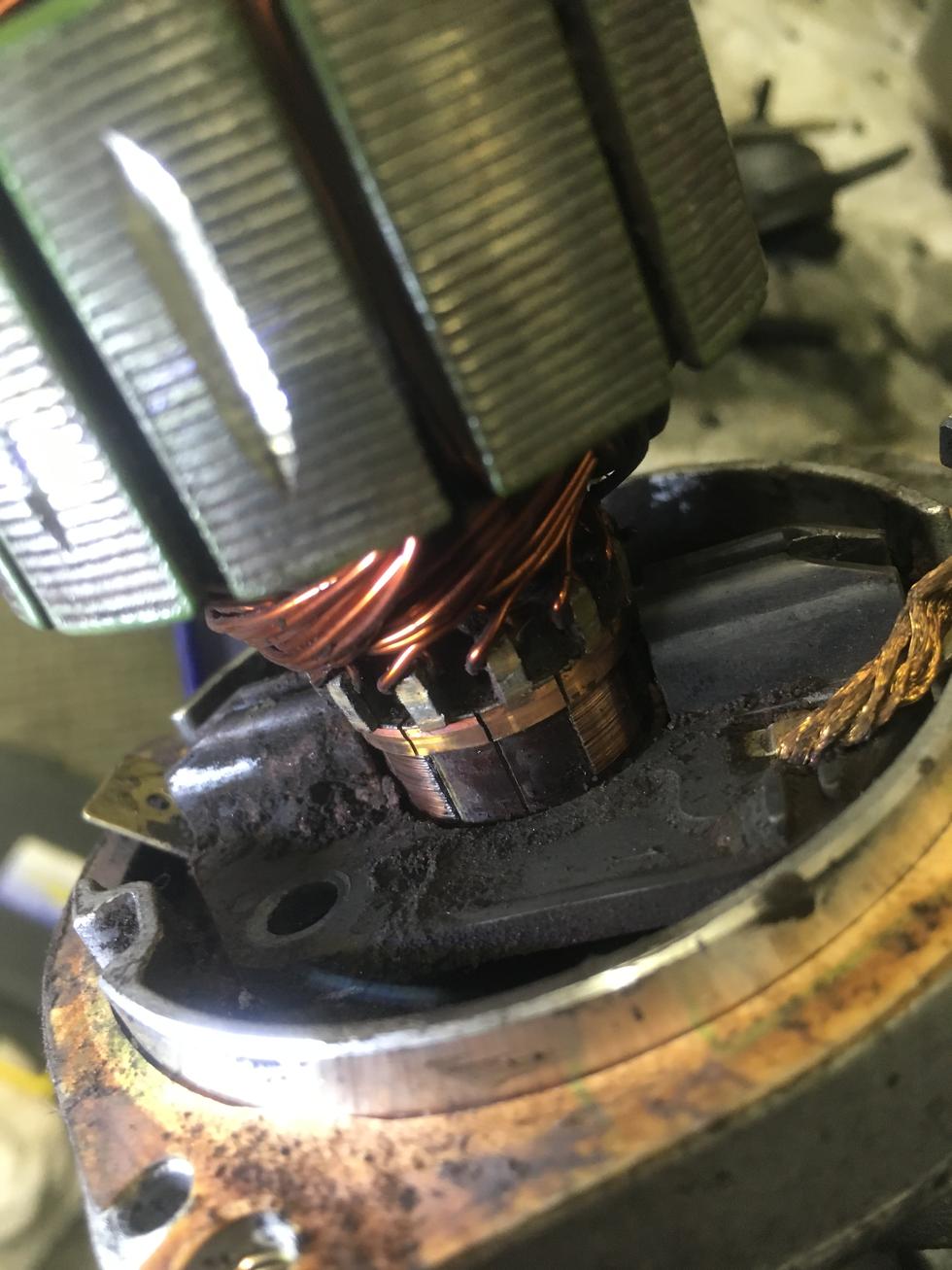

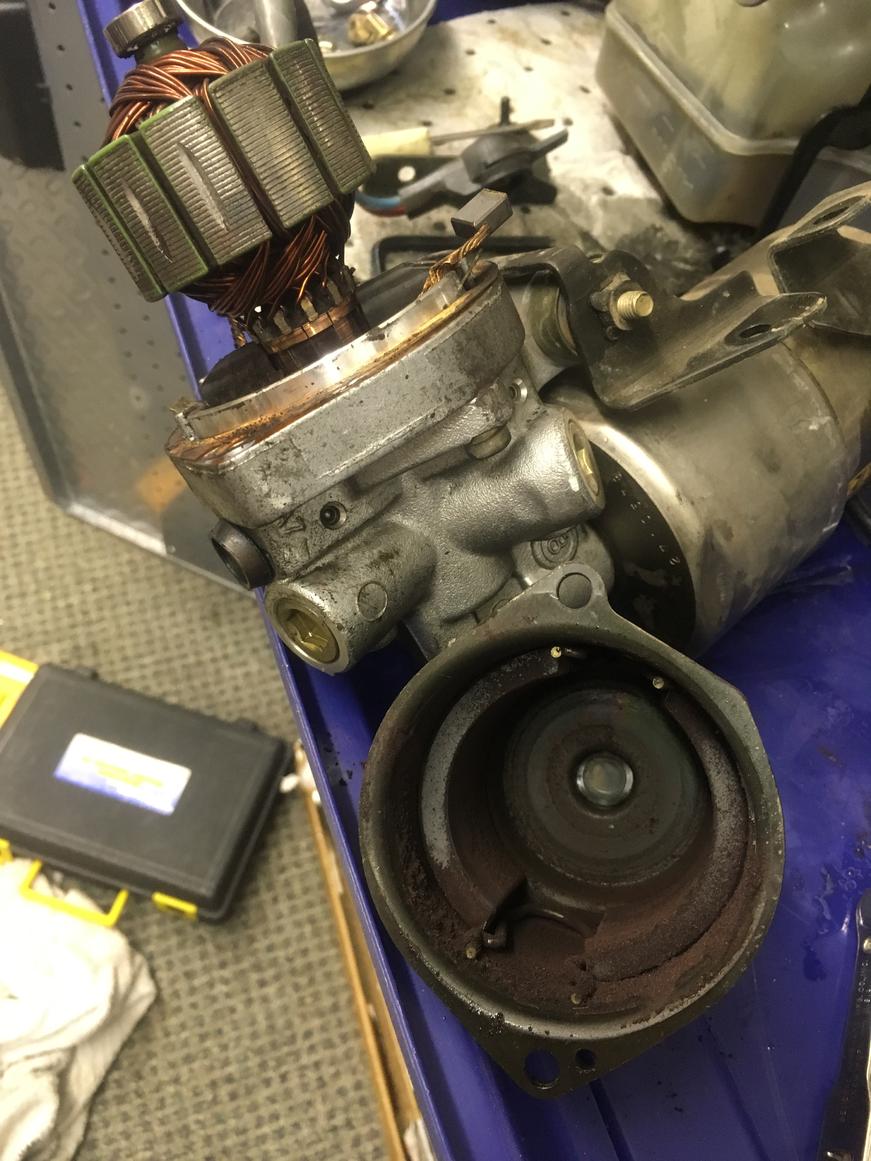

Here is the pump with the motor still attached. Two screws and they are separated. The brushes where worn about half in 200K. The second picture shows the burnt commutator.

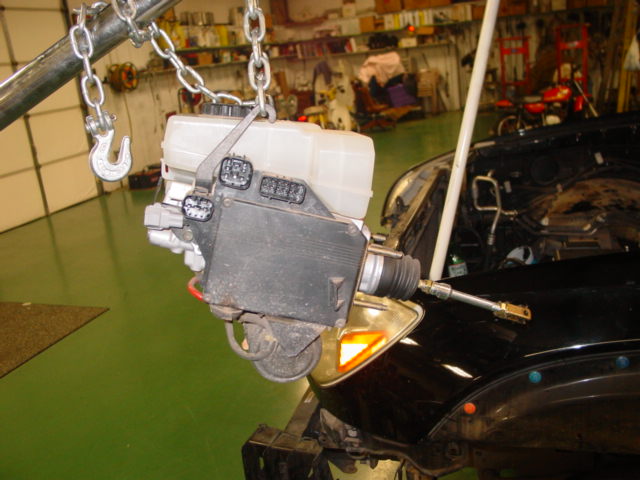

I am talking about the brake booster motor on a master cylinder like this:
The only thing that I am repairing is the motor. The commutator was burned. Before the unit failed completely the motor started spinning slower, not as fast, and it was quieter too. It helped to compare the sounds when I had another T4R right next to it of the same year.

I understand what you're talking about, I was just curious if the company you referenced was strictly motor repair only or if they were able to source additional parts. The reason I asked was more for getting an idea if other parts are available as the motor is not always the component that fails.
