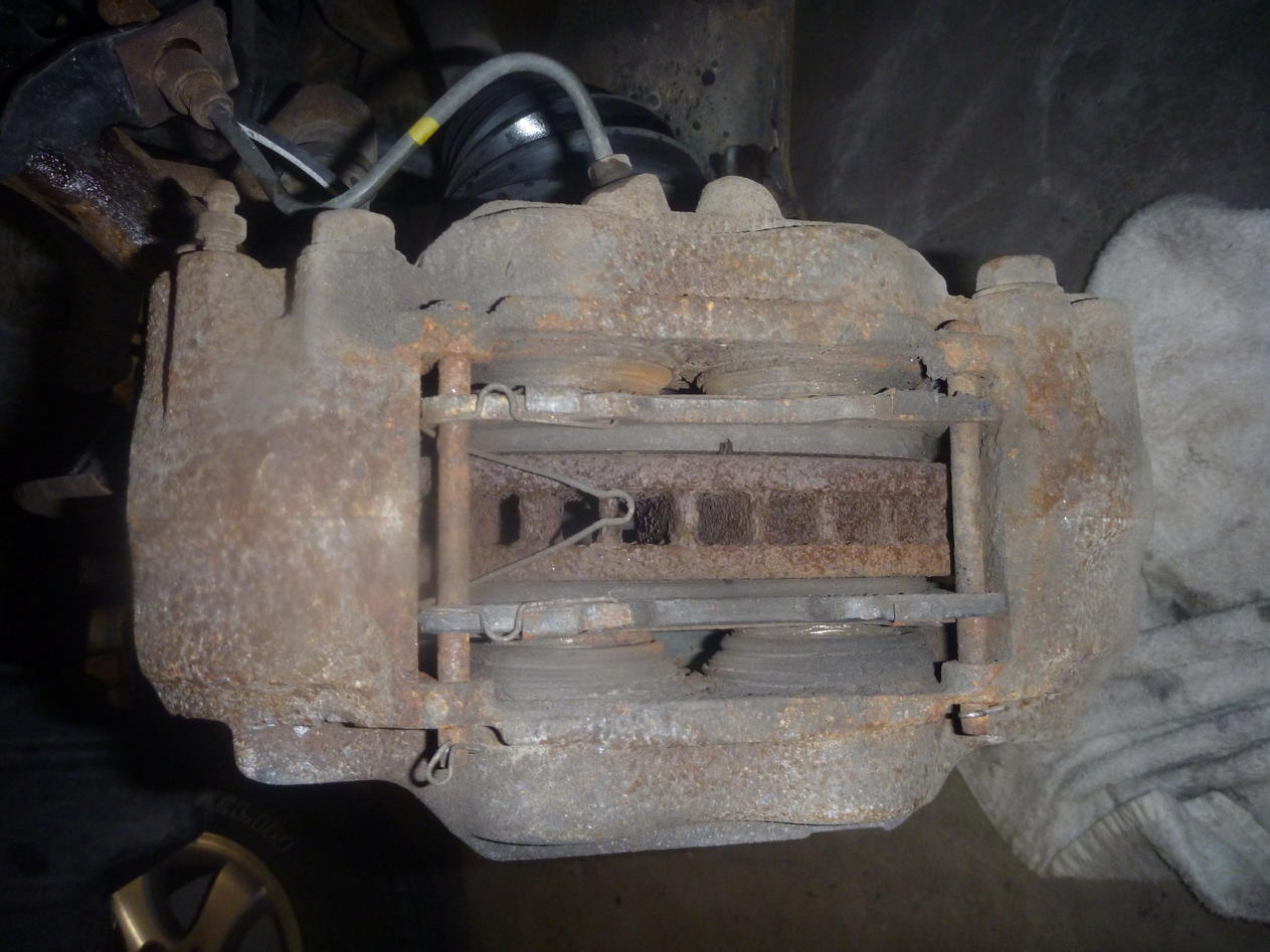

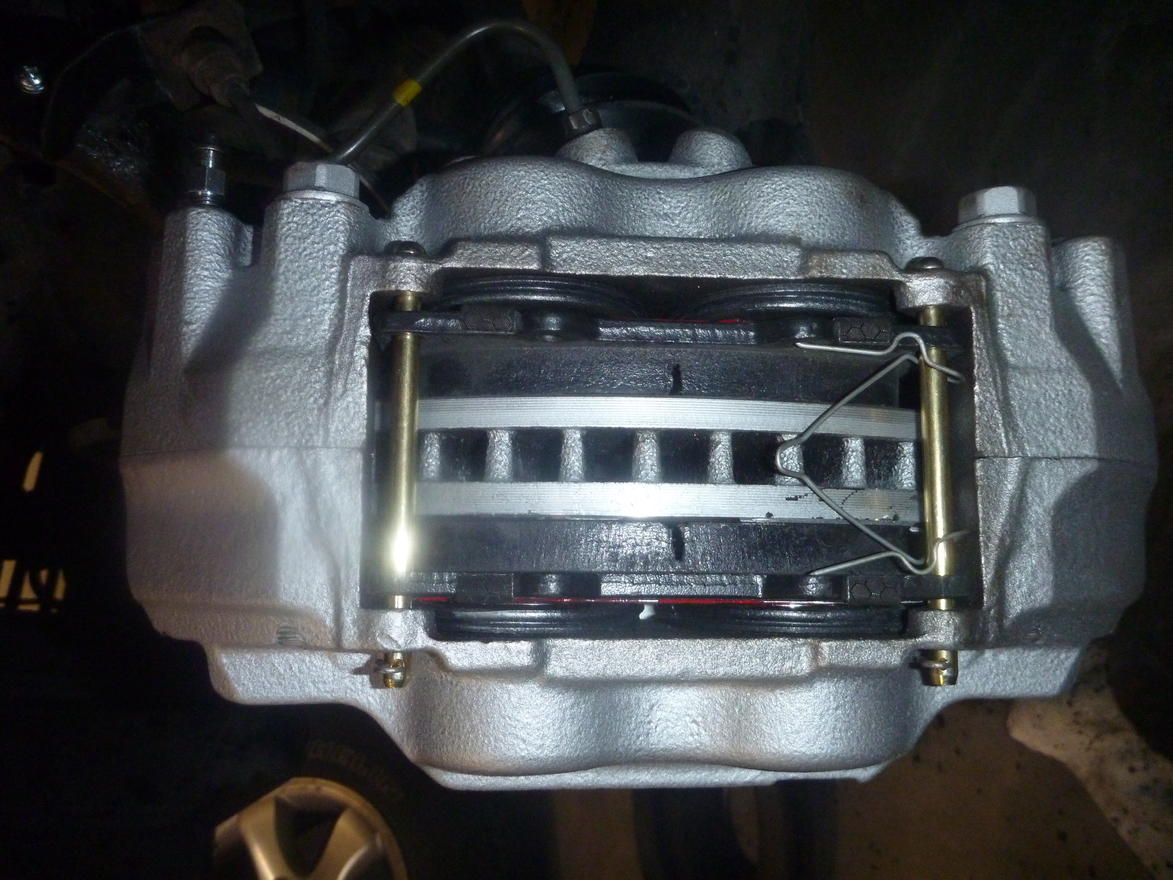

Here are some pics... old vs new. The old were very rusted. The guide pins were completely stuck. The two inner pistons on both front calipers were frozen while the two outside pistons on both calipers were still operational. you can see the increased pad wear on the outer side due to the frozen pistons.
