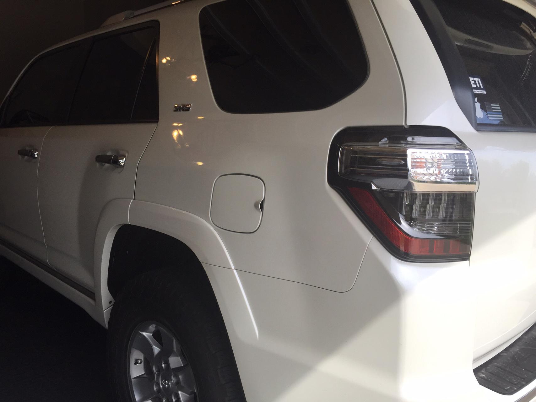

I just had this happen to me as well this month, also on the Driver's side brake bulb, tested out everything, new bulbs, finally I took off the passenger side tail light and plugged it in to the drivers side wire harness and it worked fine. So I needed a new tail light and this was the perfect time to change my set out for the new 2014 led version. Really like the new look. And it was extremely easy to do. Just check out the 2014 tail light thread to get your part numbers if you are interested.
