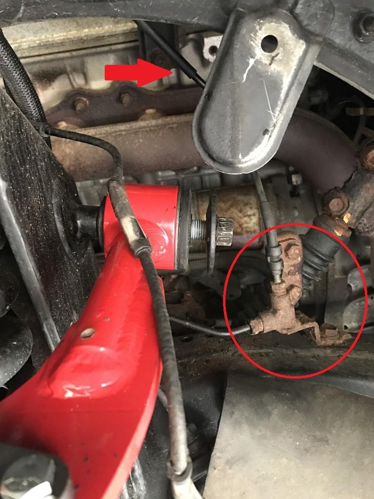

Does anyone have a list of the brake line part #s? I found some for the 3rd gen, but not any for the 4th. For most of the lines, you can probably make do with the AGS Poly Armour lines from Autozone. The line I'm looking for is the spiral shaped one that attaches right near the upper control arm nut, behind the splash guard. It looks similar to the one below in the eBay link and I pointed to it in the picture below I found from a UCA installation tutorial. I'm also surprised with all the UCA installation tutorials I've found that no one mentioned you'd have to remove the brake line attachment (circled), you do not have any room to get a socket on there if you don't. I was unable to do this because that bolt holding it to the frame was too rusted and rounded out, so I had to do it slow and use a 19 mm wrench. I did it as tight as possible, but I want to go back to torque it correctly if I can remove that brake line attachment out the way.

Part 47313 (flexible hose) and the lower hose looks like Part 47313A.
And the lower hose connects to this part (circled in diagram)
90412-10243 or 90412-10258

Thank you, I also ran into that diagram, but it was in the 3rd gen forum, didn't know it would also be the same for 4th gen.
