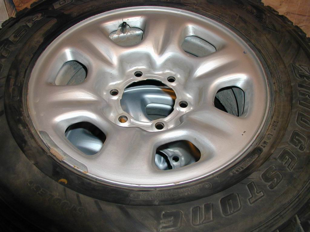

steel wheels
leftyrb,
Any chance of posting a closeup picture of the steel wheel so I can take it with me to my tire guy?
Photo attached.
Hope this helps. I got my rims from Kal Tire, who have stores across Western Canada.
