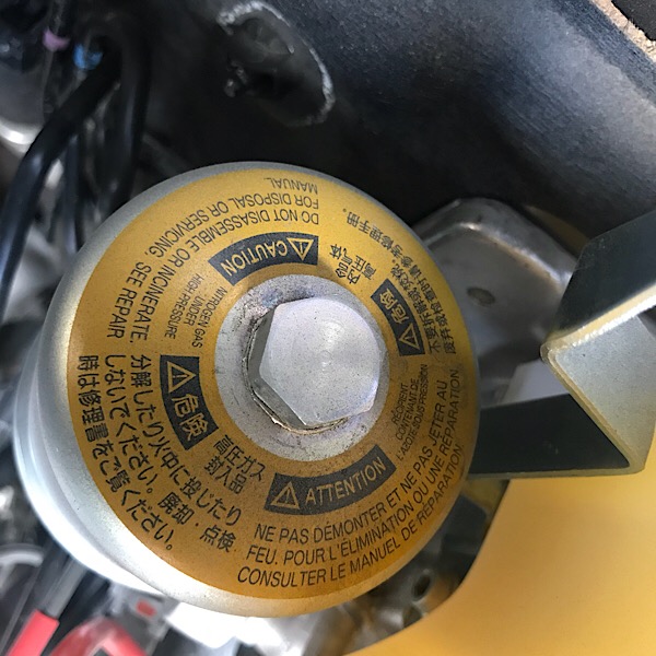

Never driven an Excursion so I can’t compare it to my current 4Runner. But I can tell you that the 4runner doesn’t have vacuum assist brakes or no brake booster. It does however have an electronic brake distribution module, I believe Toyota calls it a brake actuator. When you step on the brake pedal you’re actually at the mercy of a module that decides how much feedback to allow. They use a Nitrogen charged cylinder to simulate a hard or soft pedal based on inputs from various sensors and modules in the network. Just because you don’t have crawl control doesn’t mean the brake module isn’t capable of executing those functions. It just needs the right signal and on the SR5 there’s just no way for it to receive that signal. Unless someone at Toyota decides to change the algorithm for brake pedal feel it’s gonna stay the same. I hope this clears things up. Here’s a picture of the cylinder for reference.
