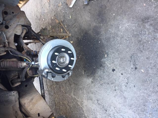

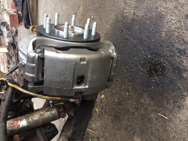

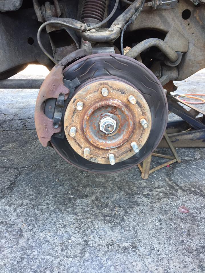

Lot of whining in this thread. You ain't experienced crap brakes until you drive a GMT 400 era Suburban. I have a '99 K2500 4wd Suburban w/ 6.5 diesel. Original front brakes were single piston caliper disc. Stopping power was horrible. TSB called for a new proportioning valve to increase pressure to rear brakes. Still not good. Stainless lines. Still not good. Finally went yard and did a conversion to the GMT 800 front discs with massive dual piston calipers and larger pads. Guys have seen 200+K out of these pads, compared to the 15K I'd see out of the stock pads. We have a second home at Big Bear Lake, CA in the San Bernardino mountains which is at 6,750'. So the truck sees a lot of work and although I try to use the engine as much as possible, the brakes get a workout.
The pictures tell the story. There is no comparing the stopping power to the old stock brakes. When I look at my wife's 2014 SR5 4Runner, its got nice 4 piston brake calipers, IIRC. Totally impressed with the 4Runner stopping power compared to old brakes on my Suburban. So stop your whining and trouble shoot and fix your brakes.
After conversion (first 2 pics) and before conversion (3rd pic). In the plans is a swap to a GMT 800 14 bolt full floater rear axle with disc brakes.
