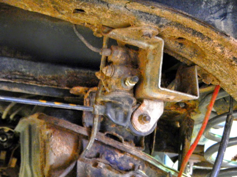

The doohickey above the rear axle is the Load Sensing Proportioning Valve. Not to ask stupid questions, but did you bleed it too?
What Kid said. I was having a soft brake problem with my 93 after doing a caliper fix. Bled the brakes, and still had soft pedal problem. Rebled the brakes, but this time also did the bleeder located just above the rear diff, and then the two rear brakes, and that did the trick. Damn valve holds air pockets really well.

No I didnt bleed the doohickey! I'll try tonight. The thing that has me so frustrated is that the pedal feels exactly like it did befor eht whole system was cleaned or replaced. I would think I would have a little better pedal. Can the doohickey go bad? could that have been my problem in the first place? Oh god, are there any rubber parts in the Doohickey?

Here's a picture of the bleeder valve. Do this one first before the two on the drums.
