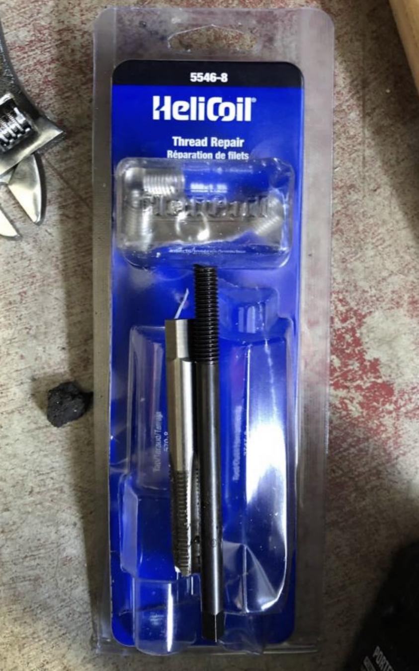

Pick up an M8 x 1.25 helicoil Kit, Tap wrench AND appropriate drill bit. I think it’s 21/64” but you will need to verify. Spent a weekend drilling out broken bolts and fixing the threads. Not fun. Only good news is the threads are now stronger than stock. USE EYE PROTECTION. Only thing worse than drilling out bolts is a corneal abrasion from drilling out bolts.
https://www.amazon.com/dp/B0002SREP4/ref=cm_sw_r_cp_api_i_7vU5Cb9XGCTHM

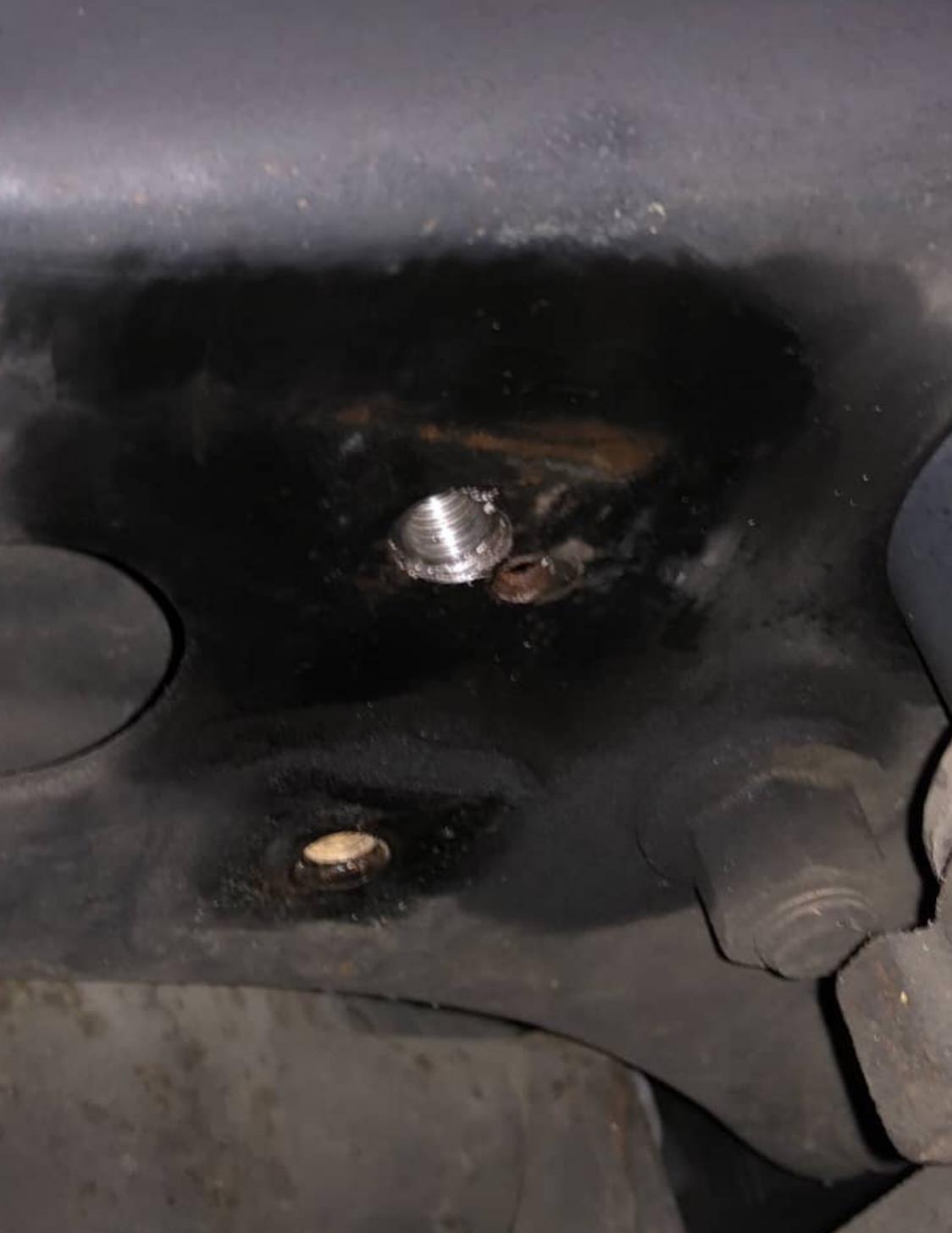

The welds broke on the nuts in the frame for the ones that are spinning. Grind the heads off or use a cut off wheel. Drill out the broken bolts. The metal is soft so a good drill but makes quick work of the job. Do not use an "easy out"! Once you drill out the bolts use a punch and hammer to bust the weldnuts off and install plus nuts or rivnuts. I used m8 rivnuts this past weekend and installed all new hardware.
