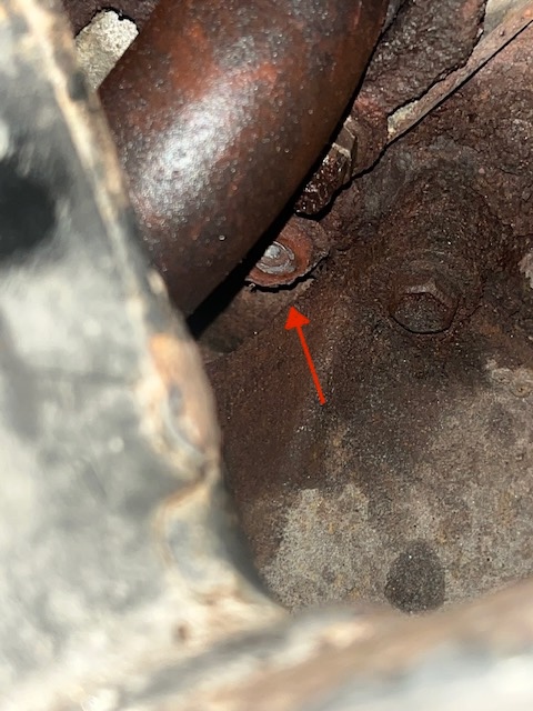

Early on in the process but I broke a passenger side, heat shield bolt. It's the hard one to get to - underside shield closest to the front.
Any ideas on what to do? See the pic.
I've never had to drill a bolt out of a head. And there's ZERO clearance. I got the other two out no issues. This one just snapped a 1/4 way out.

I presume you are keeping the manifolds?
So the manifold and block/head must stay undamaged too.
Since it broke part way out that means there may be good stock size threads deeper in that hole.
Can you say the whole problem can be resolved by getting the short broken bolt section out?
I’m replacing with oem manifolds.. I just started the job but since I’m replacing the UCAs and struts I thought this is the best time to tackle the manifolds too.
So the old manifolds will be out. Should I try to fix it then? The heat shield bolt was pretty small. Is this a good “easy out” candidate?
Thanks
It shouldn't really matter since you are replacing the manifolds. The heat shield is bolted to the manifold flange. Good luck with the manifold to block bolts, you think you have issues now.....:sobbing:
I agree with above, just get medieval with that heat shield and bend it out of the way to access the manifold bolt at the heads. Now, THOSE studs might give you a tad grief during the removal process so I'd soak them with PB blaster for a week before the project starts. It goes w/o saying to replace all nuts with brand new and if you feel adventurous, replace the studs too! Don't even think about reusing exhaust nuts or exhaust donut gaskets. :-)
DO NOT replace the manifold nuts and studs with stock parts. Stock parts will corrode within a couple of years and you are right back where you started, trying to remove the broken hardware through the wheel well. Go on here and find the correct stainless replacements. Learn from my mistakes please. I found studs and really nice self locking nuts (the second time around). You're welcome.....
Oh, did not realize that. Great news! Until I have to deal with the block studs, as you said :lmao:

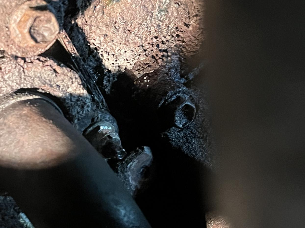

Now, my first big issue…
I got through the entire passenger side minus one!! The freaking bottom stud closet to the front. Damn. I used heat, pb multiple times many days in advance, more heat. Nothing! Now a it’s stripped, my bolt grabber has shredded it so I’m sizing down to a 13mm cause I can’t get a bite anymore. Help!!! I feel the despair lol. I spent 3 hours and every angle I could think of. Impact, long levered breaker bar, nothing!! This nut is evil incarnate.
Side note, what’s the word on heat? I’m torching just the nut and stud but what’s the risk to the head? I’ve heated that stuff 5 times now for about 1-2 mins each time.

I would return the stock hardware, don't use it, there isn't much to a stud other than tensile strength. My stainless hardware has been just fine for 4 years already AND I'll be able to remove it with no issues. How long have you been in one wheel well? For the stripped nut you will need to weld a nut on top of that one. Weld through the hole in the extra nut penetrating into the stud then try to get at least one weld around one flat, or more if you have the room, it will need the extra weld strength when applying torque (ask me how many nuts I welded on before using that method.) I have been in the exact same position as you are in now. I had one stud break off in the block flush (seriously not good) I just left it like that until I had more time to spend in the wheel wheel (isn't it fun!). i bolted the manifold on and ran it for about a year like that with no leaky issues at all. When I finally was ready to dive back in I used the empty hole on the manifold as a drill guide with a bushing inside that hole to make up the difference. IT WORKED, the hole was on center and I stepped up to the correct drill size for a M10 stud and tapped it. Robert is your fathers brother....Or just do what you want either way......

Jesus! I can't even imagine. That's insane - I truly hope it doesn't come to that.
I read that welding should not be done. That type of heat will warp the aluminum head...
It will be fine. Dodge mechanics do it all the time thanks to their tiny exhaust bolts that easily snap. The heat from the weld will break up whatever is holding it in. They usually come right out.
This type of heat is very localized and the head is made of ALUM so it'll dissipate heat very quickly. Sorry about the nightmare you're encountering, unfortunately, this is too typical for exhaust hardware. The lack of space makes this project a true PITA.
If this was me, I might think about using rounded off nut extractor like this one from HFhttps://www.harborfreight.com/38-in-drive-metric-bolt-extractor-socket-set-9-piece-59855.html?gQT=1
I like this one better, I think: https://shop.advanceautoparts.com/p...l&store=8261&adtype=pla&gStoreCode=8261&gQT=1
You need something you can hammer on, then loosen with a ratchet. Of course, keep applying heat until the last moment!!!

I acutally just bought the extractor set you put in the first link. It's the Lisle one but same deal. The extractor I was using now is this one....
Amazon.com
I have no idea if the Lisle one will be better, but my 14mm seems like its not gripping. I tried sizing down to a 13mm but cant get any bite, polus the stud may be hitting the end since its a shallow socket? Ugh! The space is really a PITA. I'm going from underneath the vehicle, through the space where the inner tie rod goes through. This seems to be the straightest angle I can get.
Yes, I've been trying to heat as much as possible but I cant get the extractor on straight and hard enough without a hammer! Any ideas. I have tried extensions but I cant get it hammered with that angle and all this takes too long and stuff starts cooling off. lol. This is brutal.
I have a lot more to go so I'll move on for the time being, but man, what a true PITA. Is last resort pull the engine?

Dude - what a royal PITA this project is, i feel for ya! If you can get a Dremel with a cutoff wheel in there, just cut the whole thing off as close to the manifold as you can.
Another idea is to get a hotter flame source, so perhaps try using MAPP gas? Get that thing cherry red and maybe use a deeper extractor set? I'm spitballing here!!
Those are good ideas. I’ll wait till the Lisle set arrives and go with much longer heat. Get it REAL hot as you said. I did notice though that the hotter I get it the bolt seems to start crumbling away. Can anyone verify the attack angle they took? My extractor is 3/8 inch and my impact air gun with extensions are 1/2 inch. I can’t use a 22m socket over it because my half inch swivel won’t clear the tubing right about it. The through the bottom route doesn’t seem to give me enough leverage. This is such a ridiculous spot lol.
