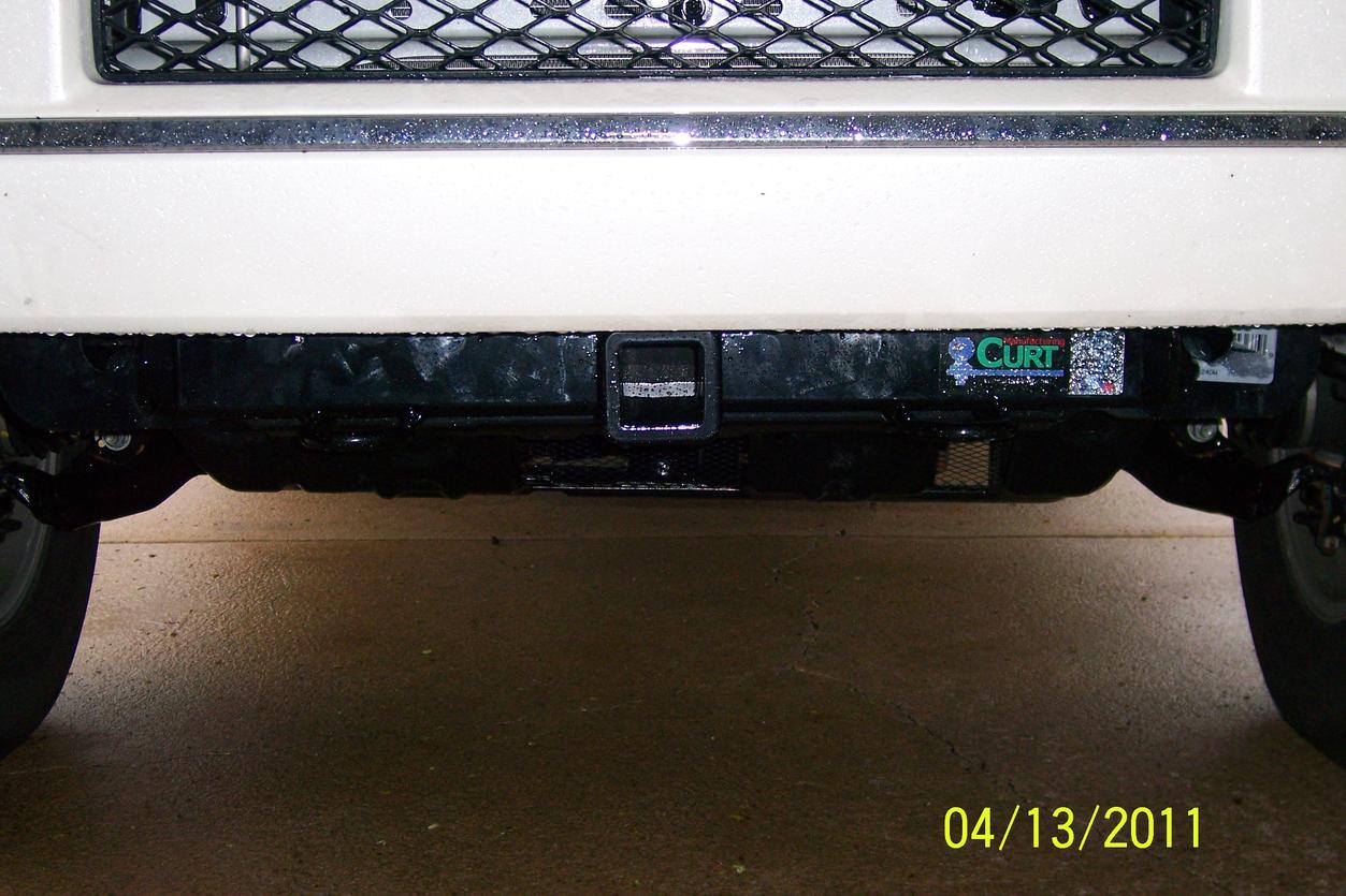

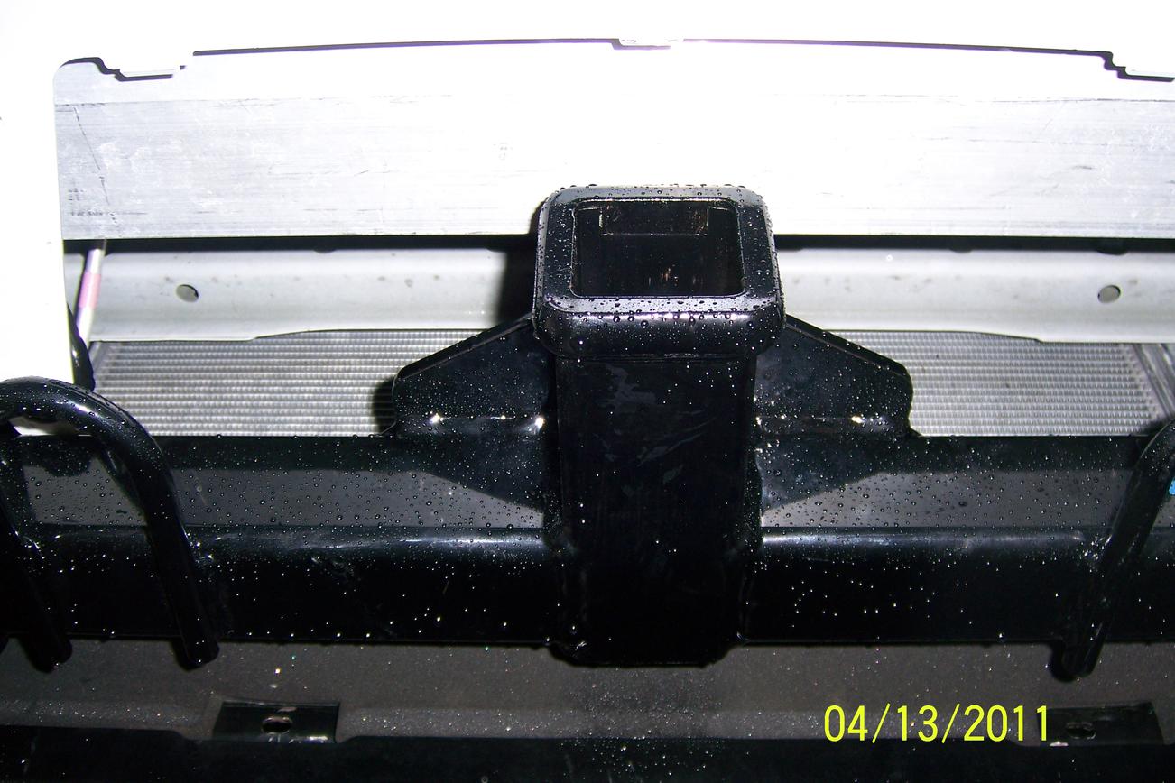

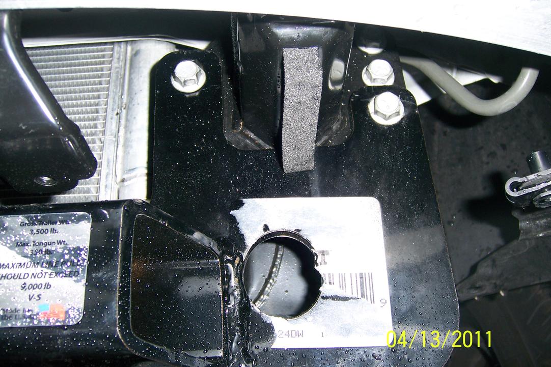

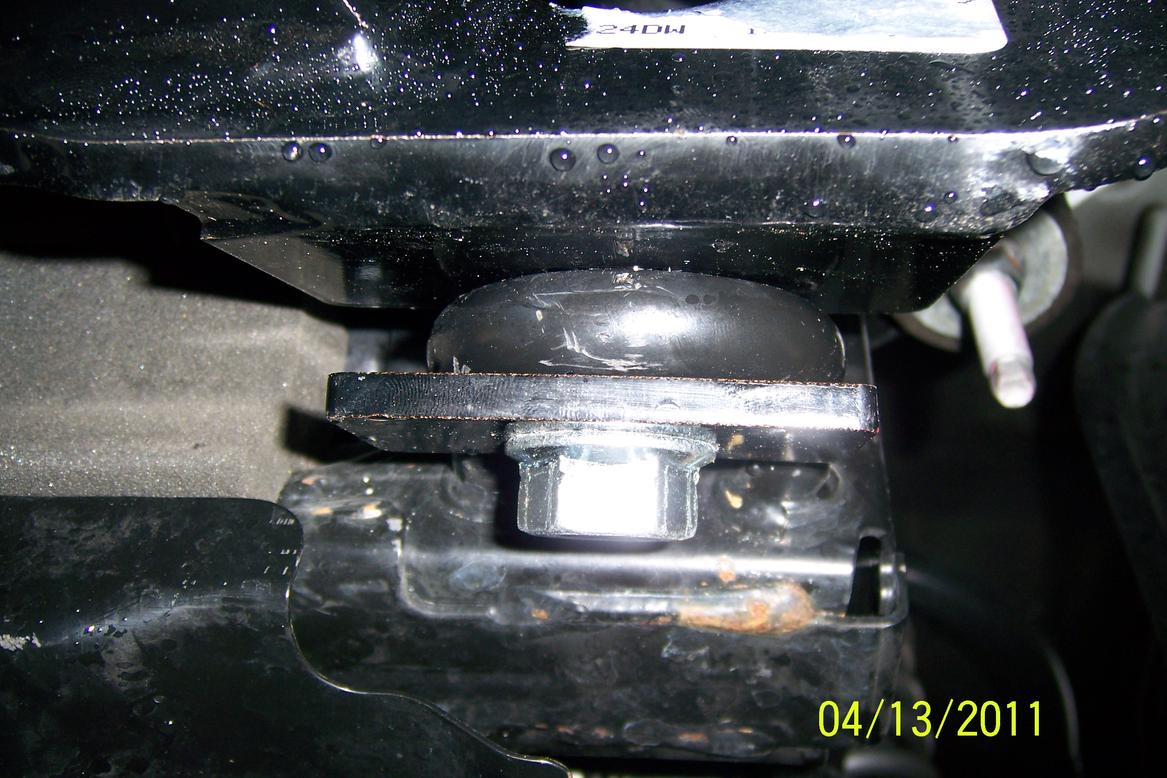

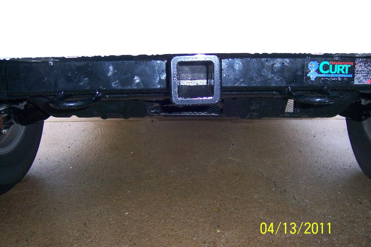

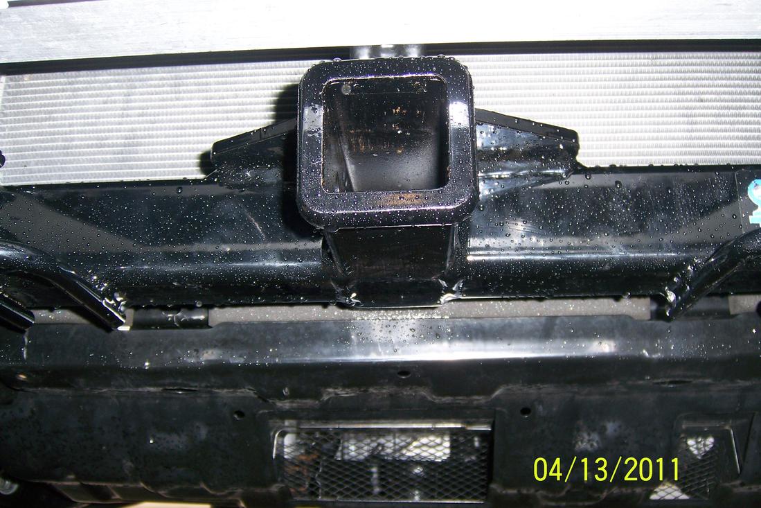

I see that it picks up 4 of the 8 front frame bolts to attach it.Where does it come out the front?Below the bumper? Pics would be nice!
Sorry but this is my first time putting pictures up. Not sure how to make the pictures smaller. Not good on the PC.
The hitch is about 3 3/4 inches back under the bumper.
This is were the hitch mounts to the bumper. Two bolts hold it to the bumper.
This picture is where the hitch also mounts to the front tow hooks.

I wonder how CURT Manufacturing, Inc. arrives at the Vertical load/Gross trailer weight specs for their Front Receiver 31367. Their website shows 500 lbs/5,000 lbs while the photograph posted by sandfish shows 350 lbs/3,500 lbs—a capacity decrease of 30 percent.
