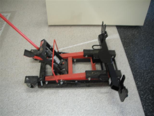

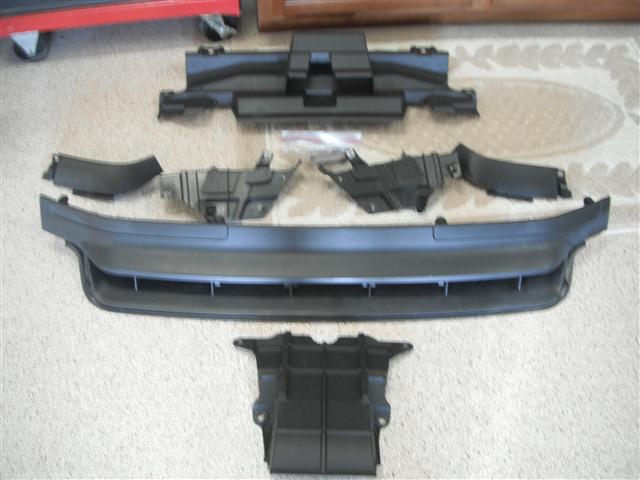

Building on what Brockeverly said, it took a lot longer that I thought it would just to get the "air dam" off. See all the parts below. There must have been at least 25 hex nuts, etc and some came off, then had to back on etc etc. What a PIA. The jack you see below is a 3ton Motorcycle/ATV jack that I've had for many years. Very handy. Using this, it was a breeze to place the receiver into position.

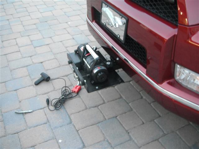

The last photo shows the whole purpose for me going through all this. Just so I can use my winch in front when needed. I need a life......
Anybody want to by a slightly used "Air Dam"? Installation instruction are NOT INCLUDED. Be safe.

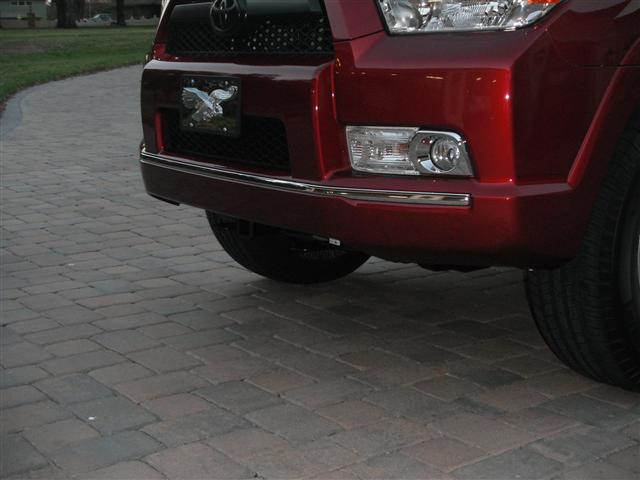

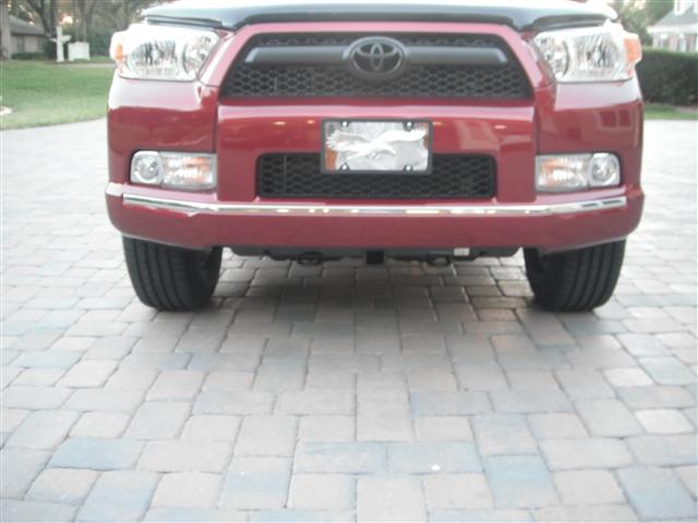

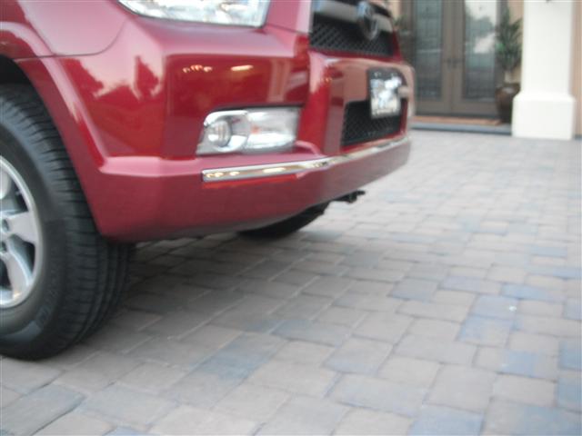

Sorry for the wait guys. Here are some photos with the hitch mounted.
After taking it up a few big embankments out here I have determined that I have lost nothing when it comes to approach angle. The front bumper would hit before the hitch would.

That winch is well over 15 years old, and no longer made by WARN. It is a lighter duty winch, 3500lbs, of course that is doubled with a snatch block. It has served me well over the years for what I use it for. I think I have only used it once to get me out of a jam, multiple time pulling vehicles out of ditches on the side of the road and many of "stumps" from various properties I have owned. I went on WARN web site and the closest thing I found that resembles mine is linked below. Good luck, be safe.
