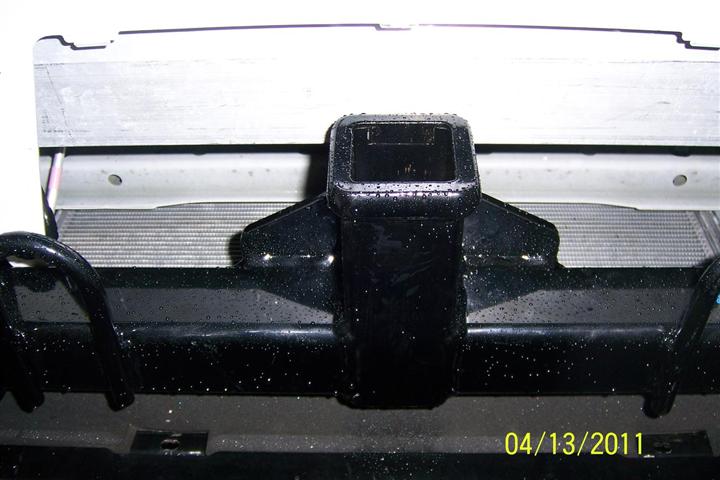

Got it installed today. I would recommend two people for this install unless you have a lot of stamina. Holding a hitch up while trying to align the holes and get it into place is easier said than done. I did this myself as my wife was about as useful as a set of nipples on a bull.
A couple tips, attach the outermost bolts first or they will not pull into the area correctly. This is a tight fit to say the least. You will feel like it doesn't fit, it will. A 1/2" drive ratchet will make the job much easier as these are some fairly large bolts. If you are ordering this, take the front air dam off first or you will probably get really pissed trying to finish this job. When ordering this, you might as well order a hitch extension because a standard ball hitch will not clear the bumper, my hitch rack also would not clear.
Only photo for now, I will get some better ones later.

any chance you could snap a few quick shots closer to the mounting/bolts area?
I will tomorrow when the sun is back up. I will also get some better shots from the front. There were none that I was looking for when searching this product so I will try to be thorough.

Here are a couple more photos for you guys searching.
3" from the end of the receiver to the edge of the bumper.
17 3/4" from the ground to the bottom of the receiver. This sits far enough back that I still have more approach angle than if just the air dam was on.
The bolts used to hold the hitch on. Notice that the holes are a bit larger. I will be getting some washers for them before I actually put any weight on the hitch, I am not sure why Curt did not provide them. I was in slacks so I did not climb under to get a photo of where this connects to the tie down hooks. Those are very stout bolts so I doubt that not having washers would affect anything.
