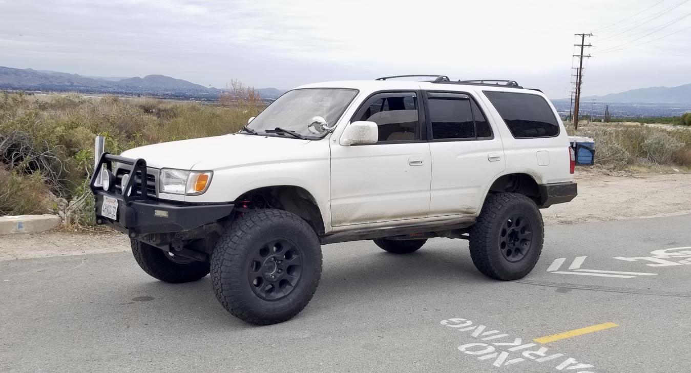

Put my new Boss/Toytec Aluma 2.0 coilovers in today! Man they ride wonderful and sit just right from the factory. Hoping they don’t settle too much cuz they’re pretty level with my 861s in the back. If so, I still have room to adjust them up a bit.

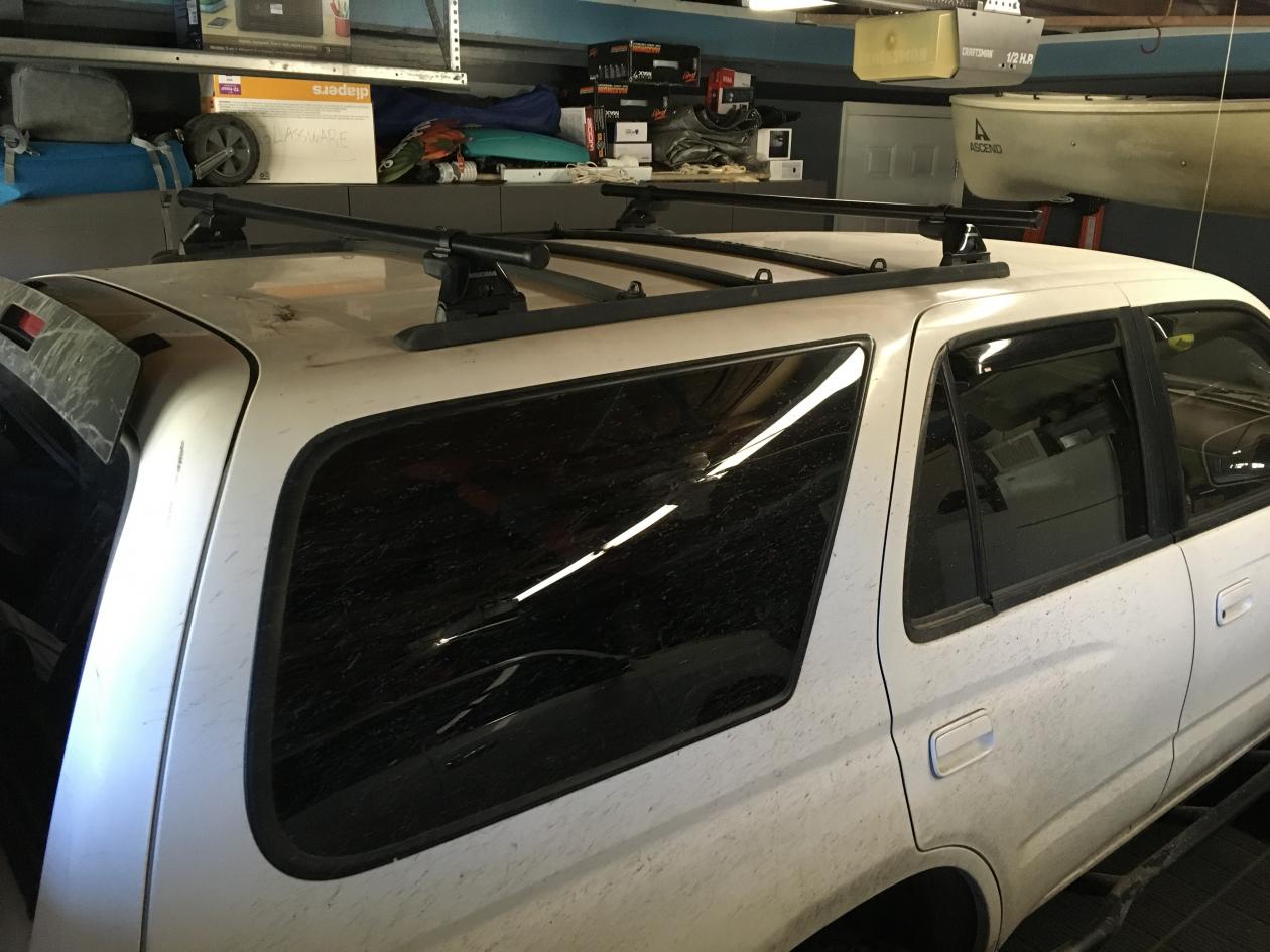

After 20 years of strapping my kayaks to my factory roof rack, I finally upgraded to a new rack. I went with a Yakima Skyline with the 48” round bars. I plan to get an ARB awning soon to mount to it also.

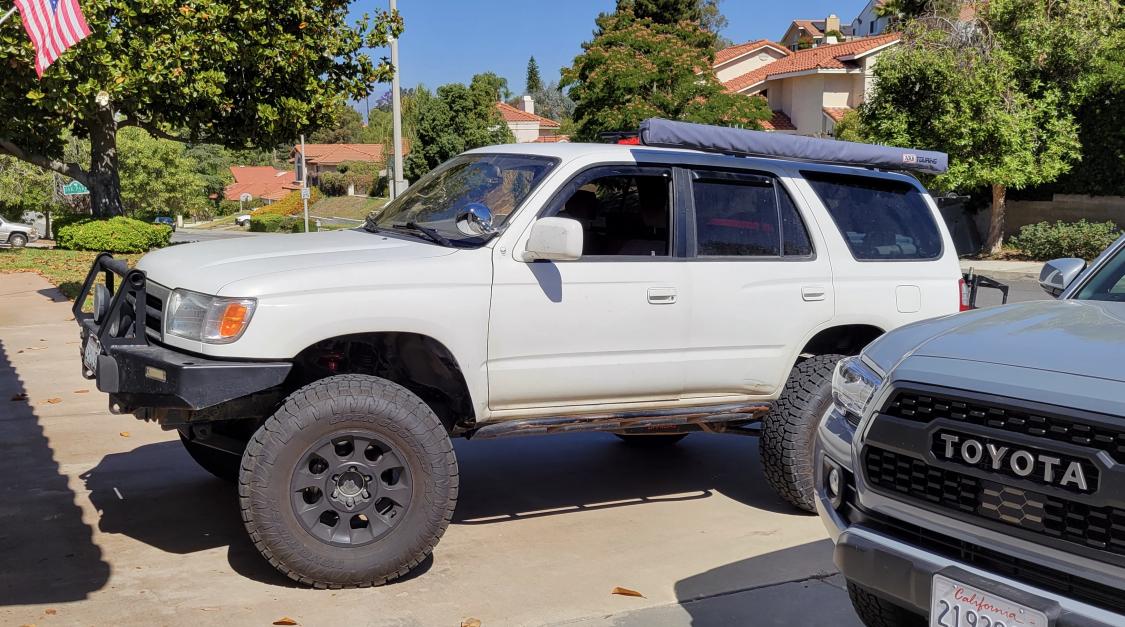

Another little update... I got the Yakima rack a few months ago because my factory rack had finally broken after almost 25 years. I also wanted a means to mount an awning. I really didn’t want a basket on the roof because the Yakima bars work better for strapping my kayak to than a basket (and I don’t want to store a lot of stuff on my roof anyways since it makes the truck easier to tip). I got around to installing the awning last week...
