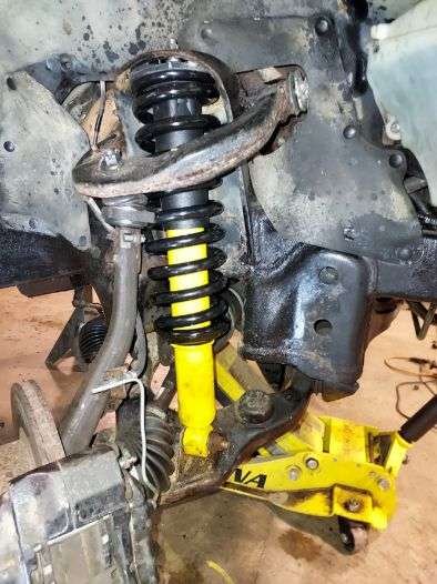

The suspension all in the 1997 limited. The Rear control arms all have poly bushings in. Except the lateral control arm. The emergency brake cable finally came in so it's installed as well. It goes for an inspection Tommorrow and alignment later this week. About 98% complete. The interior plastic needs put back in and the back seat yet. Along with the rear rubber mat etc. :)
Sent from my SM-A505U using Tapatalk
Before and after of the front suspension.
