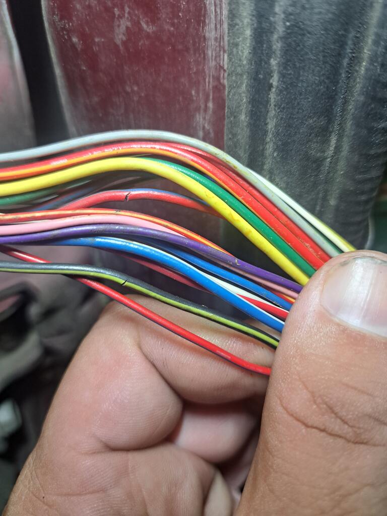

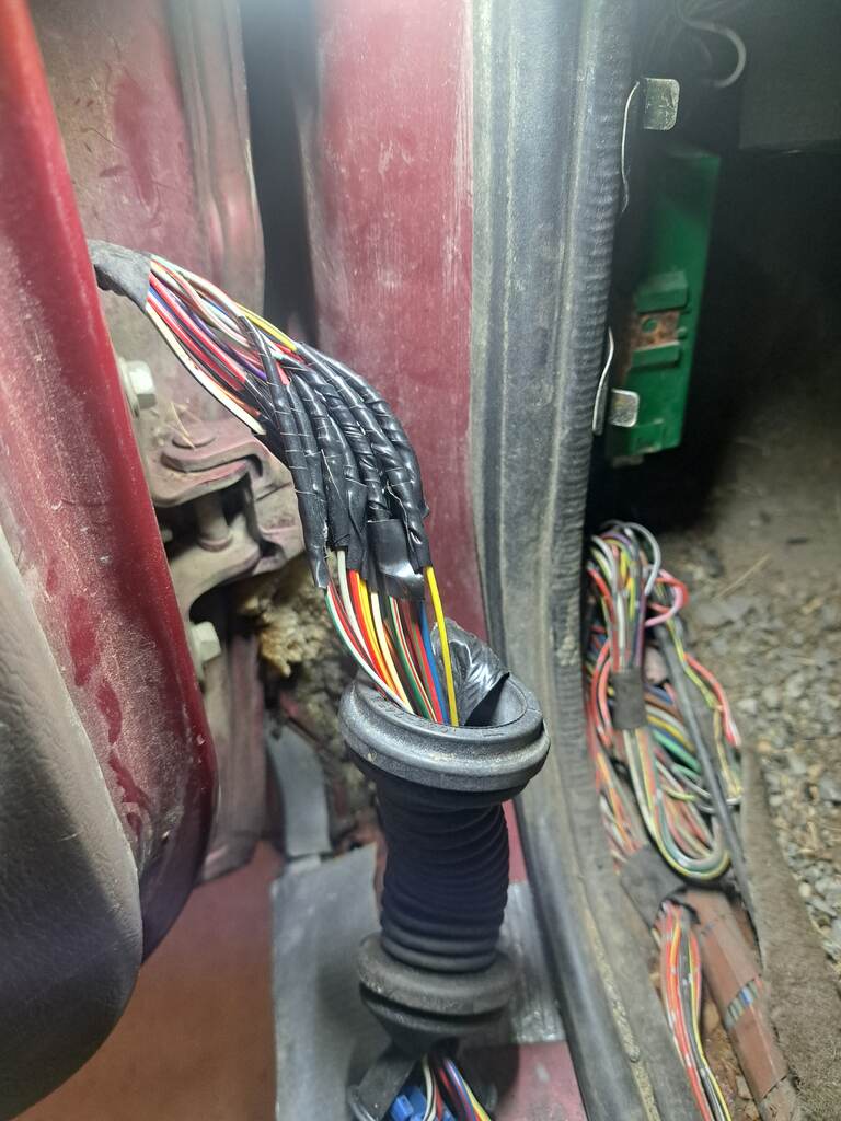

Well Shit box (1997 limited) lost its dash lights the other day. First I was thinking maybe the dimmer bit the dust. Then I realized its the Tail circuit and no longer have parking lights as well. So When I changed the blown fuse it snapped again instantly... So now I know I have a dead short somewhere. Realizing that circuit has lights in the hatch as well as the driver front door. I figured I would start in the drivers door As I was in the hatch a year or so ago repairing wires. So I unplugged the door and put another fuse in... Bingo everything worked and the fuse didn't blow. Upon inspection of the wires a few had cracked insulation. So I wrapped them all in electrical tape and put it back together. :-) Should be good for another 267K miles. :-)
