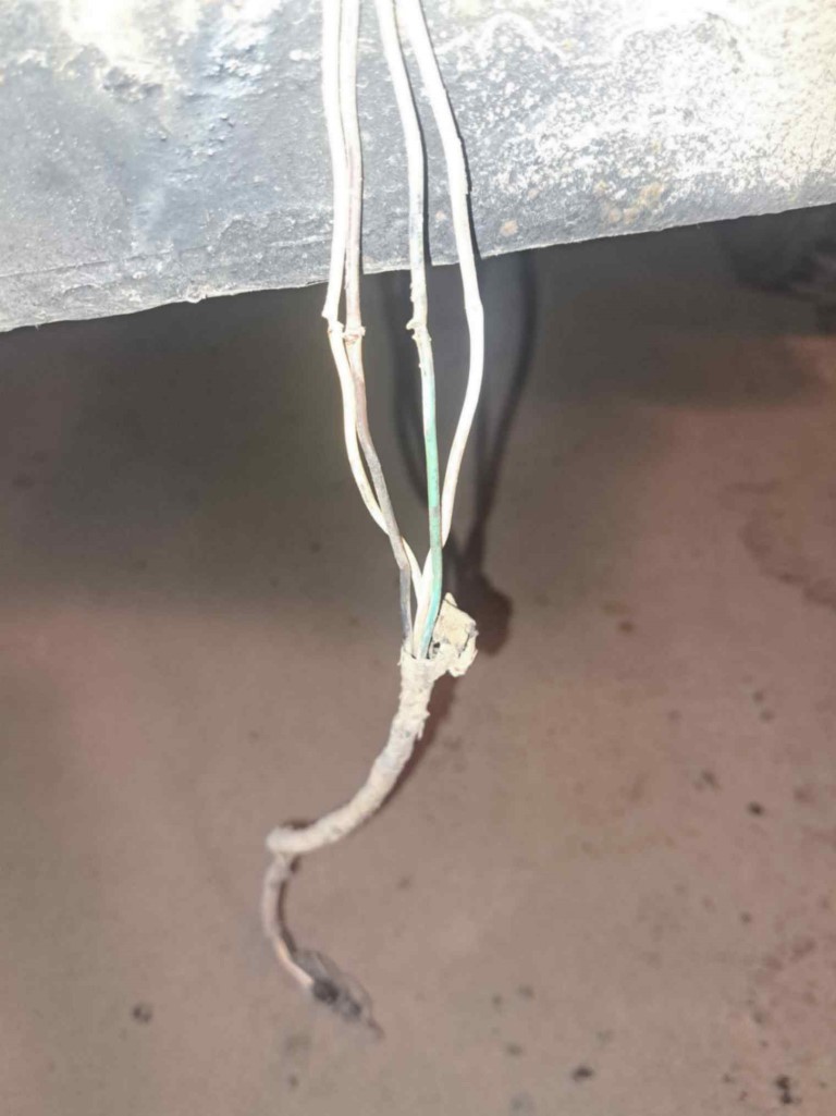

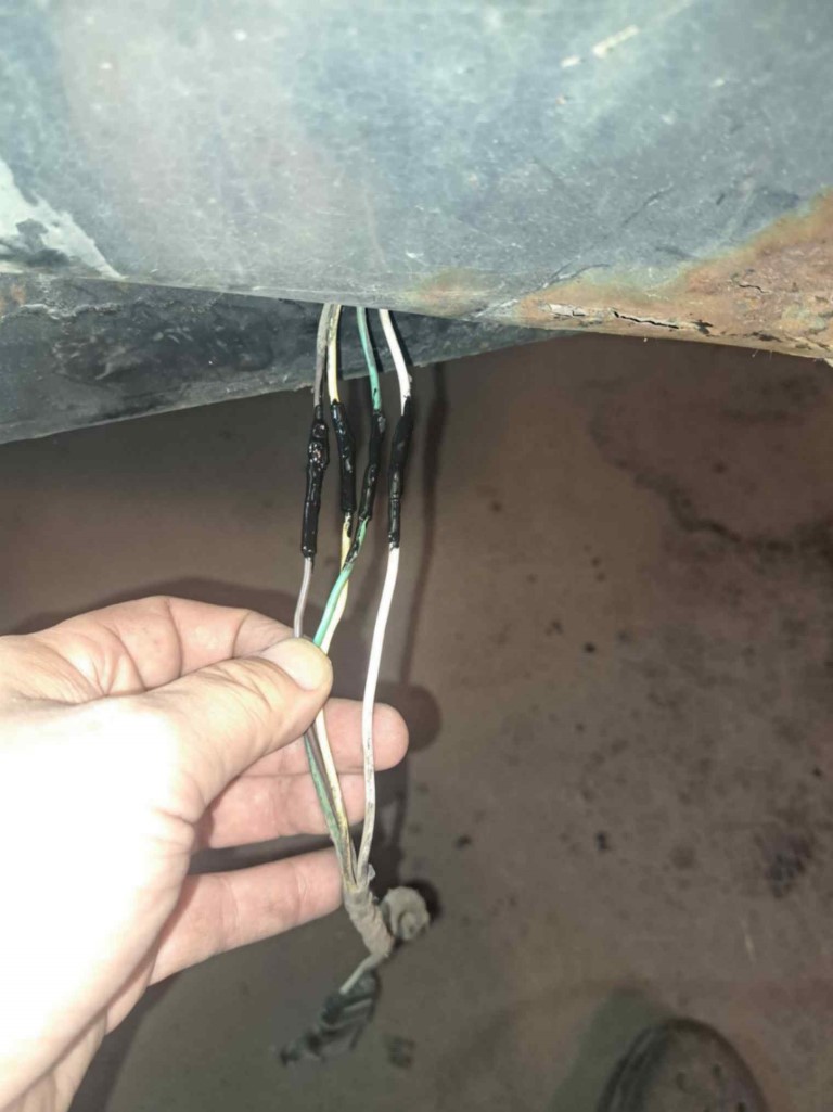

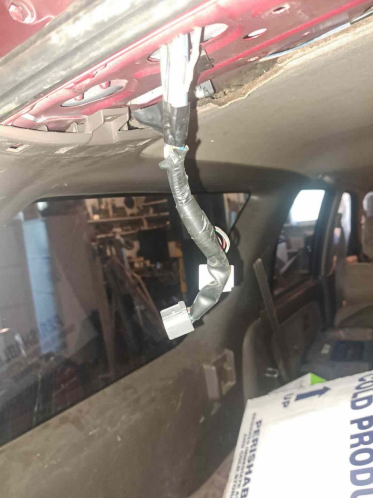

Well I finally had time to work on the tail light circuit. I unplugged the immobilizer...Still blew fuse. Unplug the rear hatch still blew fuse. So now I am looking at the trailer hitch wiring and the converter box.... Well there it be, my wires got pitched when my bumper don't dinged. I didn't look there because it blow the fuses a few weeks later.. But that was the issue.. I do have it all tapped up now too again..:-)

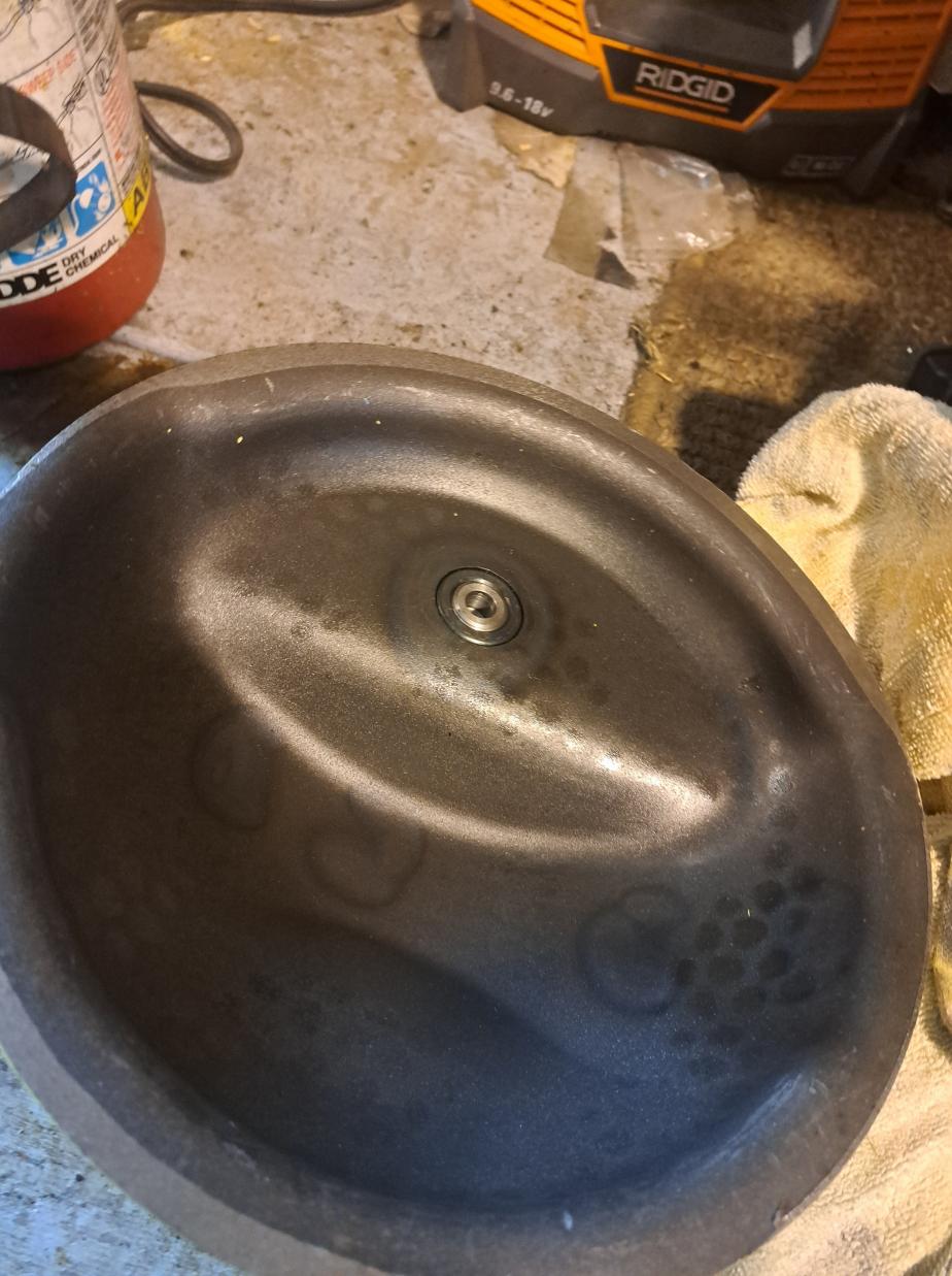

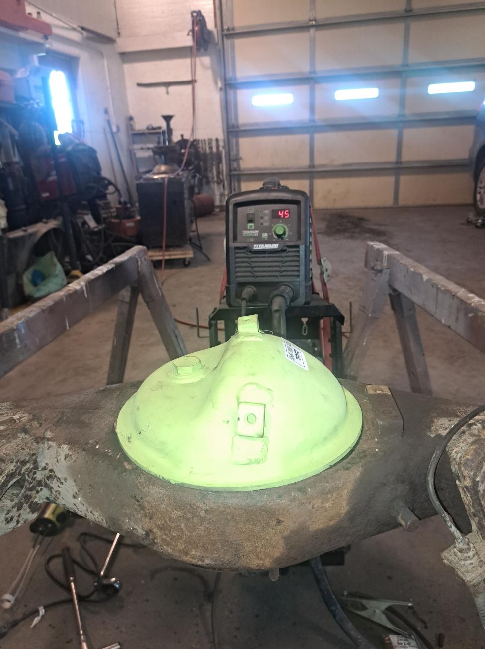

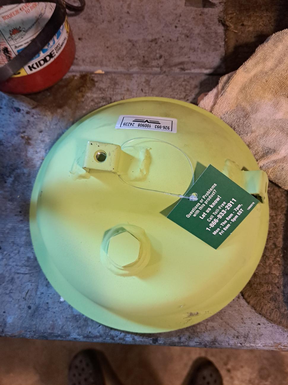

Wow, looks like I haven't did any updates on the thread for a while. I have since then snagged 2 complete frames.. I am currently repairing a rear axle housing so it no longer leaks with a dorman back plate weld in cover and just fluid filmed the 2nd roller frame chassis for storage. I have to upload photos later of these.
Glad to see you still plugging a long. Mine's doing great, no real updates just driving. I am planning to take it to a local car show Saturday night.
Alright, you only redo axle housing that are not extremely rotted or brackets cracking from rust etc. That would just be a waste of resources and time. This housing only had 2 pinholes in the back plate it was off a 2001. So it was a great candidate for a replacement back plate. Dorman makes a very decent significantly replacement back plate. So I figured, why not redo one as I have a 1998 5 speed winter 5 speed that housing was not only thin on the back plate but the side was rotting through as well.
