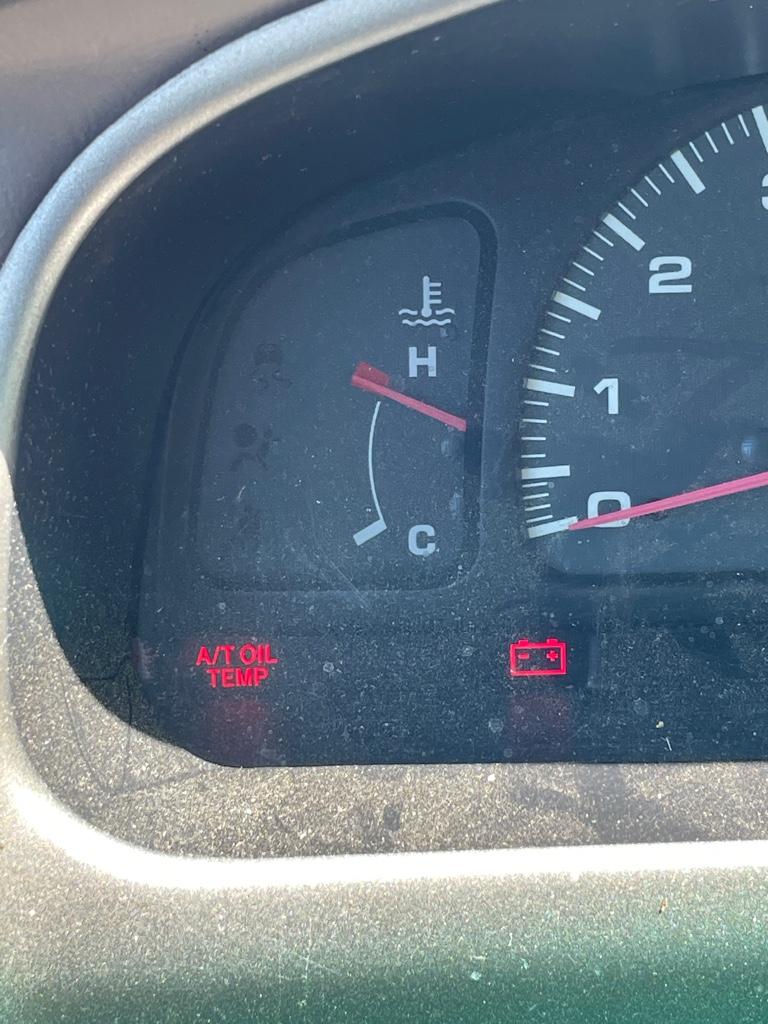

Noticed temp was a little high then moved into the red immediately pulled over and shut off. Sat for a while and tried to start, crank no start. A/T light on too. Oil is clean and full, no water or steam spewing. Really bummed and wonder what the hell happened. Had it towed to buddies ship and hoping for good news in the am. Could it just be water pump is my only thought ?

Well it started and runs no problem. Looks like it was either the radiator or water pump and initially no other problems. Going for all new parts including timing belt. Oh also drain and fill the oil and transmission fluid. Fingers crossed
So big thumbs up for transmission cooler saved me from a pink milkshake. The whole bottom of the radiator was rusted out, which was strange because it’s only 10 years old and water pump fried. Up late last night doing the timing belt and accessory‘s back on the road today can’t tell you how relieved I am.
