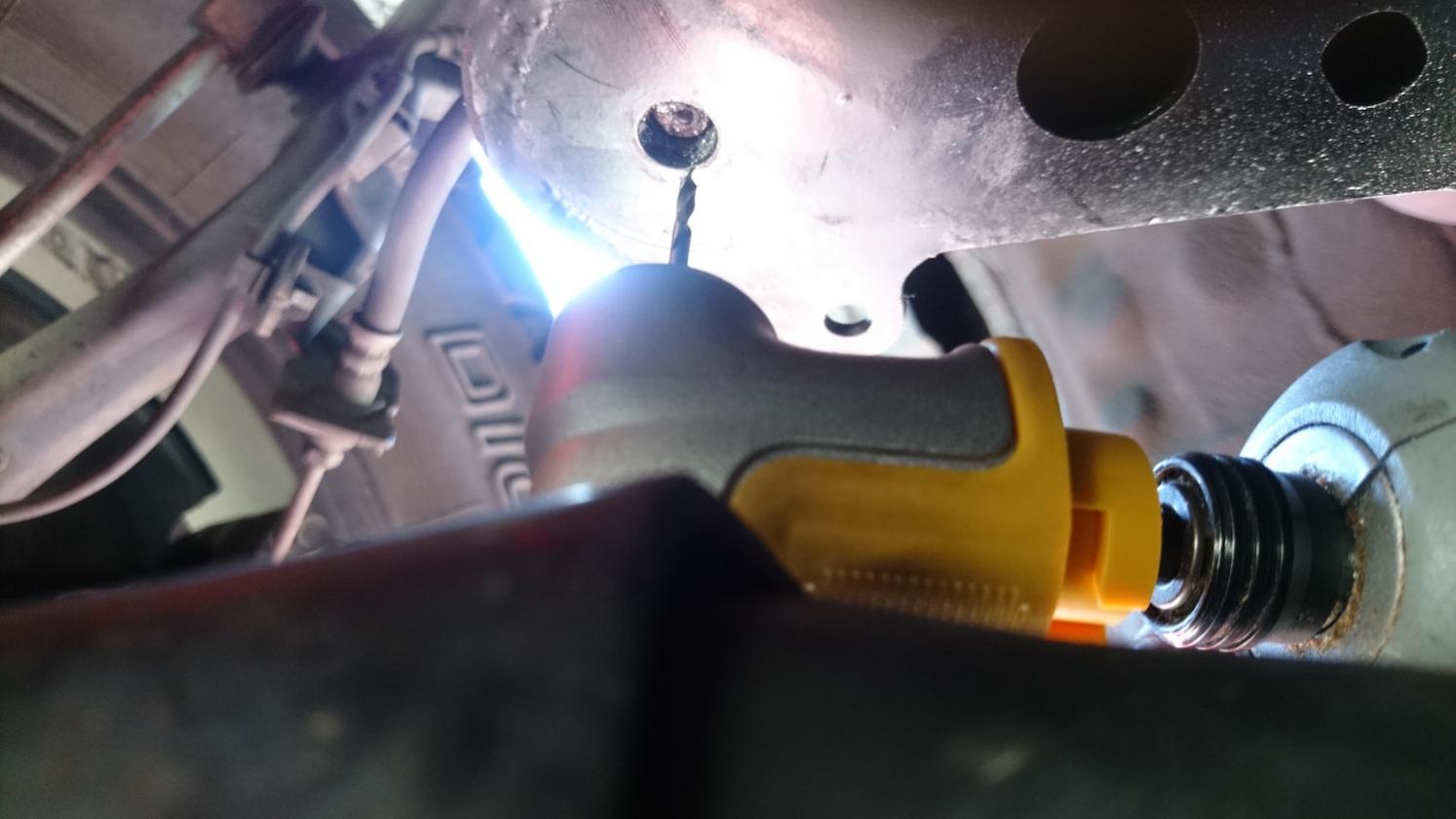

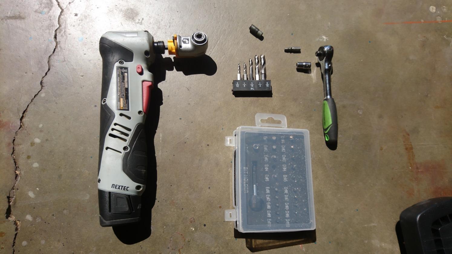

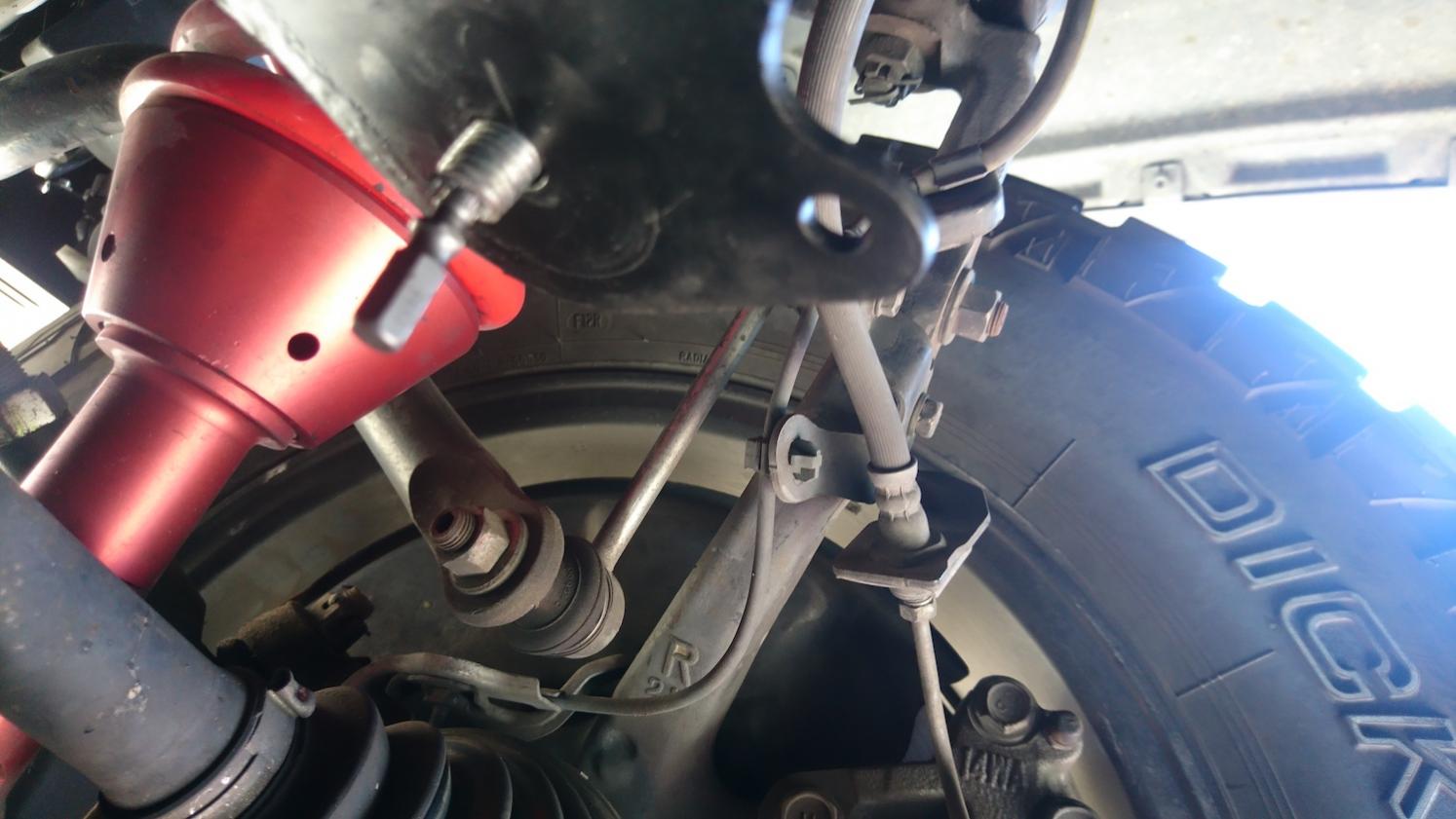

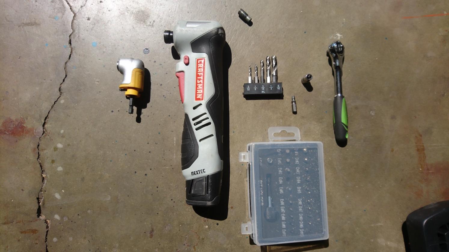

Managed to get the broken bump stop bolt out
First off many thanks to you all for great ideas and suggestions.
I managed to get it out today from the bottom by using compact 90 degrees drill attachment and stubby drill bits and bolt extractors. I did not have to disconnect anything.
Attaching a few photos of the job and tools I used. May be somebody who runs into this in the future will find it useful.
Here are the main things that helped
1) Compact Screw extractor set
2) Stubby drill bits
3) The compact 90 degree drill attachment
4) PB Blaster/Kroil. I let the thing soak for couple of days before i had the time to get to it.
Cheers and thanks again!

Nice job, glad you were able to extract it without too much difficulty !
Looks like your process made it come out with ease, dropped it right out of the bottom.
Also, correct tools for the job.
Can you link the drill?
Seems like that particular drill is not available anymore. I bought this quite a few years ago. But any small pistol grip drill/driver should be just fine. In fact this particular one is a single speed drill. Probably not the best.
Here is a page I found on it. Craftsman Nextec 9-17562 Right Angle Impact Driver Review
It is an impact driver. So that helps a bit with speeding up the hole and preventing the bit jumping around since it is impossible to use a centering punch on the bolt at that angle, which I tried. But if the sheared face is almost flat like mine was, it is probably not a big deal.
