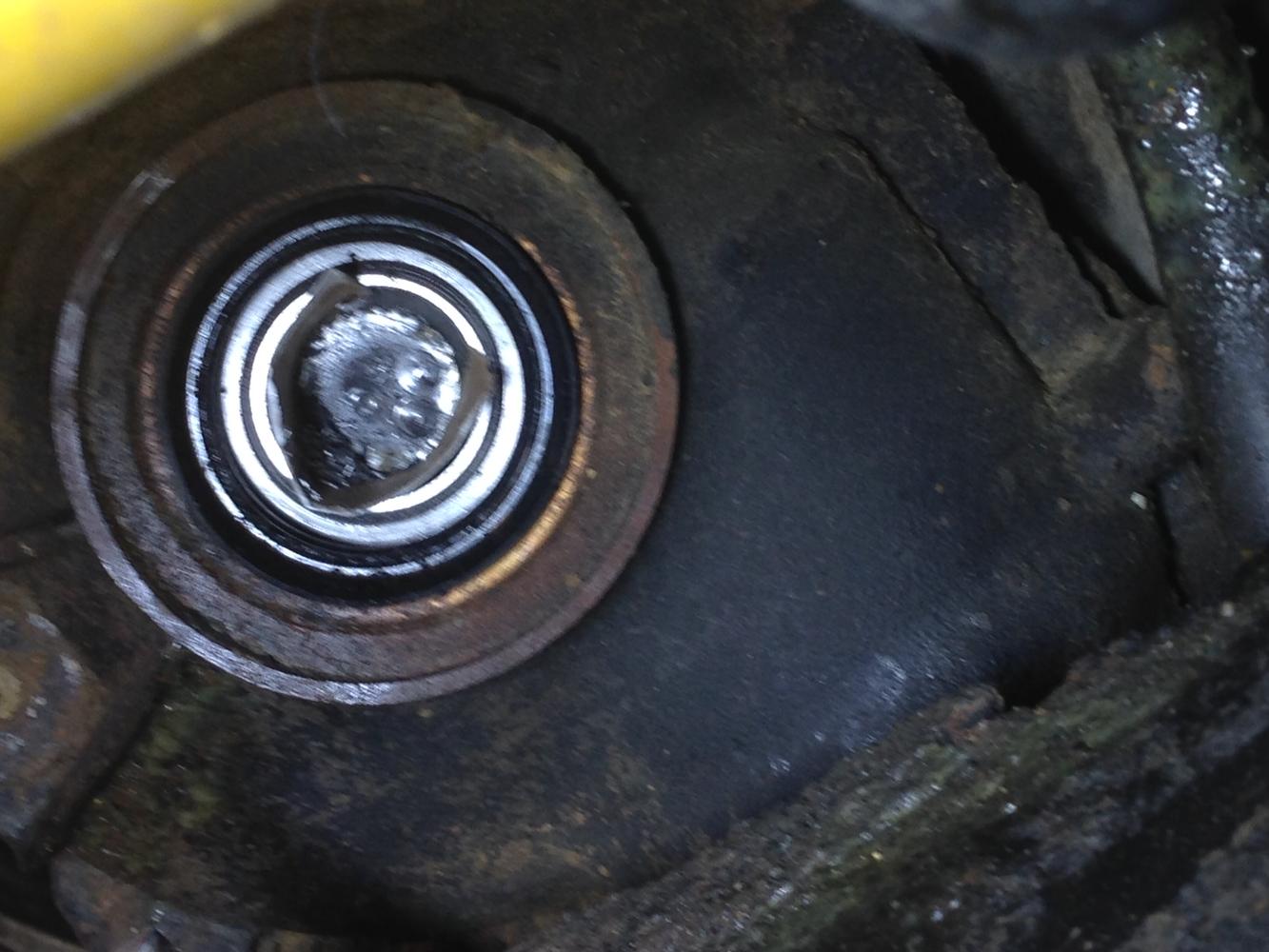

How do you get the broken part of the cv shaft out of the front differential? It snapped fully insides front diff and I have know clue how to get it out. Thanks for the help.

I've read about others having the same issue. If I remember correctly, they drilled and tapped the end of the axle, screwed in a bolt, and pulled it out. Sounds like a major pain. What brand axle was this?

Hmmm that is a pain. But they are the stock toyota axels actually!

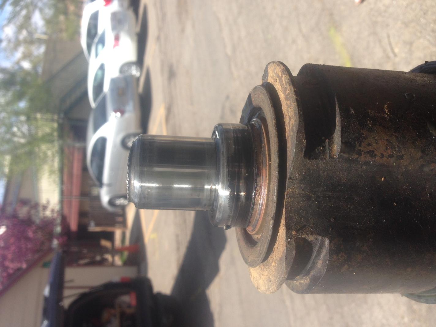

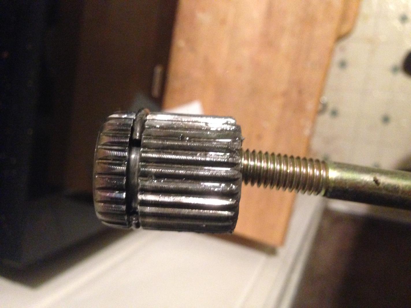

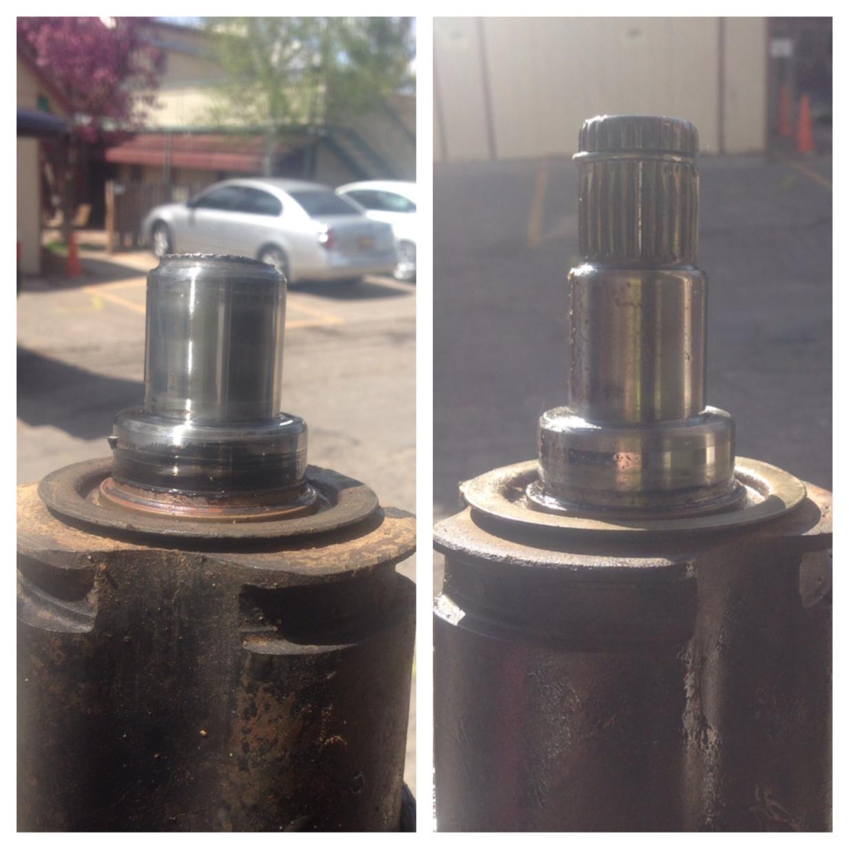

I just want to give a big shout out to TBuzz for all the help today helping me drill and tap the little part of my cv axel out of my front differential. Long day I really hope to never snap a cv inside the front differential ever again!!!

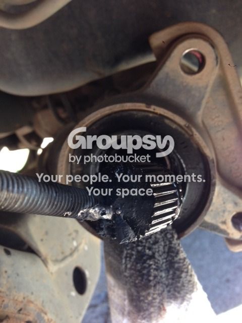

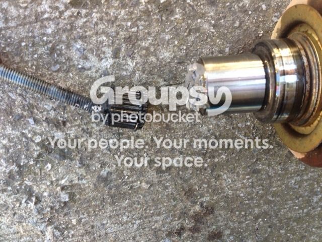

Thread Resurrection to add my experience.
Thanks to the OP and to Sniv for suggesting the weld method.
So. Was pulling a stump (from bottom of a little bush) with the 4runner. Hooked up the winch to the stump and yanked. No go.
Pulled on it with the 4runner in 4lo. No go.
Gave a pretty hard tug, snapped the 8K synthetic winch line (as it was hooked back on itself around the stump). I had the protective cordura sheath on it, but I think the metal hook just cut through it and the winch line.
Hooked up a tow strap around the stump (little bush) and attached to front shackles on bumper. Pull softly, no go.
Give a yank, spinning tires a bit, no go.
Try again, snapped passenger side CV axle.
Took it apart this morning. CV axle was busted off inside the diff tube.

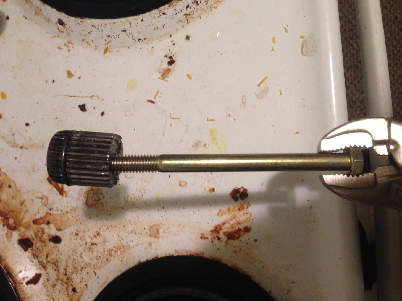

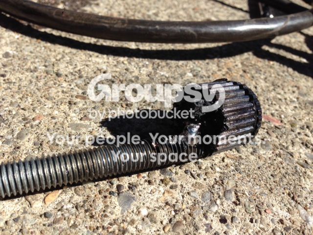

I welded an eye bolt to the broken off piece, inside the diff tube (at least an inch or two deep).
Yanked it out and replaced with new CV joint! BTW, this was NAPA gold CV that broke and it was replaced with an O'reilly Master Pro. (I know, should never gave up my OEMs for core, live and learn). Just not ready to step up to Lotus of CVJ yet.
Definitely feel like a dumbass for breaking my shit, but got some redemption with the awesome extraction!
Enjoy the pics.
