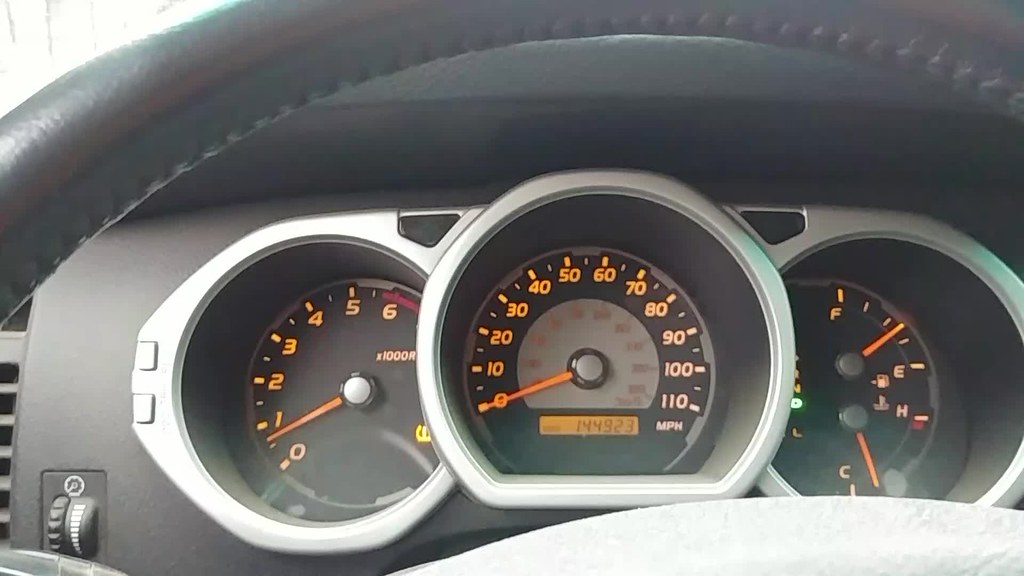

Alright guys, what do you think?
Been noticing an occasional popping noise when backing up and turning the wheel to the left out of my parking spot at work. Pretty sure it's the front left CV. OEM CV w/150k miles and wheeled a bit.
Yesterday I backed up and turned the wheel to the right. Heard a consistent pop pop pop, more than the usual.
Today I noticed while idling slowly through a parking lot and up to 10mph it's popping very consistently.
Good news is that I have 2 freshly built CV's ready to be installed once I press out the ball joints on the LCA's I'm installing at the same time.
Click on the picture to load the video. Not sure how to imbed Flickr video if somebody knows please tell me.
Well after changing the LCA's, CV's, and wheel bearings the other day I haven't heard this noise again. Problem solved for now.
