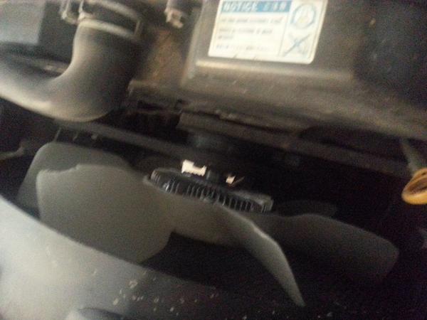

2 of the fan blades look like they came in contact with something, what would of caused this?
I guess I'll check my motor mounts.
I honestly don't know how long its been like that, i did drive around for awhile without a skid plate.
Did you have an accessory belt break and not notice it when you replace it maybe? I had a belt break before and on its way out break a few fan blades.
Interesting…Then I would start by checking all your nuts and bolts and make sure the fan isn't wiggling and make sure nothing surrounding it isn't loose and possibly making contact. Keep us posted on what you find/don't find.
Have you been out wheeling and made any water crossings or playing in any deep mud holes? I've broken a plastic fan during a water crossing before...just a thought?!?
Anyway...here's a good opportunity to replace your mechanical fan with an electric one. This will prevent this from happening again...plus save some horsepower maybe a bit better fuel mileage...
Good luck and keep us apprised of what you find.
Oops...I feel like a jack-nut! Sorry I didn't read everything before I posted. I just noticed you live in Las Vagas. Probably not too many river crossings or mud holes for play in...lol!!!
Couldn't find any nuts or bolts missing.
Not much mud or river crossing here until the monsoon season.
I had a flexalite fan system on my 3.0 v6 pickup, it seamed like it would overheat easy, and didn't notice any power gain.
