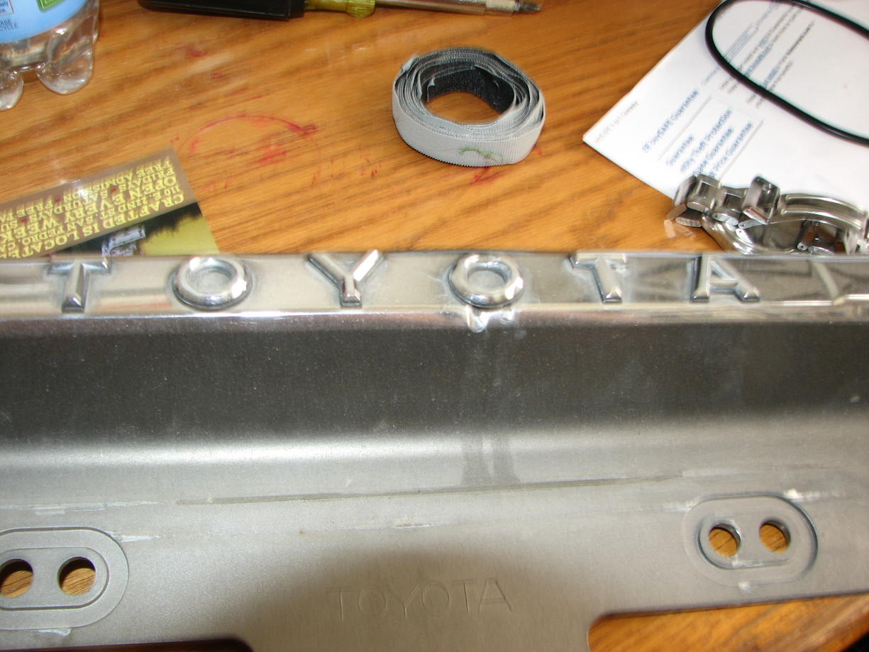

When I bought my 94, one of the letters above the licence plate was broken off (I have seen that this is a pretty common problem). It was the second T, so it read "TOYO A". Today I took out the second O and the A off so it reads "TOY".
I am wondering if there is an easy way to get the broken pieces out incase I want to put on new letters later on.

On my 4runner the plate behind has three little holes where letters clip into. When you try and take them off they break and the little clips are left inside.
Bad pic, but you should get the idea.

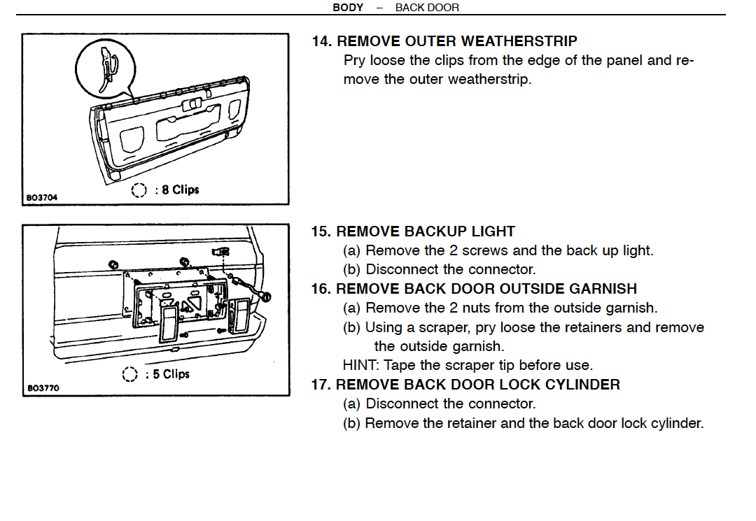

Looking through the FSM, your pictures of what is left of the clips for each letter and the garnish piece, it appears that you would have to remove the garnish from inside. You might be able to pull each letter off and push what is left of the clips into the tailgate with a punch but then you are left without any lettering at all. I guess a custom sticker in it's place may not be a bad option.
In the event you buy a new garnish or pick one up from one of the used suppliers, the link below will provide you with the procedures for removing the garnish.
https://www.dropbox.com/s/6azfu48z5jgl0wr/backdoor.pdf
