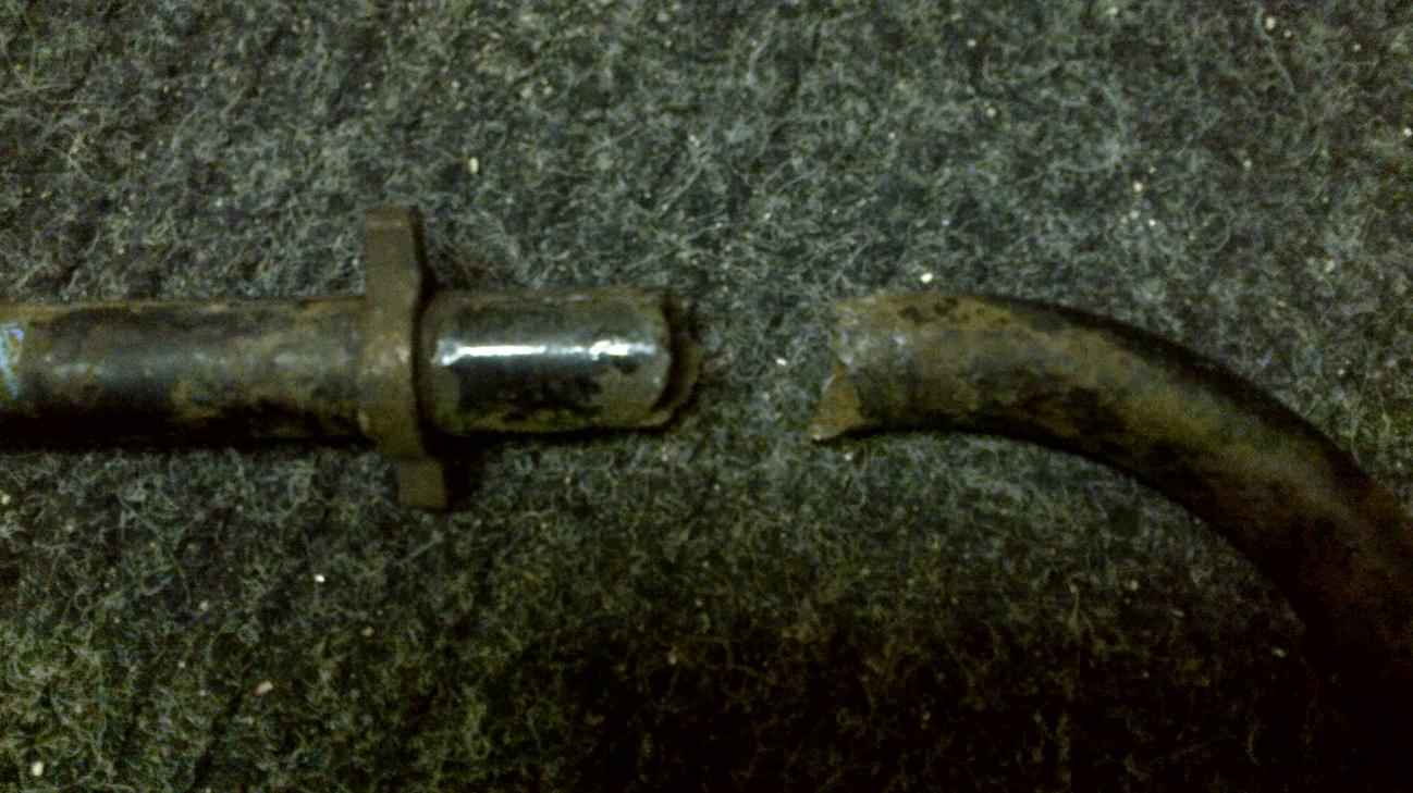

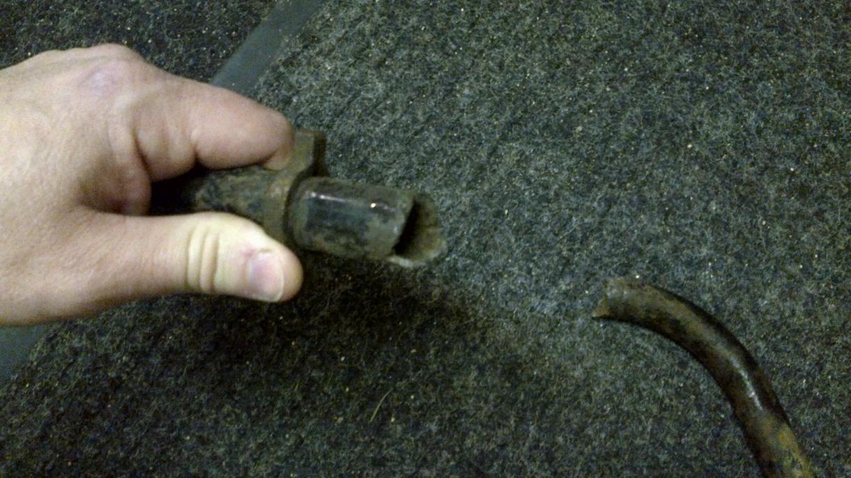

Ripped out the sway bar today. As I suspected it had rusted underneath the bushing. Oh well. I think I am going to buy the addco sway bar. I called my local wrecker, they wanted 100 bucks. Then I called toyota, they wanted 325 bucks. I laughed at the parts guy and I told I guess I am going after market. Does any one know if the addco rear sway bar kit come with endlinks as well? Thanks guys.
The rear addco does not come with endlinks, but new bushings for them. I have my old oem rear sway if you want it. However I would highly recommend the addco. Also i would get the front upgraded at the same time. Any pics of the carnage.
Here are some pics. I was pretty shocked in how thin the bar is. I got pretty mad trying to get the bar out that I cut the rest of the bar out. I hope it's easier to get the bar back in.

addco purchased
Just purchased the addco bar from summit. Seemed to be a good price 160 bucks. Andy's a few more bucks. I'll check the front sway bar for condition, and if its ok I'll order bushing and links. I need to order links for the back any ways. Cheers everyone
