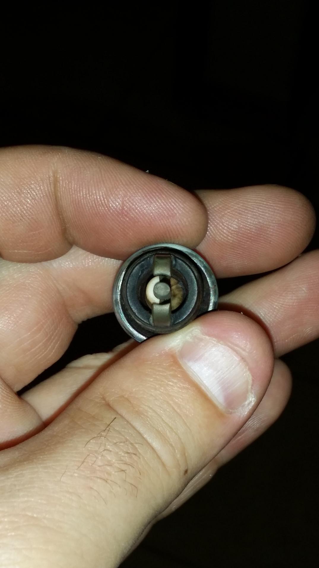

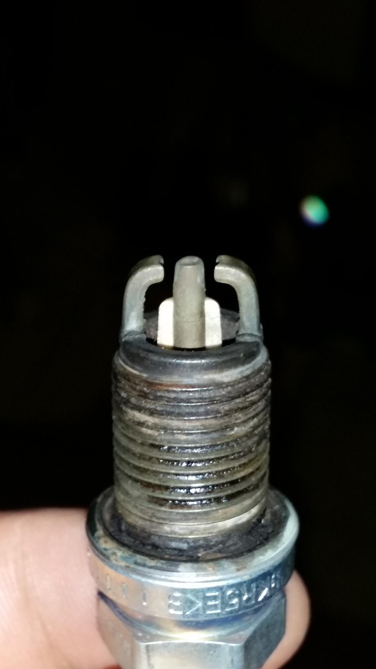

I have now had two plugs break on me. The porcelain park is what is going to hell. I have had a Denso and a NGK do this with in the last 4 months. Thoughts other than they are now junk?

Not be a dick but I'm so careful when putting plugs in this thing and I just sung them and that is it( not loose but not retched the hell out of it). I'm not that guy who cranks the hell out of them. I know that if you cross thread them you F^&$ED in a big way. I get what you are saying though. I just thought they might have been dropped before I got them. Thoughts on that? I'm really at a loss at this point.

I'll post a pic.

Anyway, if they aren't being overtightened, then I'd consider the plug socket itself or technique as the culprit. If they have been dropped prior to installation, the fractures in the porcelain will be visible upon close inspection.

No signs of blistering on the porcelain, or melted electrodes. It's not showing signs of excessive heat.

It pays to put one's contacts in before looking at pics on T4R. Yep, definitely not heat.
