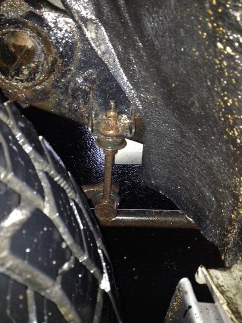

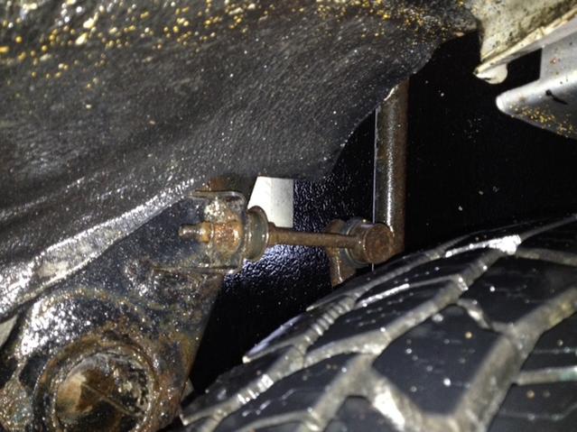

Hello all, can you guys tell me what this is called and is it something I can get and install it myself ? It popped out on me when I drove over a small ditch while hunting yesterday.

Sway bar end link. They are around $20 each. Yes, you can install it yourself. Get you some PB Blaster and spray it down before you try to remove it. From the looks of the surface rust, you will need it.
Thanks, i figured I could since I was able to snap it back in there, how can I check the other side to see if it needs one also ?

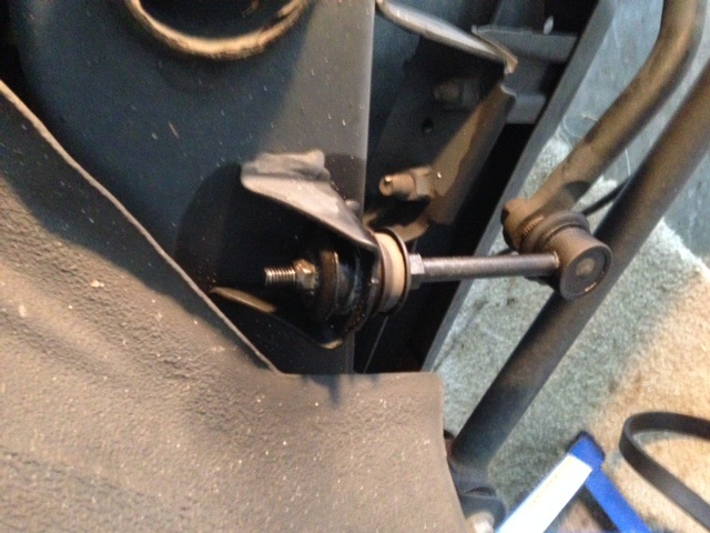

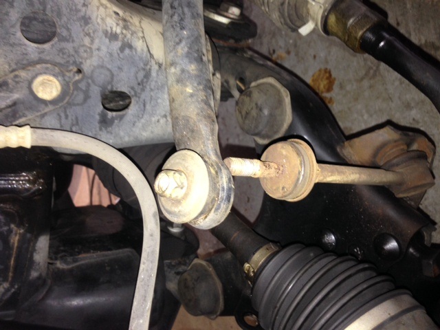

I just did all four of my end links this past weekend and mine lookekd better than yours. I was originally just putting in poly bushings but once I disconnected the end links I found the rod (inside the rubber bushings) were mostly wasted away. From the looks of your especially if that is the back I would replace all 4 and put some poly bushings in.
The 2 photos are one of the back and the other was the front all deteriated.

Thanks for the pics, do I need to torqe theses down or just crank them tight ?
Yes there are torque specs for both the upper 12mm nut I think it is 16in lbs and the bottom 14mm nut is 47ft lbs. You better look them up since I don't have my books with me.
Also you need a second wrench on the inside of the flange when tightening the lower nut other wise it just turns, its not a nut on the inside its more like a washer with flat sides to keep the joint from rotating while you are tightening the nut.

My front ones looked fine until I removed them. This corrosion was hiding beneath the bushings.

I'm thinking his joint where it attaches to the sway bar was worn so badly that it just separated. Then he was able to push the ball part of the joint back into the socket.
it came off from the frame, when i went over a ditch the back wheel must have dropped down because i heard a loud pop
I went back and zoomed in on the picture. I see what you are talking about now. It looks like the big washer on top corroded to the point where it broke off when you got it in a bind and it slipped out of the hole.
