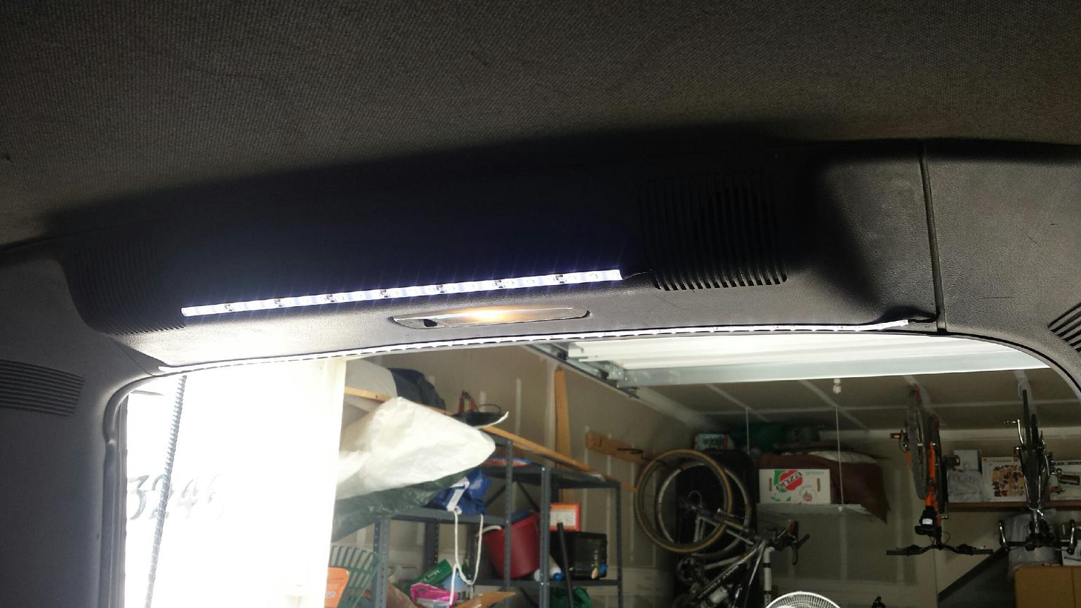

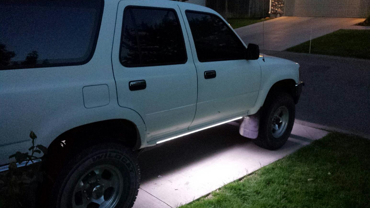

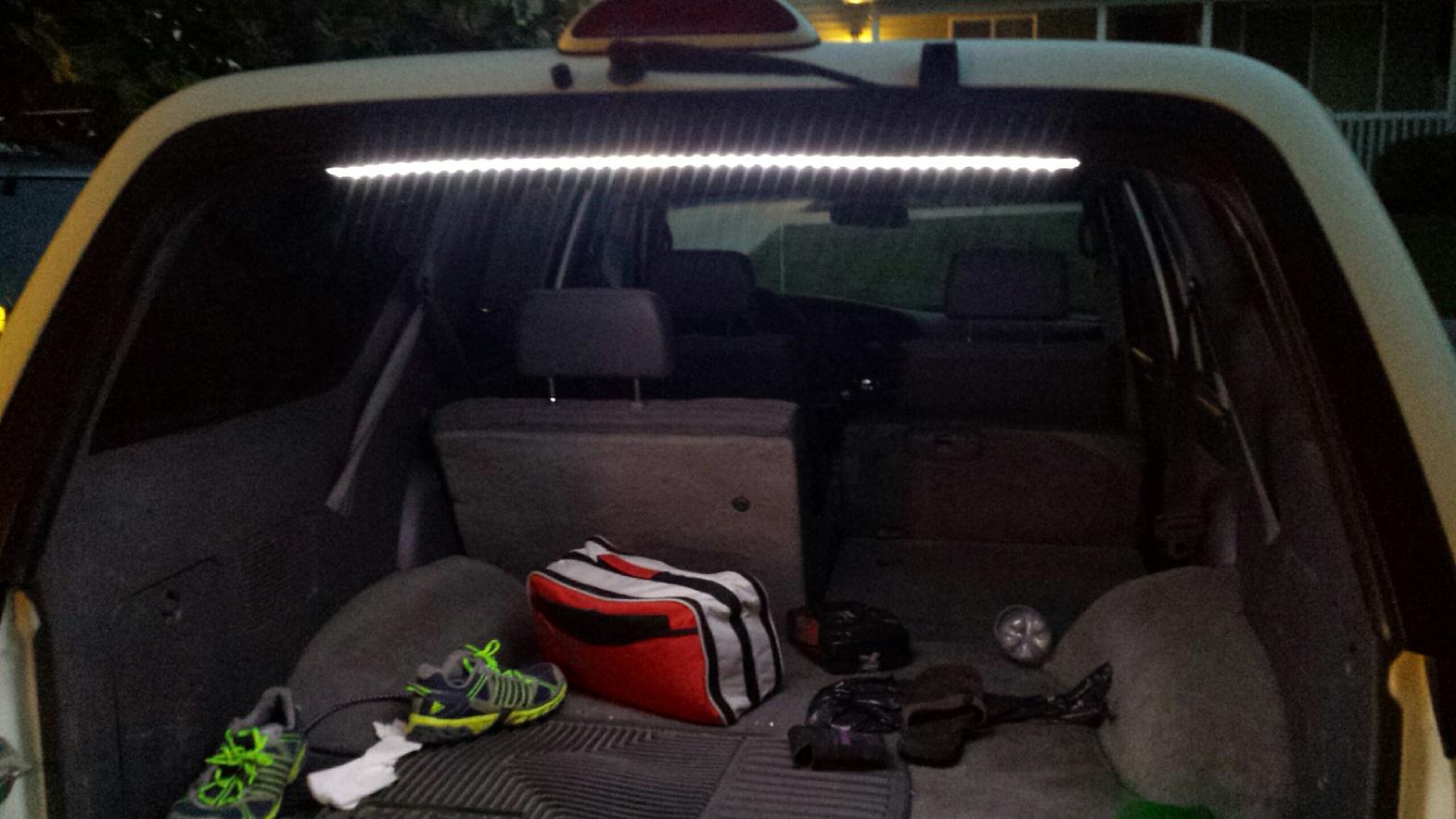

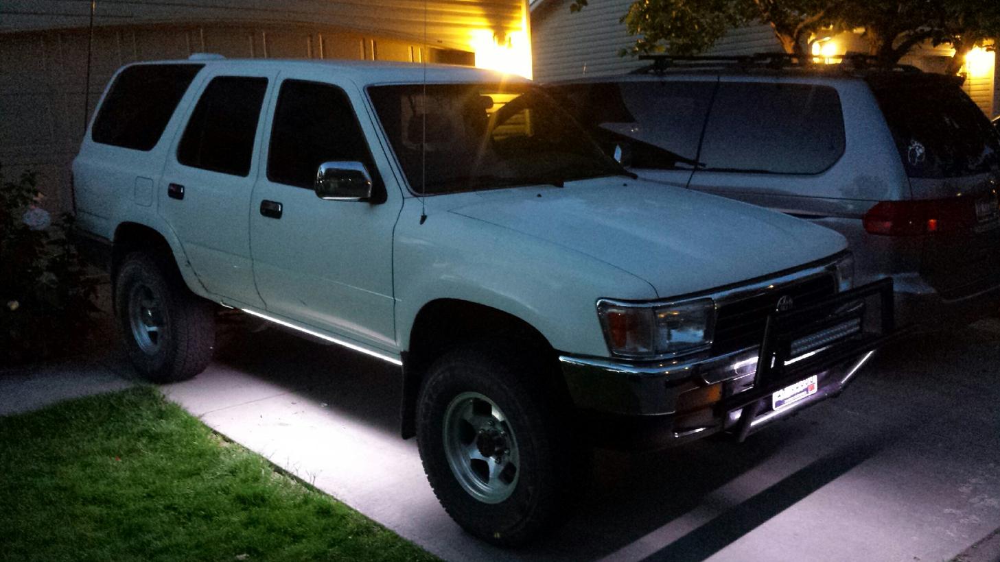

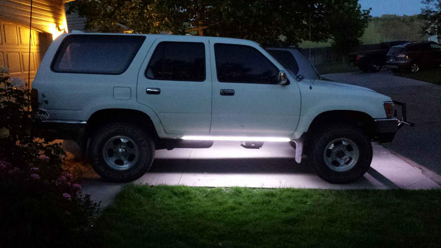

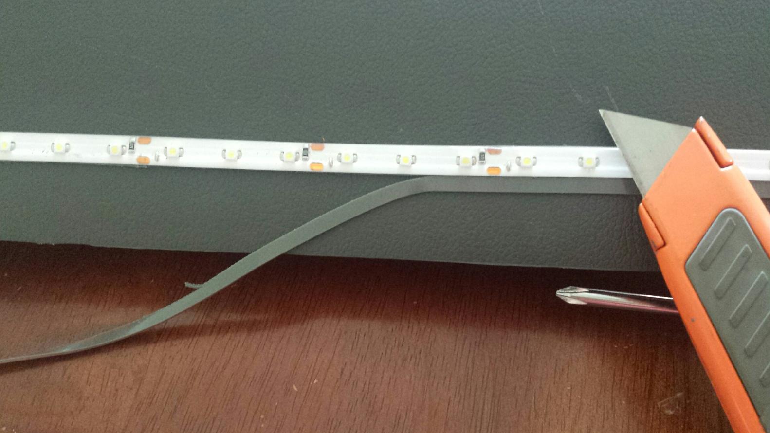

Threw together a quick mod last night. I say quick but it was about a 6beer job, took me all evening.
Months ago I bought a 16ft length of LED light wire off amazon for about $12. My plan was to install it inside the 4runner to beef up the interior lighting. I mocked it up and decided it looked like cheap limo lighting and didn't like it. So the Light wire went to the spare parts bin.
Another time last fall I was sitting alone at a bar having a couple beers and...what else... shopping amazon and I found this 12v 4 channel remote relay for around $30. I had no idea what I would use it for but i decided it was freaking sweet and had to have it. I ordered it and it promptly went to the parts shelf to collect dust.
Last night I was bored and wanted a project and really just wanted to finally see if this remote relay thing would work. I'v been reading a little bit about Rock lights on this Forum so i figured "Why not?"
I took out the glove box and mounted the Relay box to the underside of my passenger side dash. I ran the little antenna wire between the dash and windshield for maximum exposure and fair concealment. It is a 4 channel relay and I only needed 1 but I wired up the rest for future yet-to-be-determined requirements. I left 2ea wired into the glove box and ran 2 through the firewall. Then I wired 3 strips of the lights to the #1 power wire and mounted them with 3M double stick tape. The hardest part was soldering new wires to the light strips after I cut them to length, but I am pretty new to soldering.
Turned out ok. Its a little "Disco" for my taste but I think it will be useful for camping trips on moonless nights, we will see. I like the remote so I can find my bed in the back of the 4runner easily when I'm stumbling into the dark from the campfire.
All in all cost me <$40. If I get motivated I'll wire the last of the strip in the back for 4 sided coverage.

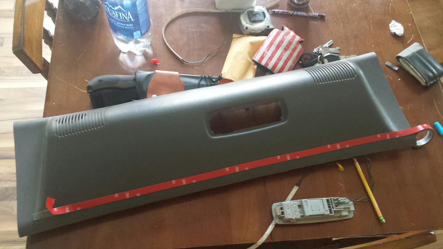

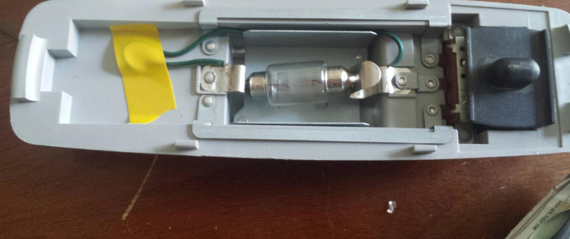

interior light enhancement.

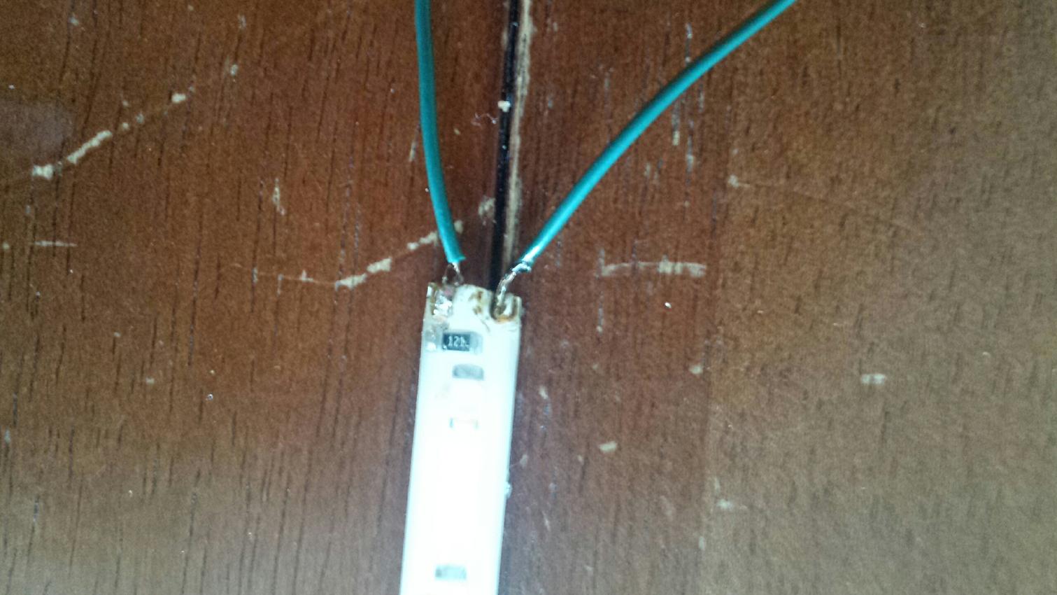

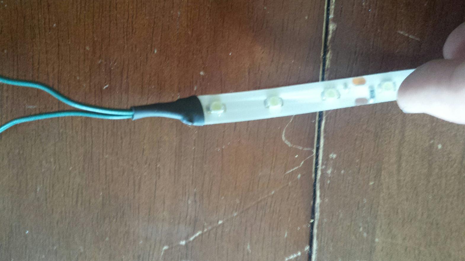

I ordered the stuff to wire in my inverter and while I was waiting for amazon to come through I had to tinker with something! I wired up some of the left over LED light wire I had to supplement the sad little dome light. I wired it into the switch so it comes on whenever the factory dome light would, either manually with the switch of when the tailgate is opened. As always... lots of pics.
i'm not very good at soldering but i'm getting better.
Freaking 3M tape is expensive!
Trim away the excess
Not too bad.

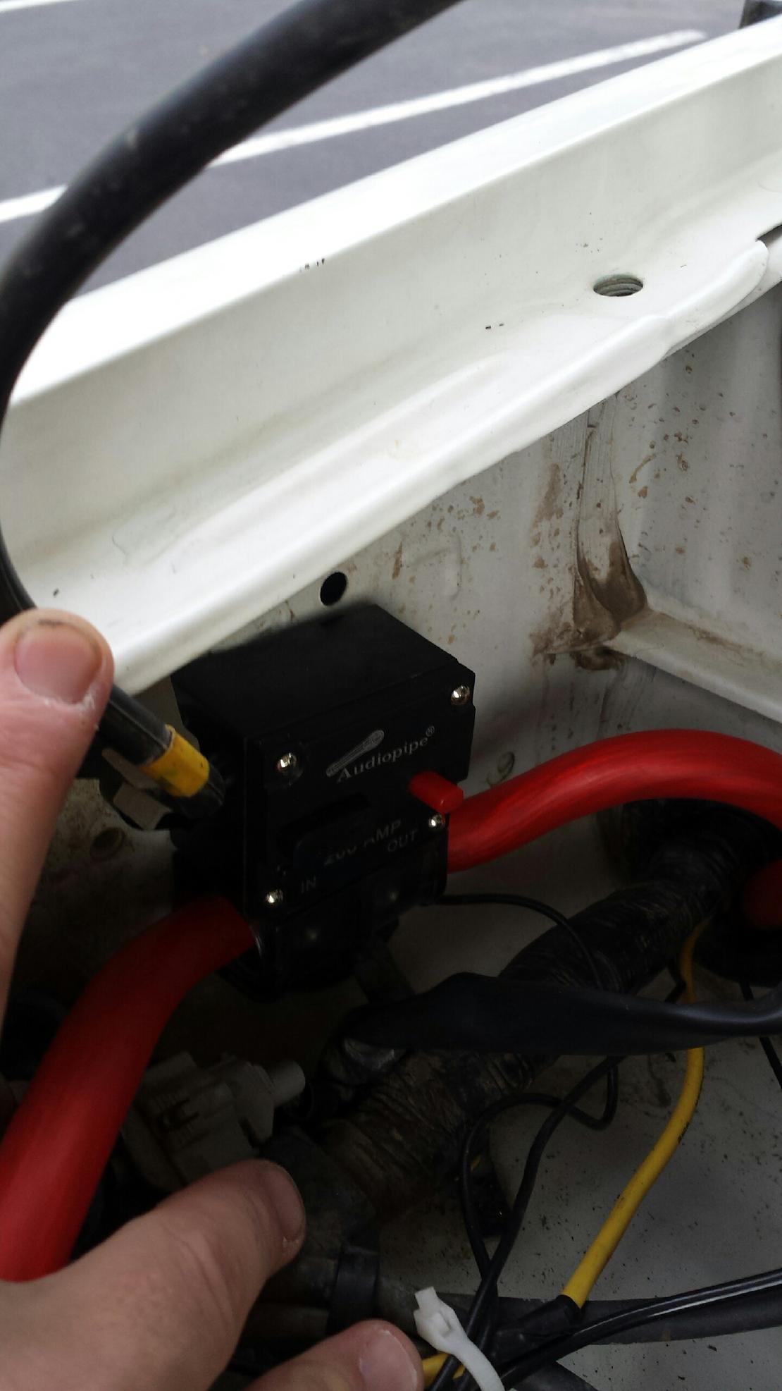

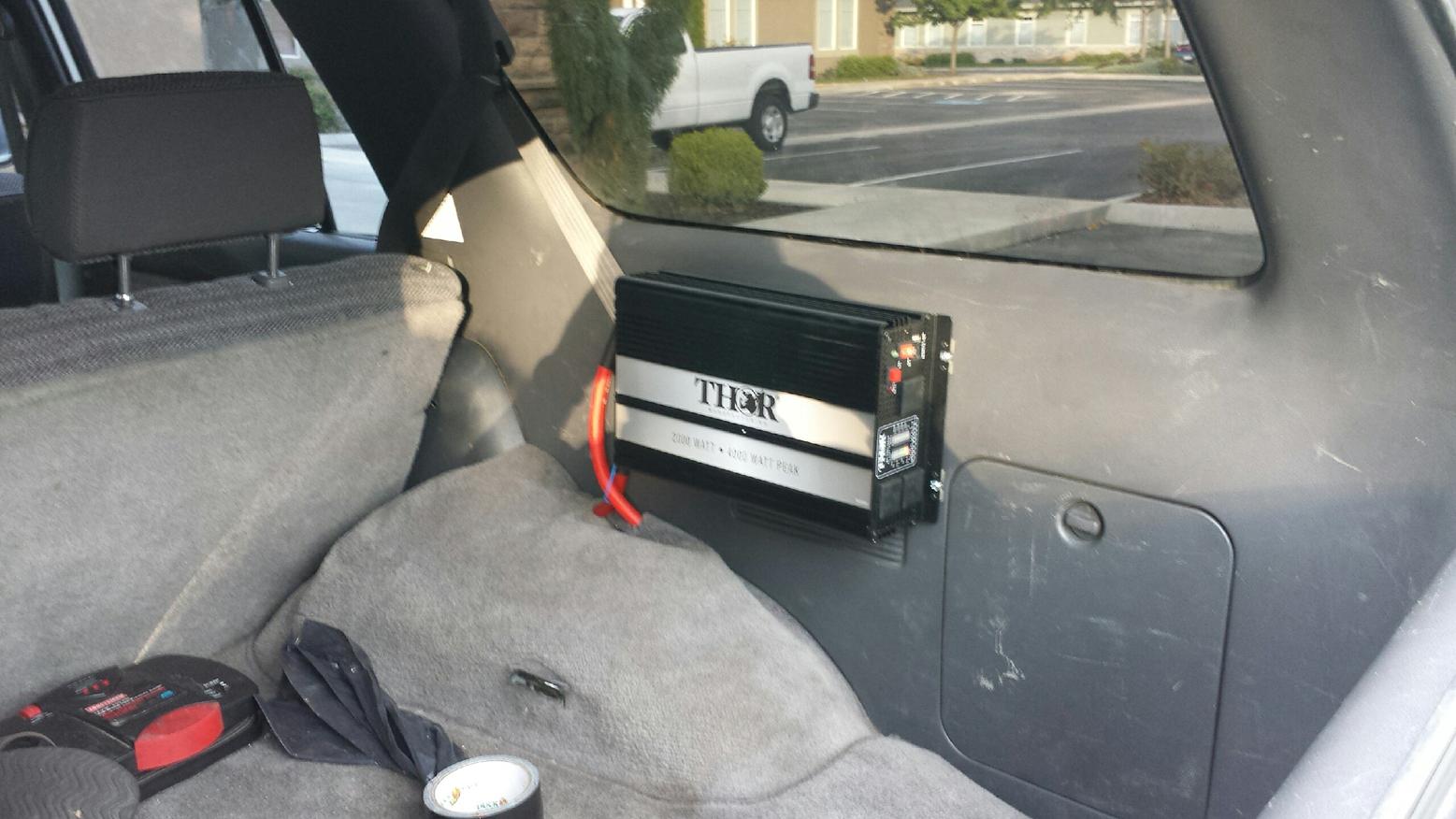

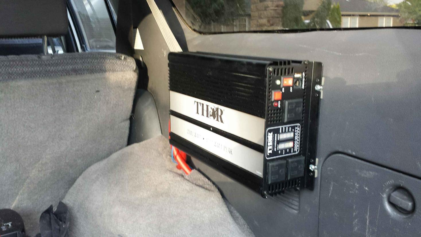

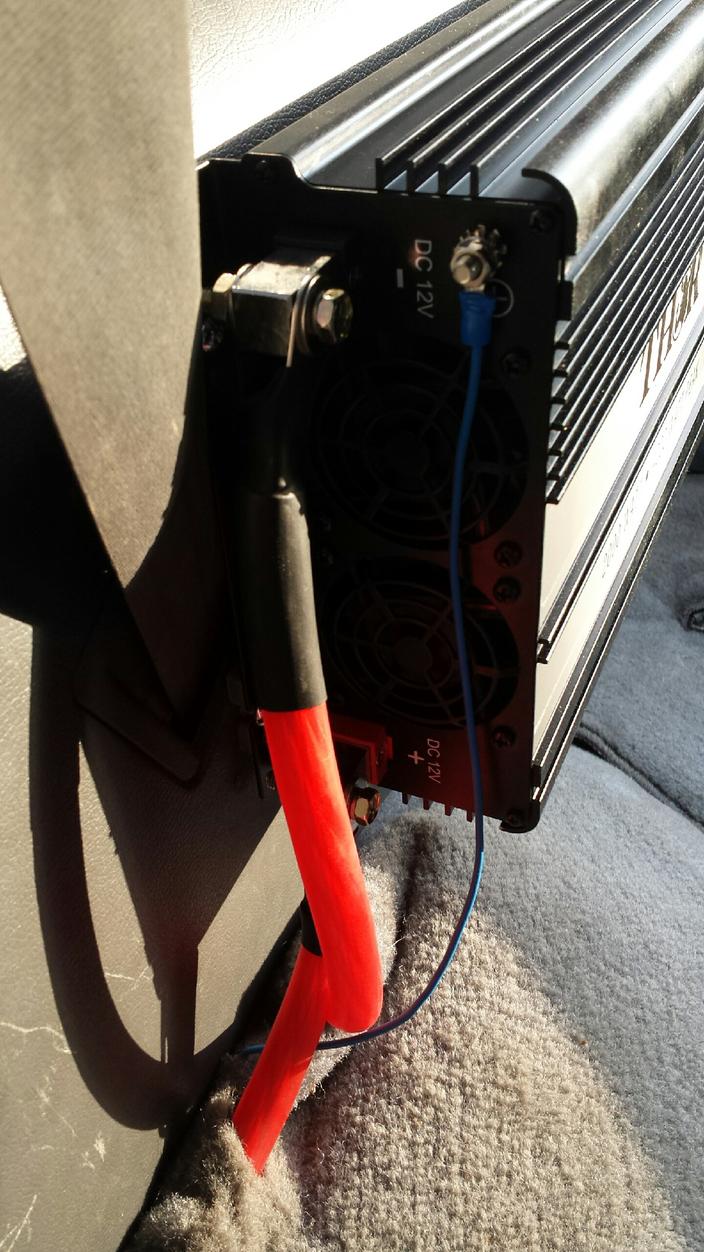

Inverter
I finally, finally got the inverter installed. As I stated in an earlier post. I bought this damn thing during a "black Monday" cyber sale for 50% off before doing any research. Honestly its stupid. I should have gone with maybe a 800W or 1200W. It would have left me many more install options simply because this thing is so BIG! After much him-hawing around I finally decided just to get it in there, wasn't doing any good on a shelf in the garage.
Ran 0/0 amplifier cable from the battery through a 200w 12v circuit breaker and then through the firewall and along the trim under the carpet next to my CB antenna cable. It was a big pain in the A$$ but with a fair amount of coxing and swearing the bulge from the cable isn't all that noticeable, until you get over the wheel well. I ran the negative cable strait down through the floor and bolted it to the frame. The unit itself is just attached to the wall paneling with some big washers on the back, not ideal, but honestly it's plenty stout.
This whole thing took me about 4 hours so I finished around 9pm last night and havent had a chance to play with it much. I will tell you that it ran a Dremel tool and cellphone charger(no surprises) fine but it wouldn't run the charger for my cordless tools or my heat gun. The heat gun says 1200W on the side so I don't know. I'm sure I lost a lot of performance mounting it so far away from the battery but I just didn't know where else to put it, i'm a rookie.
Anyway... here's the pictures.

I'm no electrical expert, but I don't know if the wattage on the side of the heat gun is accurate. When I got my inverter I read about how to calculate what I needed. I wanted to run the 4.5 amp grinder from harbor freight, so you multiply 110 (the volts) by the amps to get the watts. Check those specs and see what you get. Or perhaps mount it closer to the dash. I don't know how to calculate the loss, but I know my compressor sounds less powerful in the hatch as opposed to when I just clipped it straight to the battery.
All valid points. Ideally I would have mounted it closer. First choice was under the glove box but it just took up too much room. If it proves to be useless in the back then I may move it up there anyway... not like i need the leg room from the drivers seat. Thanks for the tip.

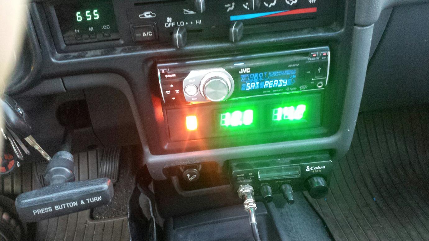

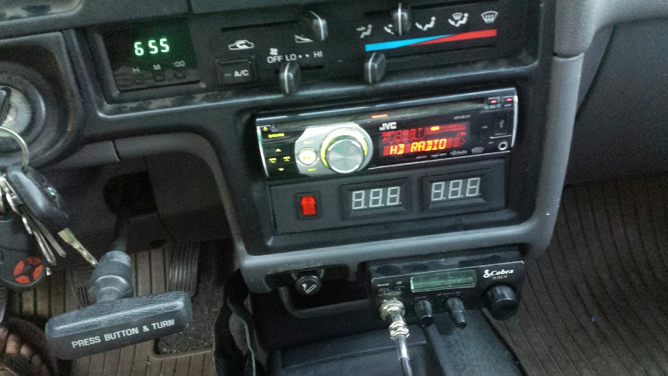

Voltage Meters

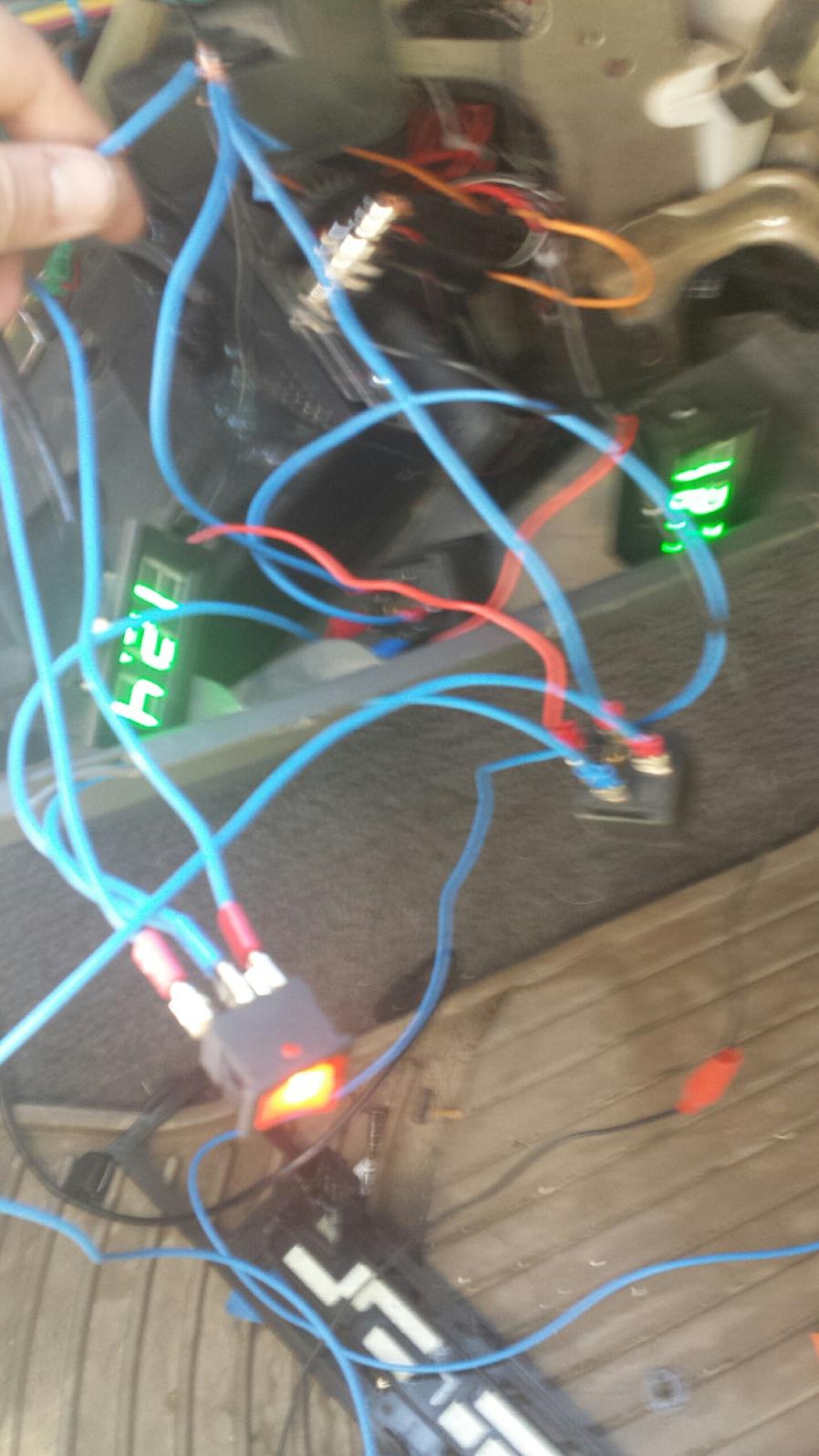

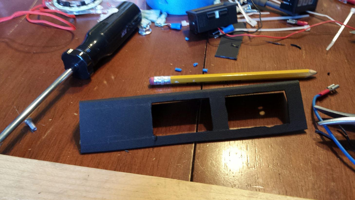

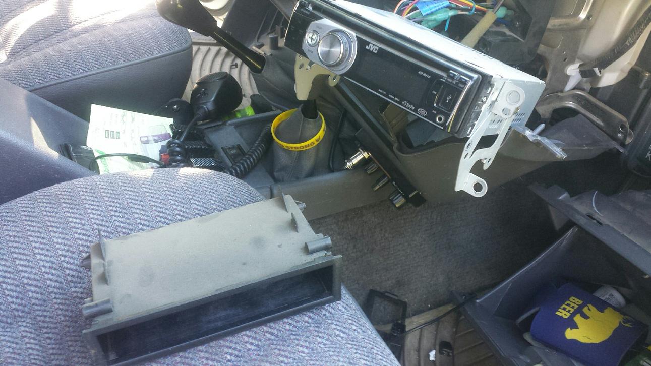

I thought it would be nice to have a couple voltage meters on my dash(besides the stock one) to monitor my 2 batteries. I ordered 2 LED 12v voltage meters in green, to match-ish the rest of the dash, from Amazon.
First I pulled apart the whole dash to get at the little cubby under my stereo I thought this would make a good place to mount up the little screens.

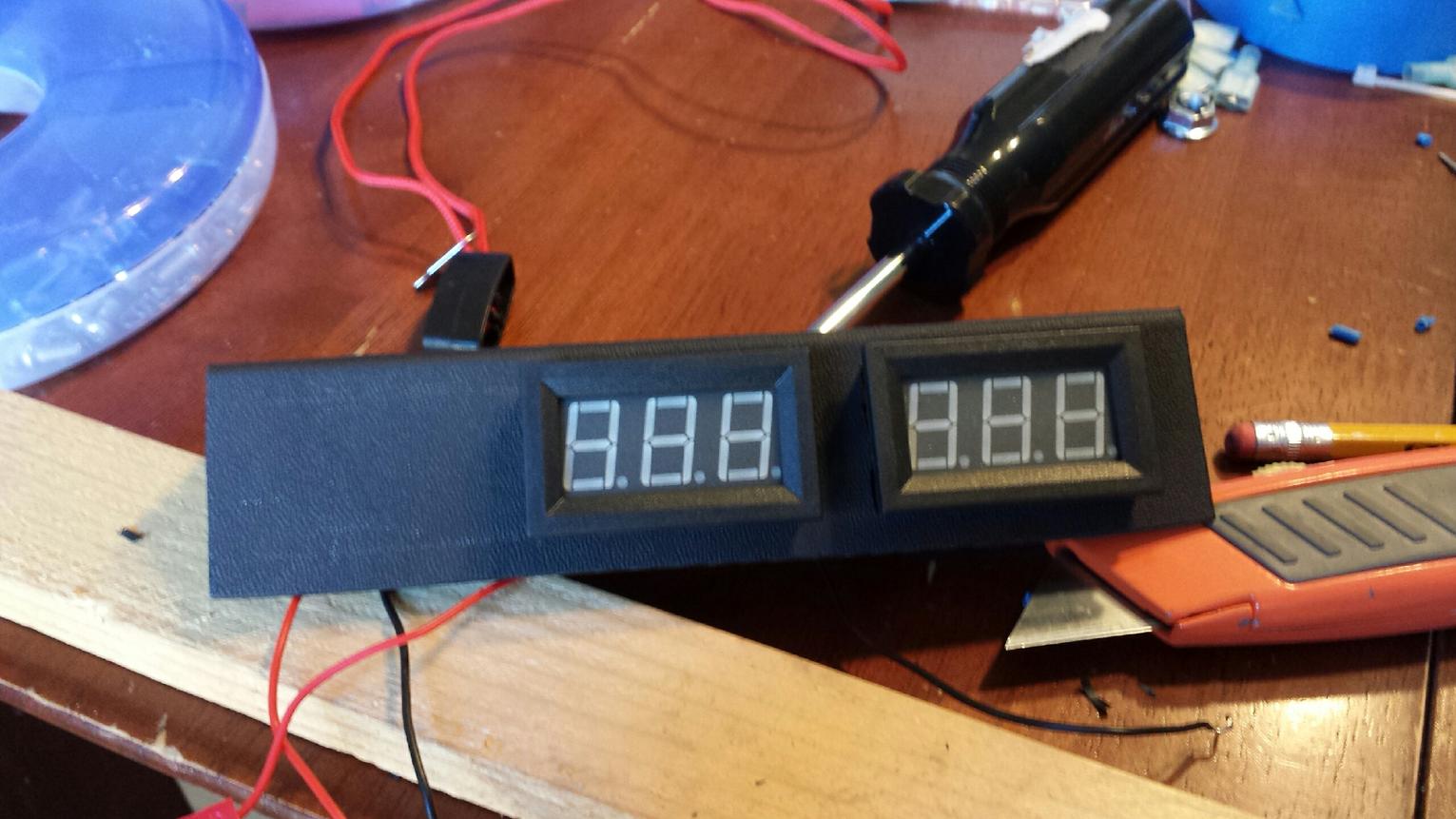

Next I wired up the screens for a test. I used 1 switch and 2 relays to keep the circuits separate. I drew power for the switch from my constant on stereo wire. Under the hood I hooked leads to each side of the 200amp solenoid that separates my batteries. Those leads ran in to their corresponding relays and then from the relay to the corresponding LED meter.
Here is every thing wired up for the test. Sorry its a little blurry.
Once I was satisfied that was all working I went to work on a little kydex panel to try and make it look presentable.
I cut a rectangle of Kydex and trimmed it to the shape I needed then used a heat gun, the edge of the table and a book to bend a strait 90* angle. Then with some measuring and marking I drew out a template to cut up the holes for the screens and switch. rough cut with the Dremel and trimmed with a utility knife.
I wish I had gotten a picture of this next part... I guess i was caught up in working on it. But next I took the Dremel and cut out a section of the back of the cubby. I mounted both relays inside and to the back of the cubby. Then the front panel I made bolted to the top inside of the cubby via the 90* tab. Once all the wires were connected inside the cubby the whole thing was one unit ready to hook up and mount in place.
Here is the final product.
Here is is on. This picture makes it seem way brighter than it is, but it is quite bright.
All in all I'm happy. However, I figured that with the ignition on, car running(solenoid closed) both batteries would show the same voltage and with the ignition off both batteries would show slightly different voltages since they were no longer connected. The result is precisely the opposite. With the car running the primary battery reads ~14v and the aux ~12.3-12.7v. When I shut the car off they both slowly return to 12.3v. I need to play with it a little more to convince myself it is working properly. More reason to tinker i guess.

You can check with a volt meter, but the 14 volts you are seeing maybe what's coming from the alternator.
:rockon:
:rockon:
the switch wire for my solenoid had come loose and was intermittently engaging/disengaging the solenoid. That accounts for the bizarre readings. The system diagnosed a problem right from the get go haha!
*edit*
fixed loose wire... intermittent problem persisted. Trouble shooting with the multi meter narrowed it down to the solenoid thats supposed to connect the batteries. So yeah I need a new one of those now....
