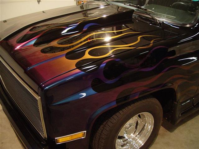

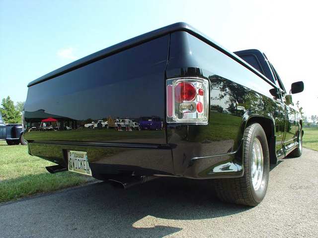

If you look at my avatar, that flame paint job took me about eighty hours of wet sanding and buffing to get it that smooth. I use 3M products to buff with, a 9" wool buffing pad and a couple of Makita rotary buffers to do the work with.
