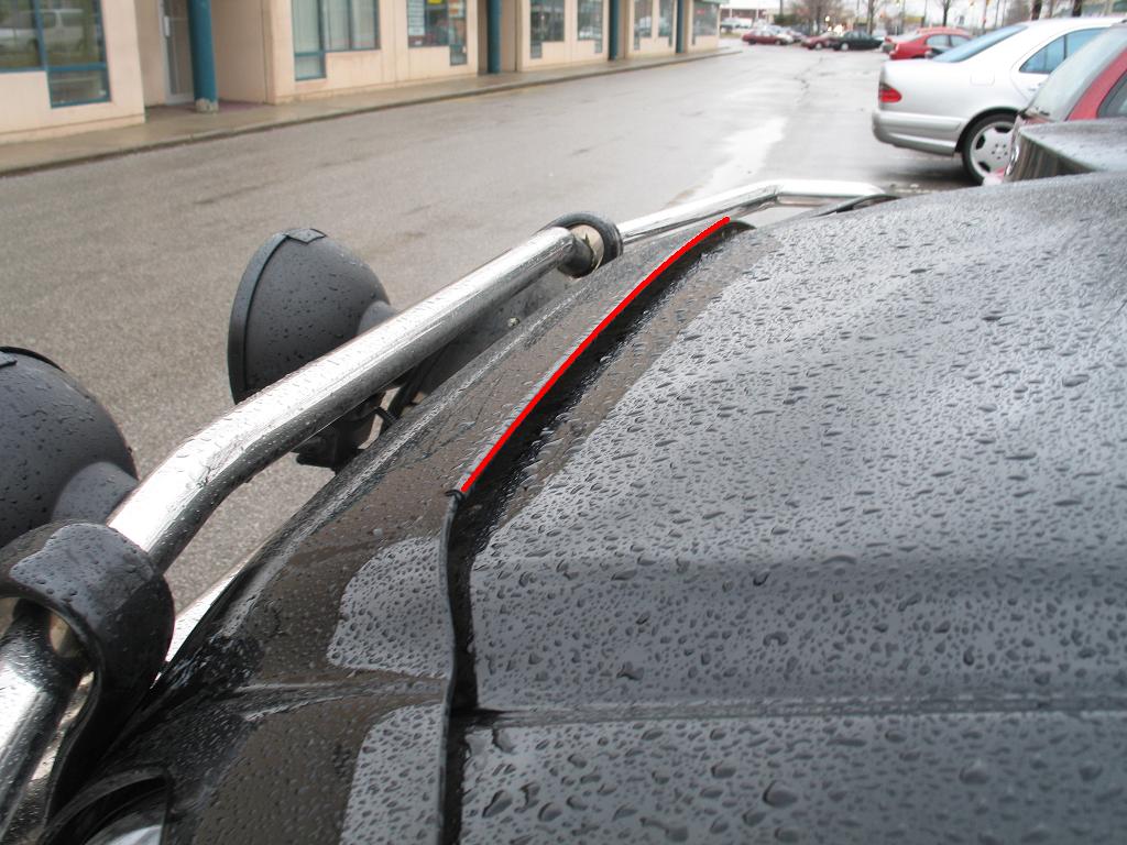

I put the door edge guard on top edge of the deflector and no noise more. I used black one, it looks better then transparent.

As I was promising, here is the picture.
My 4Runner is black, dark smoke Hood Deflector and black Door Edge Guard, so I highline the edge with Door Edge Guard with a red line.

thanx for the pics
AlexJet, did you pick up the door edge guard at a specific auto store, or do all carry it?

I got it from Canadian Tire. I think in Sates you can get it in any good parts store, Partsnet, Napa should have them.

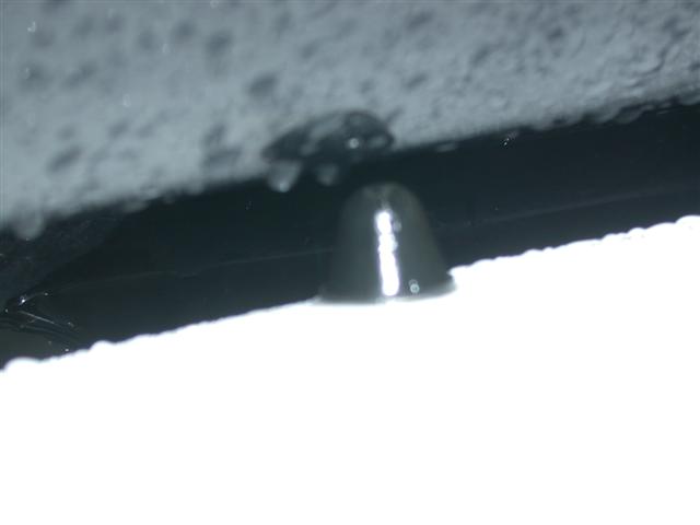

i know you might have fixed it just thought you might want another idea. Look at the 3rd gen have you tried a smaller rubber nipple thing?
