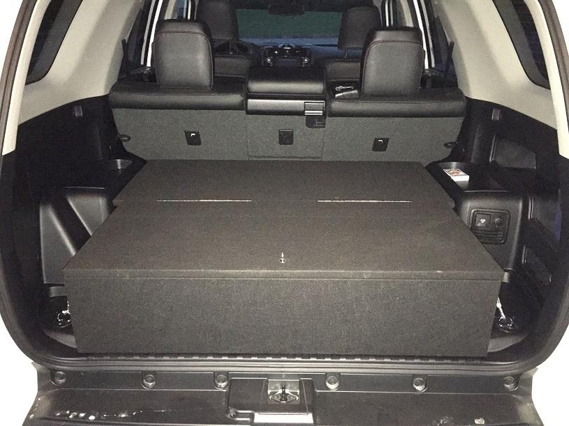

OK...that's probably more than enough titillation for such a mundane topic...so here's my finished (mostly) product. I took a few shortcuts at the end...mostly because I needed to get this monstrosity out of the garage tonight to make room for my car...and partly because I just wanted to see how it fit.

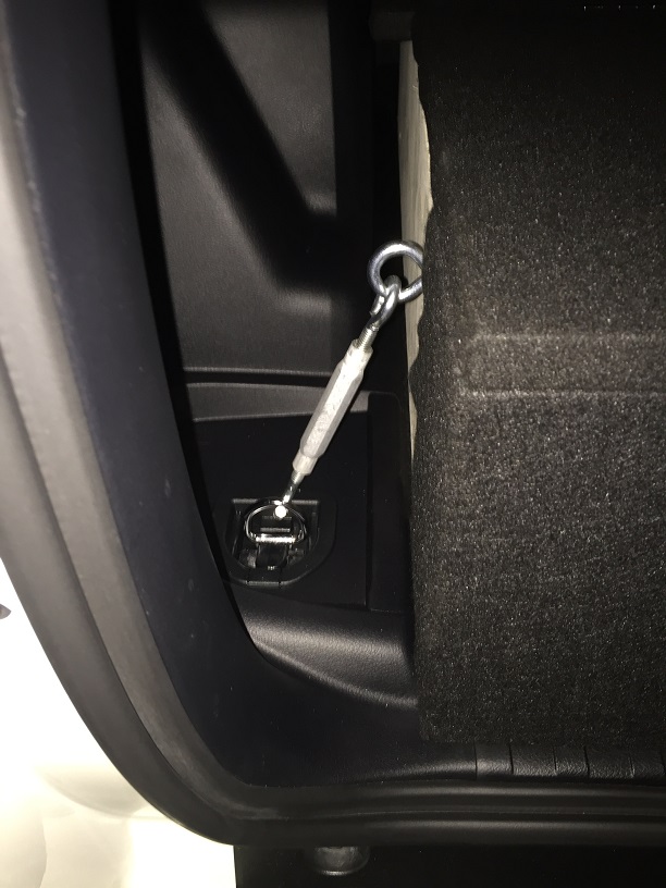

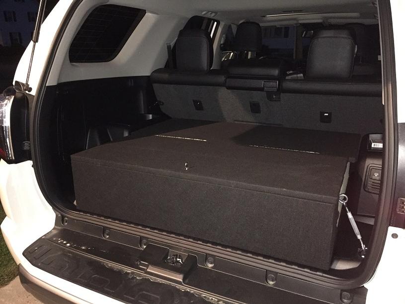

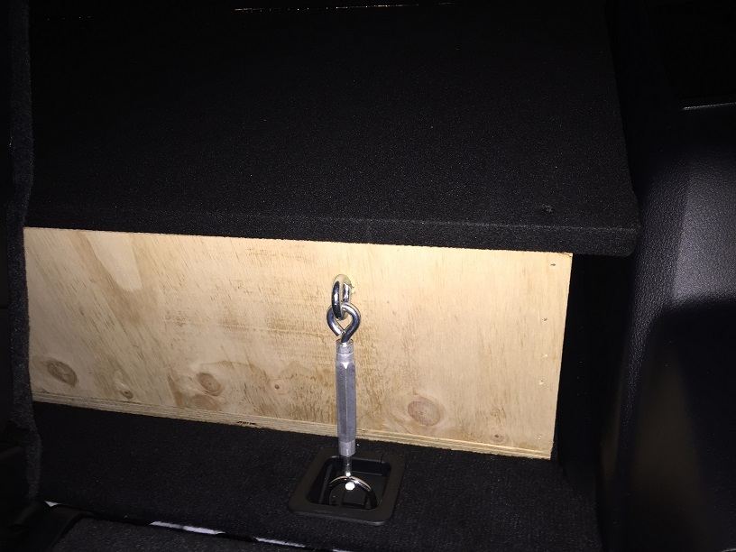

To secure the box to the 4Runner, I installed turnbuckles at all 4 corners. I'm certain that it will keep the box from bouncing under normal circumstances, but I can't be sure how it will handle in a rollover. I hope I never find out.
Here's where I got lazy at the end of the day. I opted not to upholster the sides or front of the box. I'm not proud of this decision...and I may go back and do it right later...but it was getting late and I was ready to quit for the day.

Turnbuckles at the front of the box take advantage of the hooks just behind the passenger seats. They seem secure.

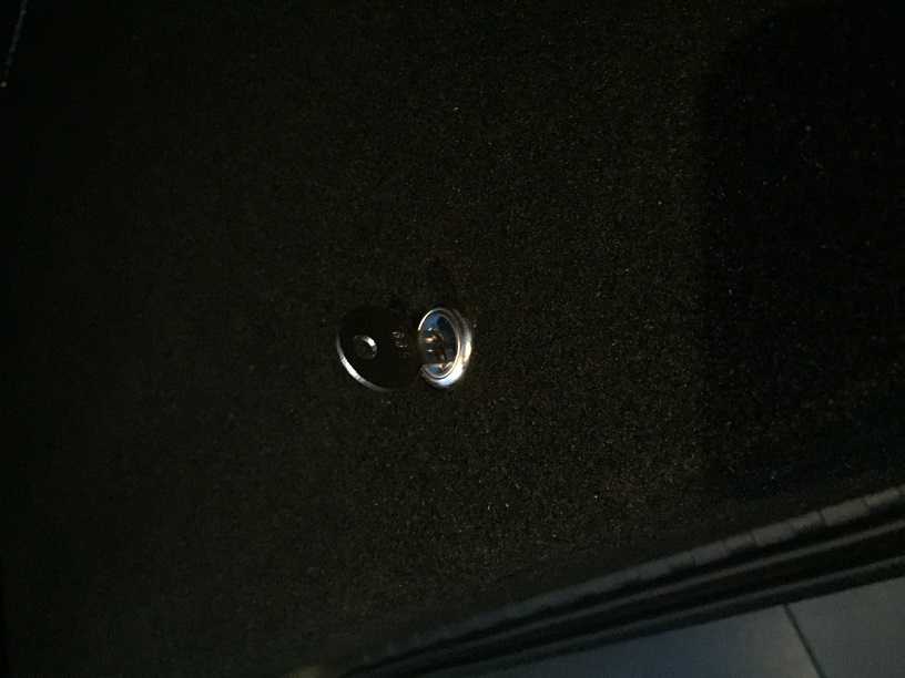

No lock is impenetrable, and this simple barrel lock is not exactly robust, but it cinches the lid down tight when locked and it won't rattle like a hasp and padlock would. It also won't scratch up the plastic panel on the inside of the rear hatch.

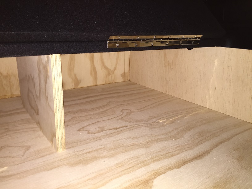

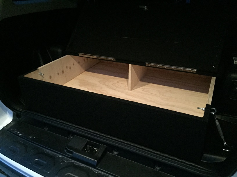

Inside...I have 6.5 cubic feet of locked storage...I went with piano hinges for strength and added a spacer to support the center of the lid.

I considered carpeting the inside of the box, but I suspect that the tools and hard objects stored within will wear through the felt just from normal vibration. I do, however, have a roll of rubber for lining tool box drawers that I might try out.

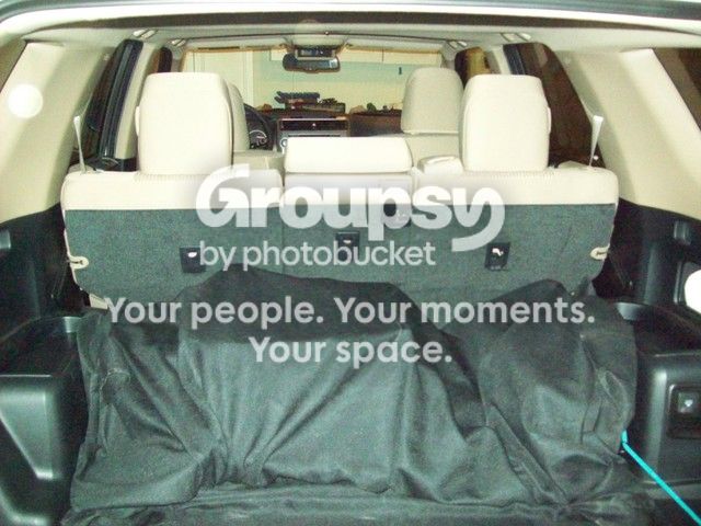

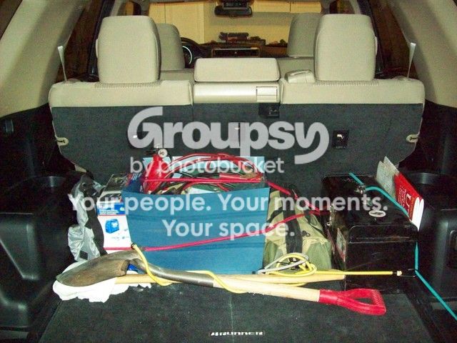

I like it! I've been carrying my stuff around like this over the years:
BUGOUT1_zpsrwghld6e.jpg~original
Just lashed down
BUGOUT2_zpsb1jusxjg.jpg~original
- and then covered with a sheet.
