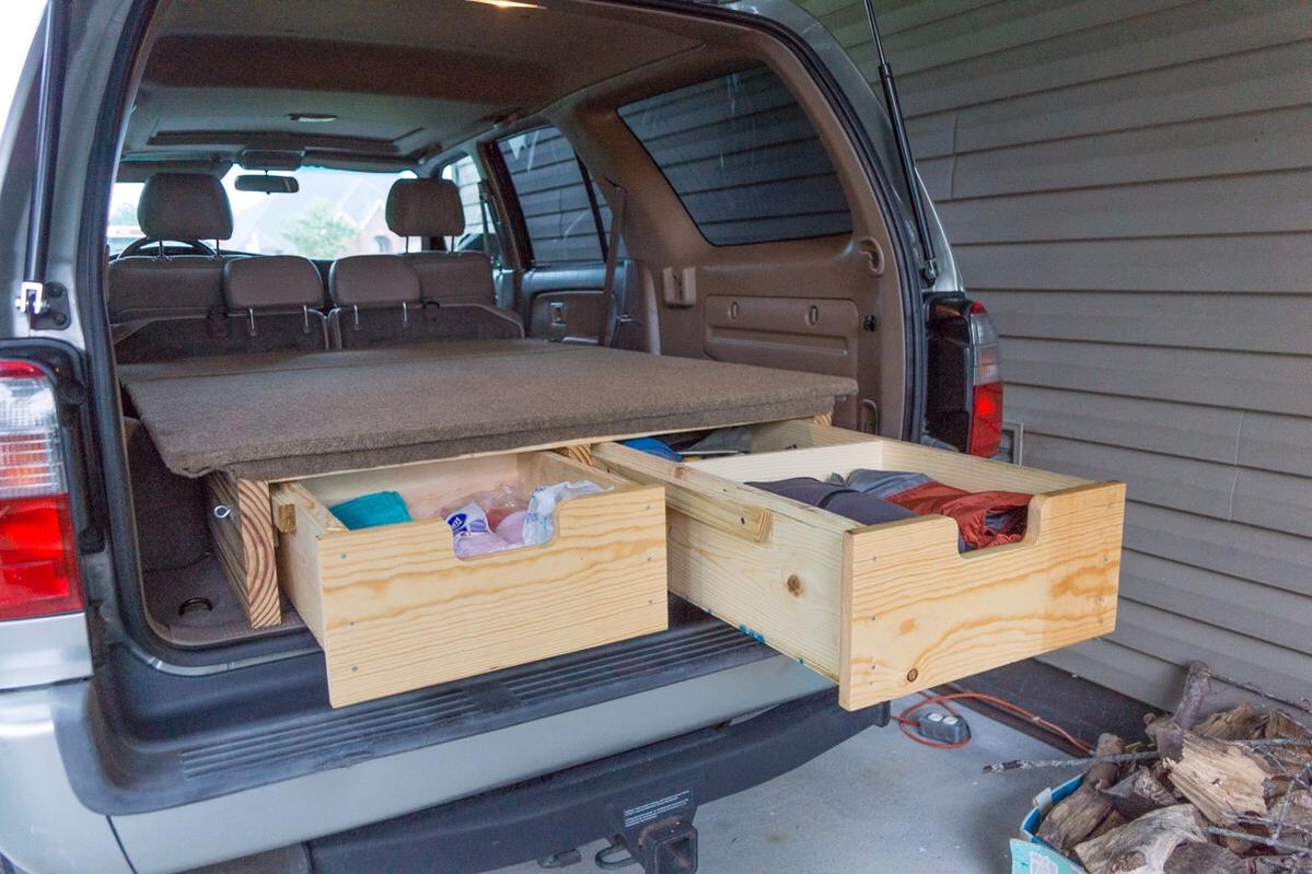

Very cool offroad vehicle. I'm running my '99 Limited as factory but put this interior camper mod together for a quick swap from street to trail.
It completely outfitted with a mattress, lighting, camp site canopy, table and even some magnetic bug screens for the rear windows and liftgate window.
The whole thing slides in and out in just a few minutes. Enough for a single person...
