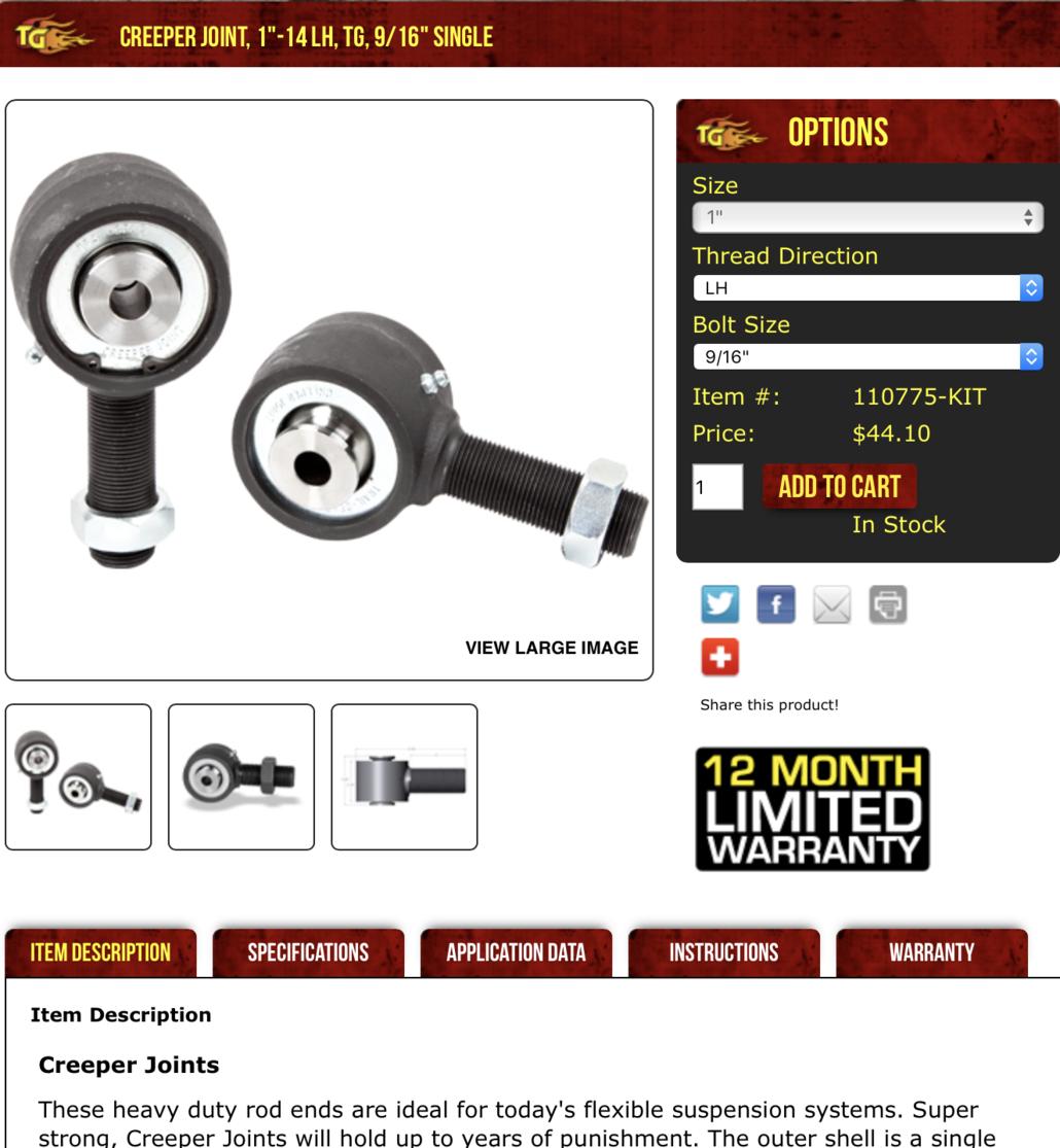

want to weld on a drop bracket but until then.....
i want to build my own rear pan hard with these joints....
can anyone chime in on their opinion of these for this pan hard bar application..
BTW, does anyone know why TOYTEC uses a HEIM and not some kind of joint?....

Do you plan on running those on both ends, or just one end? You may run into some clearance issues on the axle side. With the Summit Machine one's that I've used I've had to "massage" the opening a bit to stop it from rubbing. Those are pretty flat across the back though, and the Summit Machine are rounded. Are there any more specs on them?
The 19mm will work for your lowers, but the uppers and pan hard are both 12mm.
