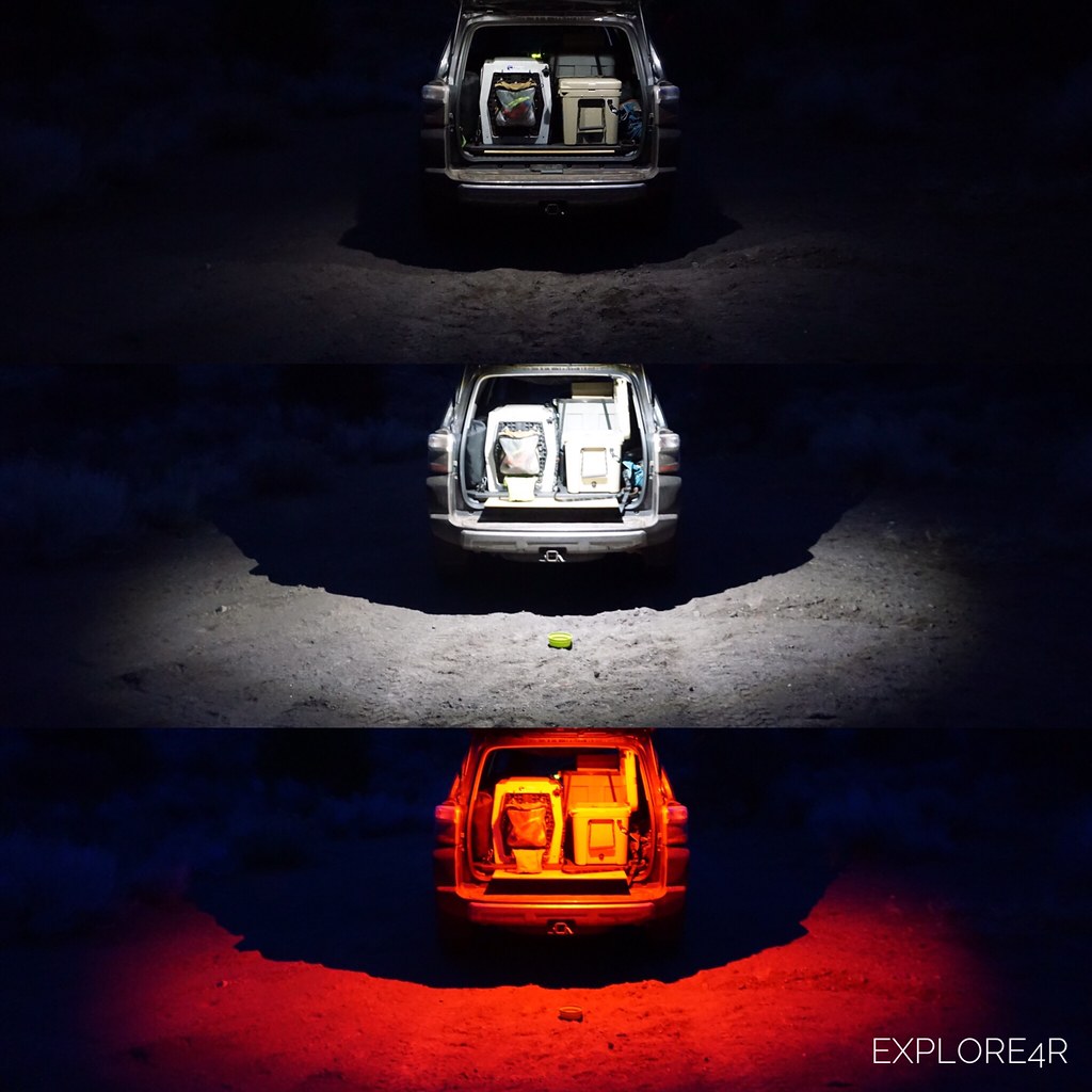

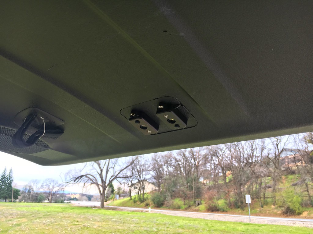

Baja Designs Hatch Dome Light(s) Installation

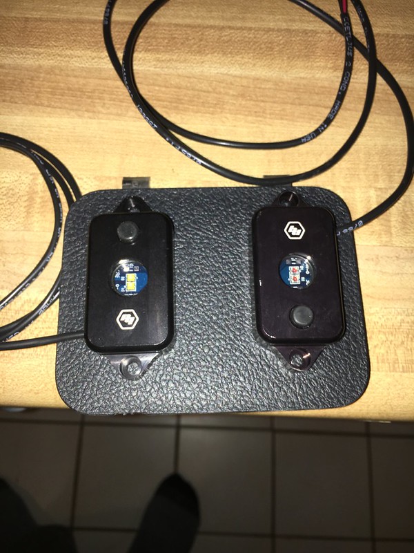

As many know, the stock hatch lights on the 5th gen 4Runners are terrible for anyone that uses their rig for anything other than day to day. They light up directly below the hatch, but hardly anything inside the cargo area, and they don’t throw any light to the surrounding areas. From experience, they work ok for day to day “gotta grab the milk before it falls out the back” scenarios, but they fall short on anything requiring a good amount of light (camping, cooking, working, etc). I tried upgrading the bulbs to a brighter LED Philips and to their credit, they are brighter. But not bright enough. Plus they turn off after 20 minutes, which sucks when you’re mid way through pouring a cocktail. SO to the aftermarket I went, and I landed on the Baja Designs Dome light (w/ switch). Low draw, high output, built in switch. Check, check, and check. I decided that I wanted a white and a red light on the hatch. White for cooking and high visibility situations; Red for situations when I don’t want to have a bright white light ruining night vision but I still need to see where I am stumbling going after hanging out around the campfire.
White Baja Designs Dome Light
Red Baja Designs Dome Light
The Install:
I attached the lights to the small plastic access panel on the hatch. This way if I wanted to change things, I can replace the small (cheaper) piece instead of the whole plastic panel, speakers and all. Cheaper is better. Using the supplied cap screws and nuts, I lined the 2 lights up to my liking and drilled 2 holes each with a step drill to get a smooth hole. I then made a notch per light on the outer edge of the panel to route the wire inside the hatch. Each wire has a positive and negative wire inside which I routed to a pre-wired positive (to battery) and negative (to hatch ground) connection I already had in the hatch from my S2 installation. Some shrink wrap connectors, dielectric grease, shrink wrap, and zip ties cleaned everything up and provided a solid connection. Here are some of the results!
Laid out for alignment
Installed!
Stock vs. White LED vs. Red LED (same camera settings for an accurate comparison)
Overall I am very happy with the product quality and the light output! Problem solved!

I am going to use that small piece of plastic to do the hatch release from the inside but I may have to add the red light for night vision purposes as well now... LOL :biggrin2: I love that your MODs are in line with my needs. I love the S2 setup in the hand hold and now this one! I may end up wiring up one of the white lights to my existing LED strip in the hood. As always, thanks for sharing and inspiring! :cheers:

I would say problem solved. Wow that is some great output. Nice job!
Do it. All of it! Trust me, when you spend time camping in VERY dark places, having light is a great thing. Especially where you need it. I try to be practical with my Mod's, taking notes of where to improve over the course of many nights camping. I try to get what I need, and not much more. Wallet stays happier that way :thumb3: Glad to help!
It's pretty killer. Definitely have enough cooking light back there now!
