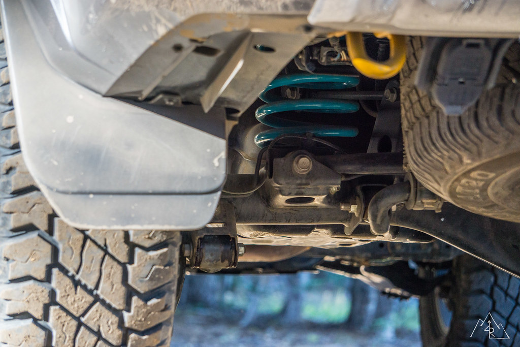

What do these do for you- - Metal Tech 4x4 Offset lower links

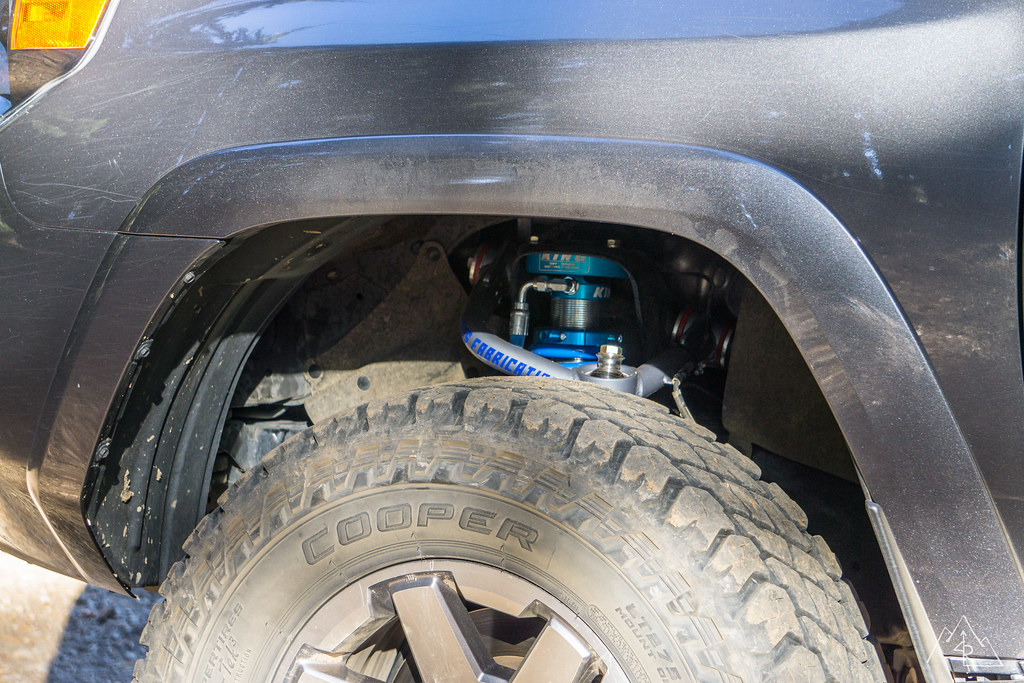

I clicked on the link in Max's post and found the following information:
So it looks like they're designed to allow more articulation for the rear axle.
Hmmnnn, maybe I need a set . . . :eyebrows:
I highly recommend them, they're awesome.
They are adjustable lower links that can be tuned to match the flex of an extended travel suspension system. Their main benefit is that they are MUCH stronger than the OEM links that can bend with one well placed rock and put you out of commission. I have them adjusted to the "stock" position and they work perfectly for my application. Good insurance on the trail as they tend to be low hanging fruit for damage. One comment I will make is that their zerk fittings are a PITA to get to. I would highly recommend swapping the provided fittings for 90º nipples, you'll save yourself a bunch of headache. I attempted greasing them last night and couldn't get the job done, so I am trying another grease gun fitting designed for tight spaces. I'll swap them to 90º nipples next time they come off the rig.
Hey Max, Happy New Year. Were you able to successfully grease your MT4x4 links without taking them off the truck? I just received my offset links and asked the folks at MetalTech about swapping the zerk fittings for 90 degrees, to which they replied they do not recommend the 90 degree zerk because of it being a compression type fit that may make the zerk face the wrong way when fully installed. Just wanted to see if they are greasable with the straight zerks or if it'd be worth giving an angled zerk a go.
Hey! I was BARELY able to grease the axle side... On one side... So I am trying another method before swapping zerk fittings. I will be trying out this guy:
Slide-On Straight Grease Fitting
A bit of a design flaw if you ask me, but it is what it is. I'll let you know what happens.

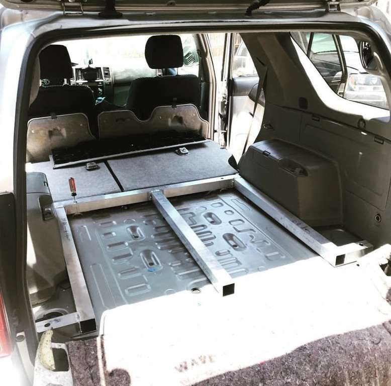

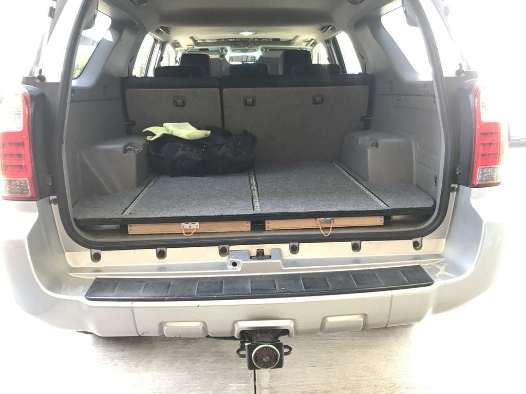

Normally, this might be a thread-jack, but since MTN4RNR's platform was the inspiration for mine (thanks Max!) and I did basically what you're talking about . . .

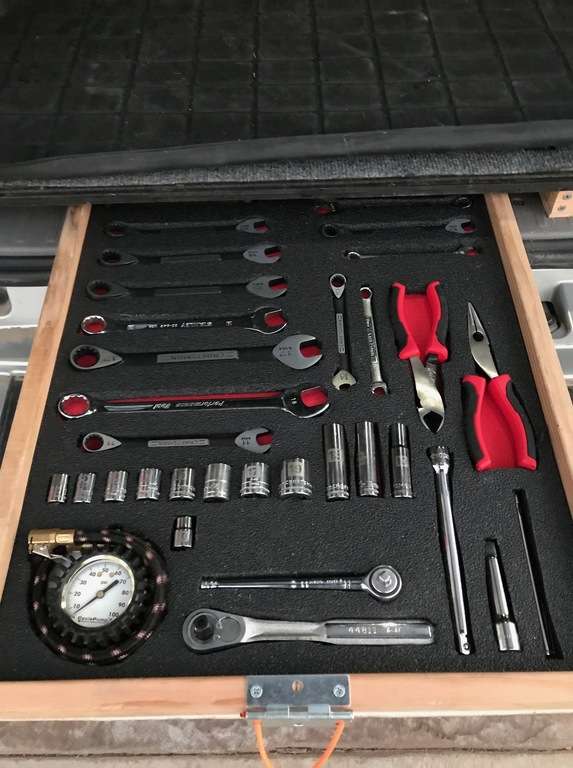

I built a frame out of 2" boxed aluminum and then anchored it to the factory tie-down points. It's very strong. I went with the boxed aluminum since I wanted to have 2" tall drawers which I use for tools and spares, rather than slides like Max. My drawers just slide on the carpet and work great. You could easily build a similar frame out of 3/4" aluminum which would probably be strong enough to hold a slide that you could sit on like a tail gate. I also built a second half to the platform which gives me a sleeping platform when the back seats are folded down.
Here are a few of the many pictures I have to give you an idea what I'm talking about. PM me if you have any questions...
