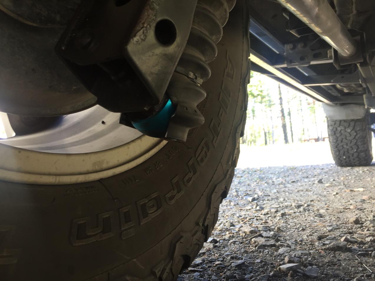

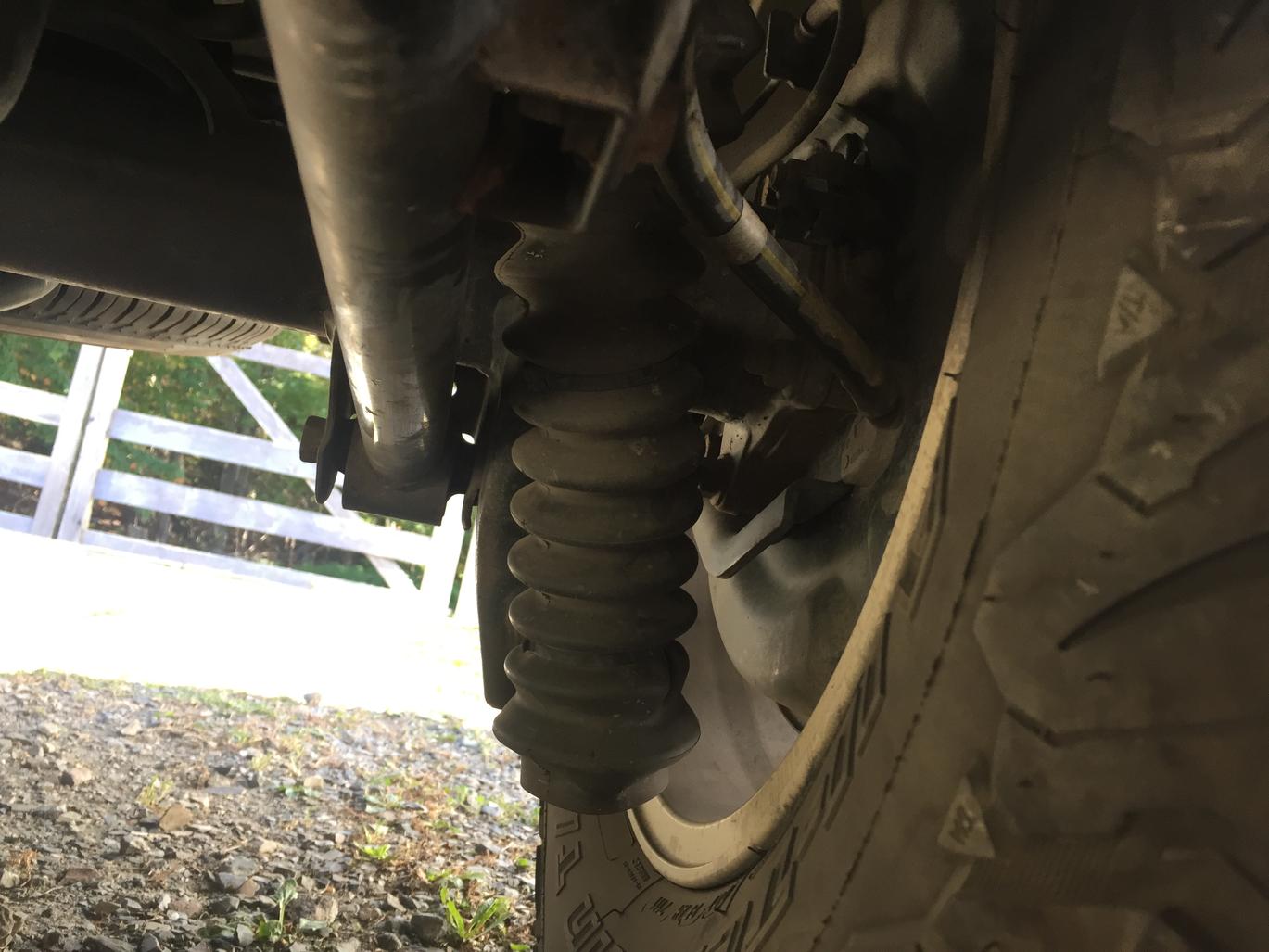

[MENTION=129593]MTN4RNR[/MENTION], if I might make a suggestion, put some boots on those rear shock shafts.
I pitted mine badly in one awesome summer, and had to replace the shafts. I wound up buying a second set so that I could work on them when I had time.
I now have the boots pulled down so that they cover the bottom spherical bearing. In my experience, this is the first issue you will have with these awesome shocks; the lower spherical bearing on the rears takes a serious beating from regular gravel / salt / sand
The boots in the photo are cut lengthwise, and zip-tied top and bottom. They can be inspected easily from the back, and the split allows moisture to dry out (and easy installation). $10 boots. procomp from the offroad walmart.
I didn't mean to derail your thread-- I'm just hoping a bit of prevention can save you the headache I had.

That’s a great suggestion, and something I have heard from others as well. Why King doesn’t provide a boot option is beyond me, especially with low hanging fruit like that. I’m looking into a couple of “shaft shield” options first to see if there is one that will work well. BPF just came out with one that protects the lower joint and the first few inches of the shaft. But the boot might be cheap insurance for any type of a desert trip where they can get chewed up rather quickly. I’ll post back with what I end up doing :thumb3:

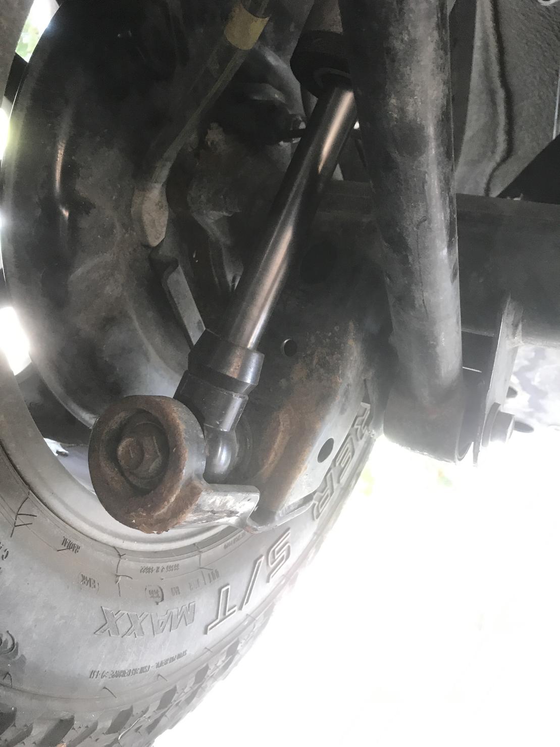

A good investment is the FJ Toyman lower shock guards. But this won't prevent against sand/gravel blasting, it's more important to prevent the attachment point from being damaged by a rock.
Why the ICON style guards is less than optimal is that those are known to be bent backwards, which can then impact against the bottom of the shock body.
No free lunch on these things.

As an aside to the exposed rear lower shocks, I recommend using anti-seize on those lower shock bolts, they'll corrode faster than just about anything else from my experience. May not show up for 100k miles but they can get pretty gnarly.

FJ Toyman are good insurance. Here are mine after just 5k, kind of opens your eyes to the abuse down there. I need to hit this with some paint, it's too bad mud flaps have fallen out of vogue.

Definitely noted on the anti-seize. Last think I want to do it hack frozen bolts.
These are on my list, as well as ABS guards after talking with [MENTION=124732]LawnDart[/MENTION] more about his experiences with the two. I secretly want to figure out a "rock flap" that could work on the 4R but that's just another silly project.
